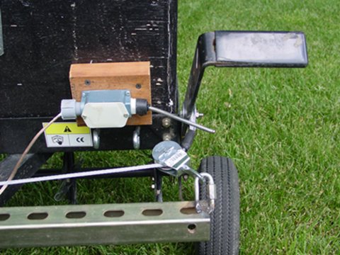

Received the limit switch from China:( It is a woble stick with a spring actuator. The hole for the wires is metric so I so I ground down the threads of a 1/2 inch fitting and forced it in. I then put calking around the wires where they enter the switch hole to seal out moisture. The woble stick design allows toggling the switch with movement in any direction. Worked fine. Was worth the $7. Picture below.

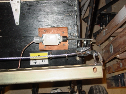

Made a better video and picture of the limit switch in action.
Video - [video]http://home.roadrunner.com/~rblapham/Aerator2.wmv [/video]
