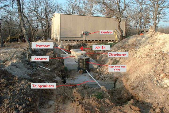

I had my aerobic system installed in 2001 at a cost of $6500 including the county fee and the engineering report. Here is a picture on the day it was installed before the backfill. It was two years after this picture that I built my house. In the meantime, the septic system was more expensive than that little building I lived in.:)
My system has been trouble free except for a timer that was supposed to turn the aerater motor on for 30 min and off for 30 min. When it went out, I just wired it to run all the time and it has worked fine ever since. It the motor goes out, I can buy another one for $500 to $600. So far, the bearings sound fine and the motor just runs and runs.
