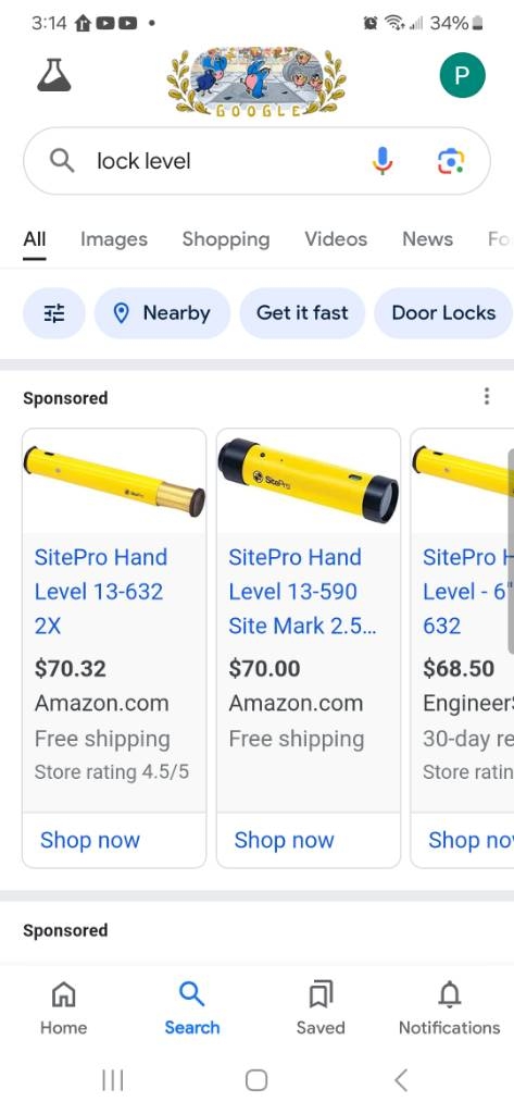

What level of accuracy are you needing? Plus or minus a 0.10 ft (1.25" appox), over a 100 ft is pretty doable with a Lock-Level ($70 on Amazon), and they are small, fit in a pocket, no tripod needed, just use a probe rod or similar firm rest.

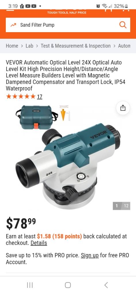

I do see a Vevor builders level for like $85, but you would need the tripod. I know Vevor isn't know for being amazing; but all we need is a scope with a cross hair and a bubble level for what you need. You also will need a grade rod, or reasonable facsimile, like a hand tamp with a piece of bright colored electric tape. Heck, you can screw a yard stick to it for precision.

So, Mike, you said Transit, but for what you are doing, you only need a Builders Level. Transits can angle up and down, and you can do the trigonometry to do real survey, accurate to the 0.01 ft. A builders level, and a 100 ft cloth tape (for better yet, a 300 ft steel tape), can do a whole lot, as long as you don't need to calculate angles. I have personally (with my helper) laid out a 8000 sq ft commercial building expansion with nothing more than a known bench mark, a builders level, and a 300 ft tape. We ended up with 0.25 Inches of proposed finished floor elevation, which is well within the tolerance of the concrete finish.
A Lock Level is a more primitive tool, and is good for quick and dirty stuff; a builders laser level is certainly better, but for the cost of a new one (Home Depot rents them, but think it's $100/day?), I don't think you need that.

The Use By myself part; you Do Not want a proper transit for that; and from what I'm reading into this; you really only need to "Level" this to what we call earthworks tolerances; plus or minus a tenth is fine; once you're ready to build the shop, you will shoot the forms and do fine grading to the forms and strings. A Lock Level is the way I would go, or a laser. Just know you don't want the visual style; they are Cheap, and are a pain in the butt; you would want the style with the recievwr that beeps.
