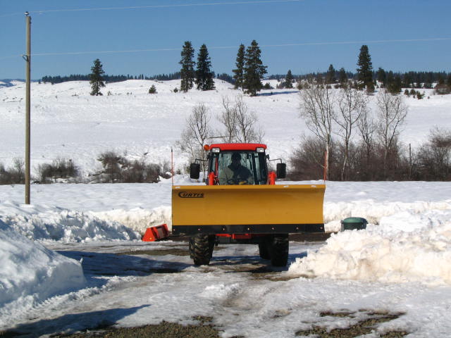

Hiya,
Curtis snowplow company makes loadermount plows with JD or skid steer quickattach mounting. I have one of their setups, very high quality and no issues for going on 5 years.
Tom

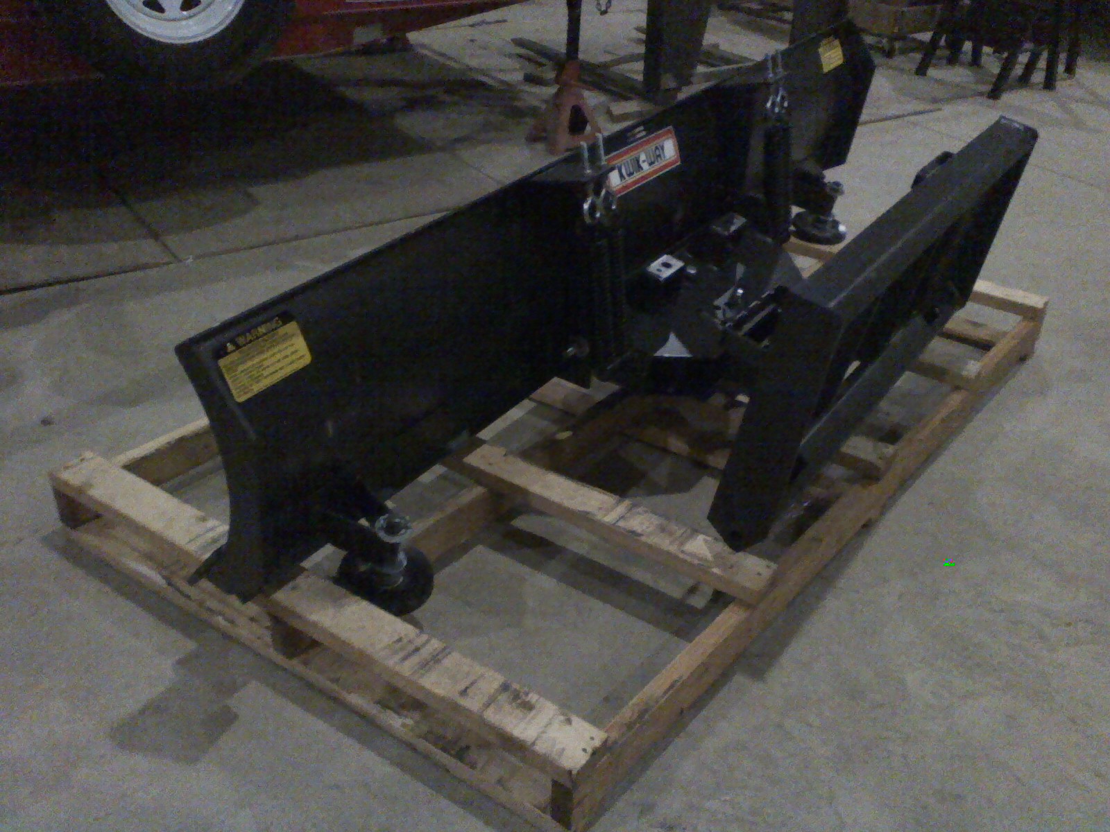

   / After market FEL Snow Plows? #7
Michigan Iron and Equipment.
I bought one of their back hoe thumbs and it's extremely well built. They can also supply you with all the hydraulic hoses and valves you need to angle your plow.
www.michiganironandequip.com
I was able to find a used plow on craigslist. I already had the hydraulics on my tractor for the 4 in 1 bucket. I just had to replace one cyclinder to get the plow to work.

I have a Curtis 7.5 power angle plow.
The blade itself is plenty good but I am not overall pleased with the QA attachment structure.
I have had to significantly reinforce (weld) heavier plate onto several areas due to large fractures.
If I do it again, I am going to examine the Horst (HLA Snow) 3000 series.
