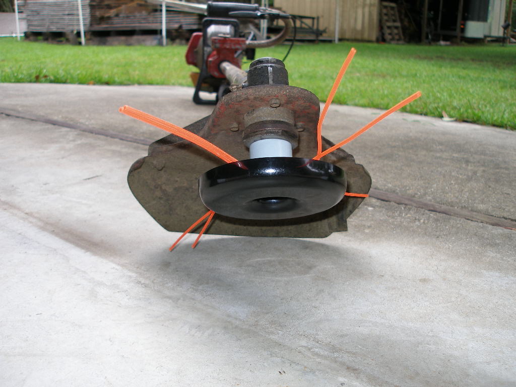

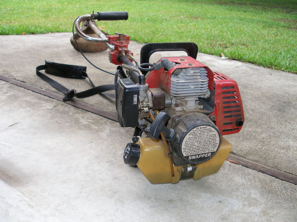

   / After market string trimmer head options that actually work #43
Hey Nickel, glad to hear your good out come.
I received my Pivotrim last week. This is what was in the package.
Before I ordered, I called the company to make sure it would fit on my older Model 410 Snapper commercial trimmer. (About a 60cc engine, so pretty strong) They assured me it would. And, it did. It couldn't have been simpler to attach.
Used it this weekend. For the money I'm very happy with it. I gave it a good workout. Banging into at least 100 fence posts, around trees and along the concrete slab of the house. Of course the strings will eventually break. I would say it lasted 5 to 8 times longer than my original spool head. I used the same string that was in the trimmer (.095) I precut mine at 13 inches, so when looped in was 6 1/2" long. I used all four spindles. I'll try using just two of them next time to experiment next time. All in all a good deal.
Note: Their ad shows the trimmer running into a chain link fence. I don't have that to try, but I really think that may be hype. That has to be bad for any string.
