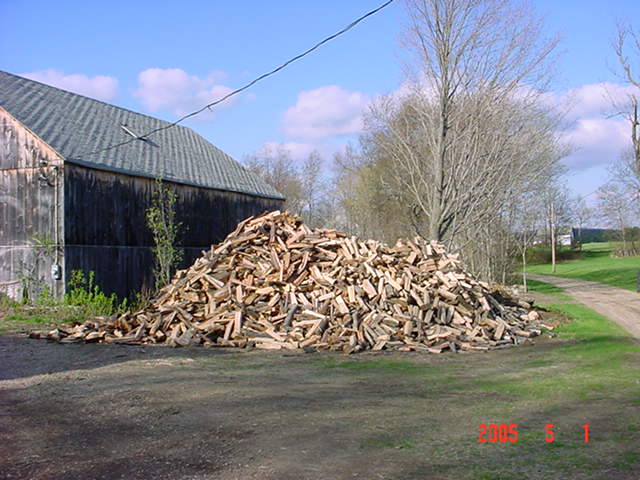

   / After the wood is split, handling, drying, storage #2
That is a very interesting system you have there. Mine, I just put in a big pile. I start burning from one end and go the the other end. By the time I get there the opposite end of the pile has been replenished and had plenty of time to dry. Hopefully in a year or two I can build a wood shed for my split wood that is wide open. The wood will be stacked back and forth at 90 degrees to reduce the drying time.

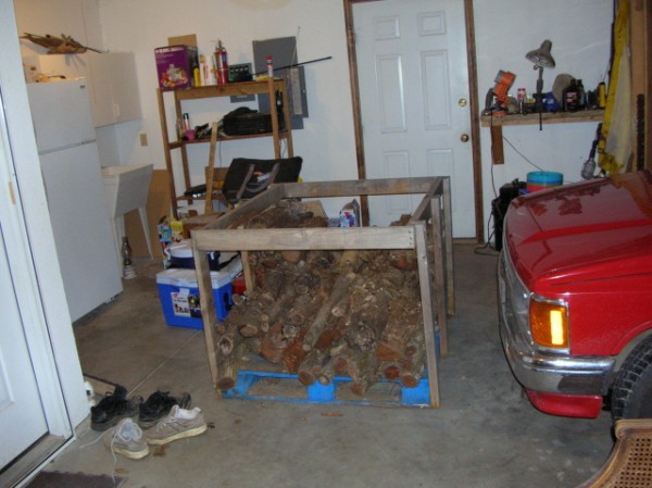

   / After the wood is split, handling, drying, storage #10
An empty one, it works best to slide the carryall into the pallet before hooking to the tractor. AndyM really saved my back with this idea!! /forums/images/graemlins/grin.gif
