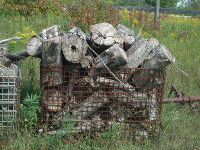

I have a couple of ways that I handle my fire wood. I have an outside boiler so I don't split ANYTHING as long as I can pick it up or roll it into the stove. The smaller stuff I put into these wire mesh gons. I picked up about 20 of them at an auction for $5 a piece and they work very good. I just put them where I have the wood cut down and through the wood in. When it is full I pick them up with my forks and transport them up close so I can get them in the winter and set them next to the boiler. They dry very good and I don't have to manhandle them. All tractor power.
The other thing that I do with the BIG stuff is load them into 2 trailers that I built. I roll them into the bucket and dump them into the trailers. One trailer is 18 ft long and the other is 30 ft. They have slat bottems so the air can get to the wood. I just back them up to the stove and unload right off the back. I'll post some pictures latter this spring when I have them loaded. It sure saves alot of work stacking, and moving them. I want the wood to heat my house and not me and I like to use my tractor and not my back I'm just getting to old for that.
