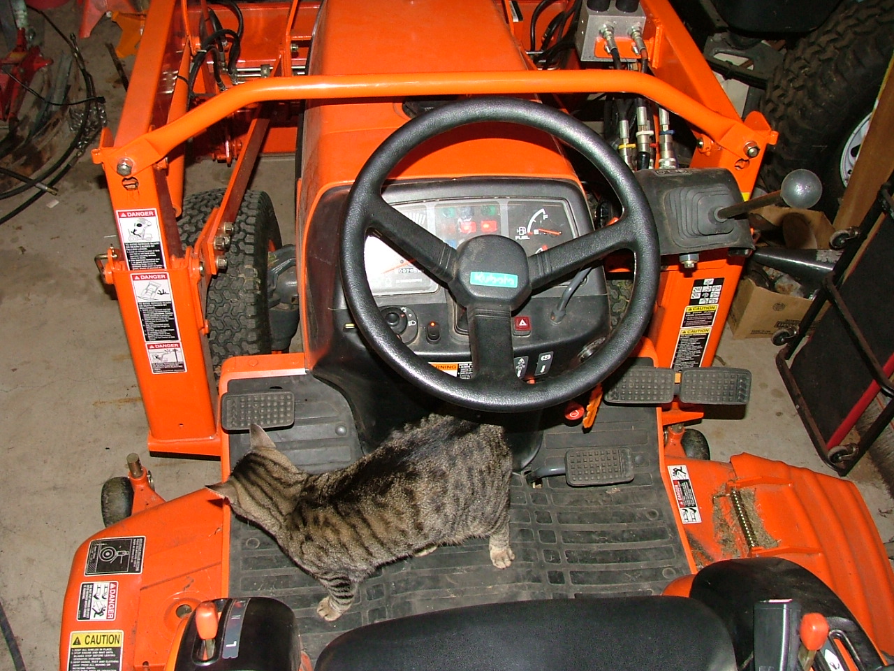

   / Aftermarket Joysticks #17
Not sure what your joystick looks like but if you look at the angle of mine you'll see that a pistol grip would be pretty uncomfortable on your wrist
   / Aftermarket Joysticks #18
I think mine is more straight up, but the pistol grip would probably be somewhat uncomfortable. Never thought about that.
Chris

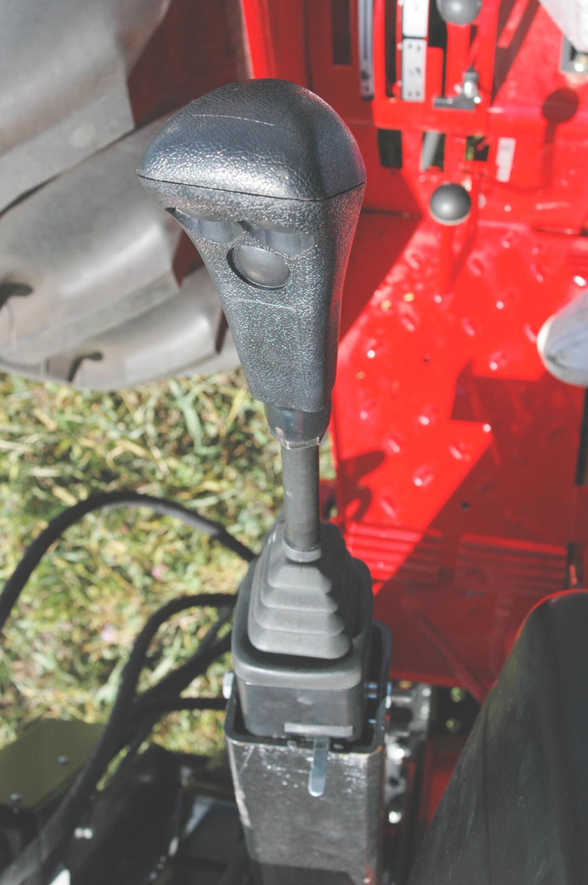

   / Aftermarket Joysticks #19
We don't have these on our website yet, Is this what you are looking for? This is our precision joystick - it's real smooth and button lets you electronically divert to grapple function.
Give us a call at 877-MYLOADER (695-6233)
