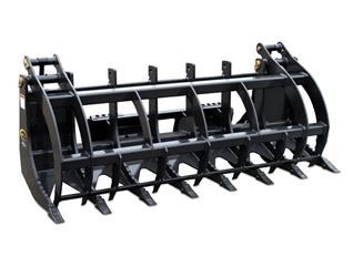

What is a limb grapple?
   / aftermarket limb grapple #4
This?

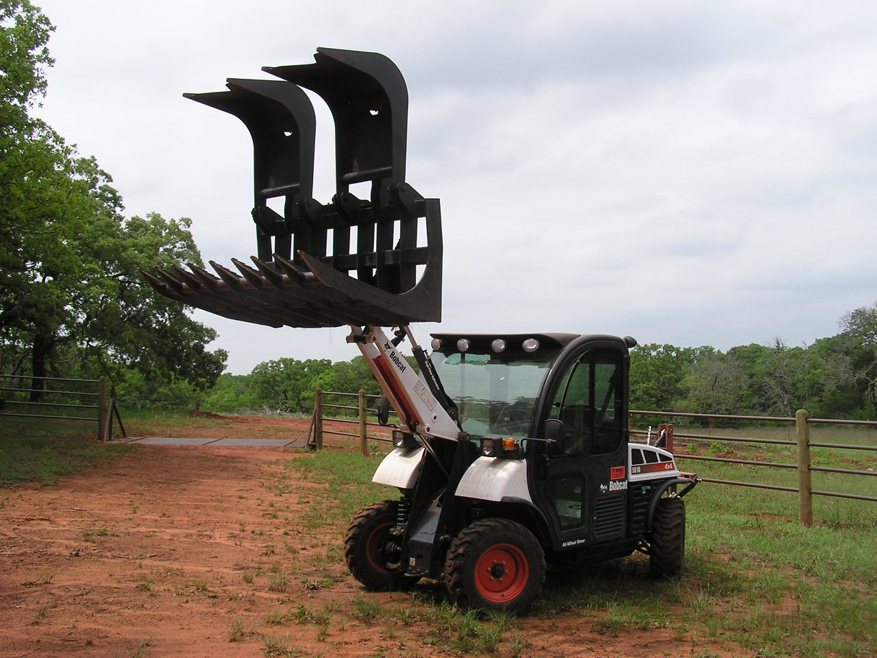

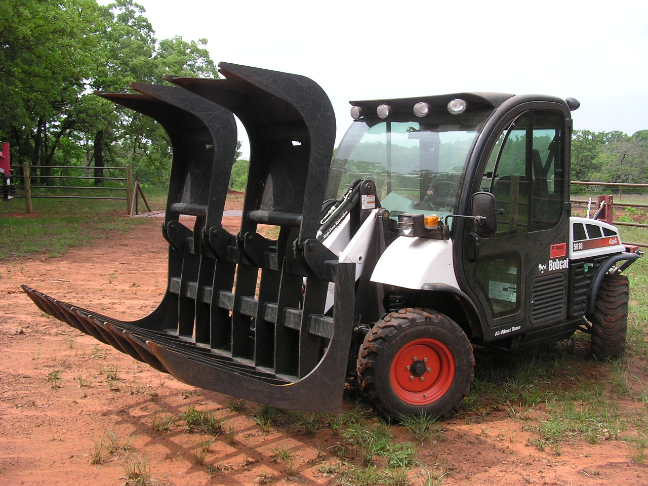

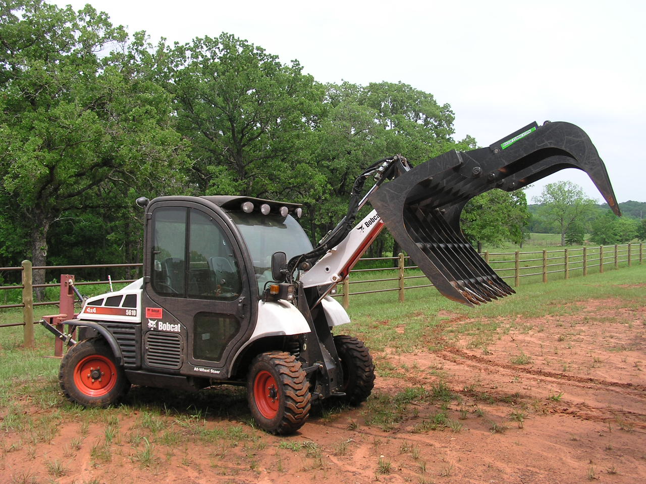

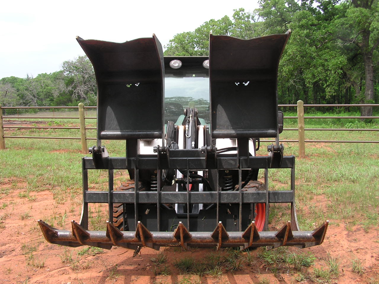

   / aftermarket limb grapple #6
We picked up this 72" one for use with our boomer it has independent grapples on top rather than one makes it a lot easier to pickup odd shaped items. Never had one before and now we don't no how to we got along without it.

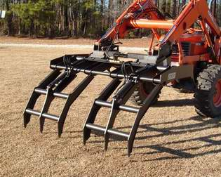

Yes! That's it
There are two basic types of grapples usually discussed, then variations of each. An L bottom grapple is often used for hauling debris and digging down to get rocks and roots out if the grapple is narrow enough. A Rake grapple has shorter lower teeth intended to "rake" out shallow roots and clear brush. I have both and use my rake for brush and back raking (yesterday and today I have been back raking brush and limbs away from a creek). I rake the brush back in a row a few hundred feet of creek edge, then swap grapples and scoop up the debris with the L bottom which grabs more and makes for less trips to the burn pile. I attached pictures from the WR long website of an L bottom and a Rake. The third is sort of a hybrid Rake with longer lower teeth which would be useful in hauling.

The 3rd picture there is exactly what I'm looking for.
