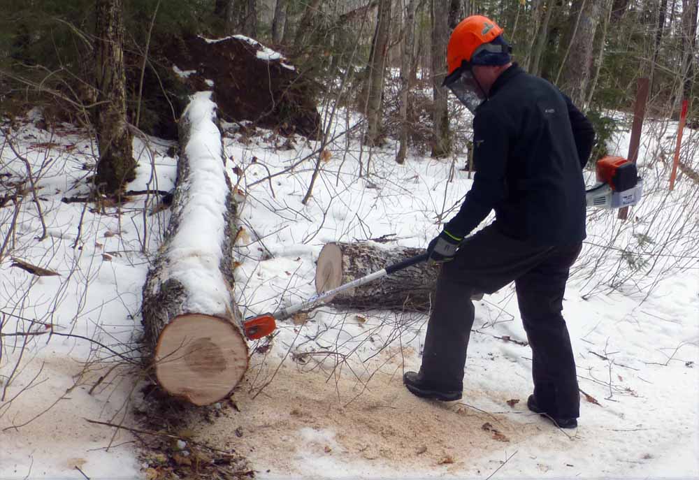

These micro sized chains are not holding up for our type of work. They seem to be fragile and break, or get damaged in around 2.5 days of work so I asked our Stihl dealer to get us the parts to swtich us to the next size larger, 3/8th chains. But the parts are not showing up due to covid parts bottle neck. As stated earlier, we've had good luck with Oregon chains which we got for about $11 but we can not find them in this 1/4 pitch. These also last quite long and got many resharpening. I can't tell you which model Oregon chains these are at this time, but these 1/4 pitch chains are not common and appear to be more costly. I like to have at least 5 chains and 3 sharp ones in the field with us. What did I miss??

Not trying to be to critical here but I’m going to speak up anyway. I get what you are doing with the trail clearing and a pole saw works best but I also see you at time cutting some pretty good sized logs with your pole saw to get them out of the way. When I see those pics I think a chainsaw would be easier and quicker. The only reason I’m saying this it might make your pole saw chains last longer. If you don’t have a chainsaw available it’s probably best to just keep going as you are.

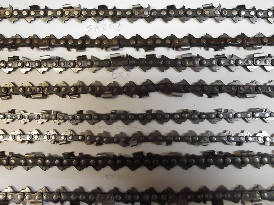

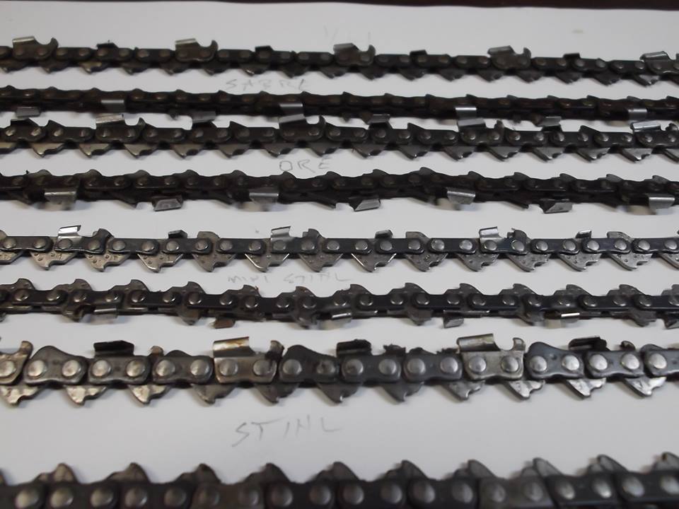

That MICRO 1/4" chain is a whole new game. I had to buy even smaller files for it when I ran it on the 150.
Here is a micro 1/4" compared (marked MINI 2nd from bottom) to regular size 1/4" I have hanging here that come off saws that cam in.
Indeed these stihl micro's are small, so I call them "jewelry chains". :laughing: Nonetheless, they weren't holding up very well for serous users like us. I'll run to my Stihl dealer today and see whats up in the parts and new chain business.
