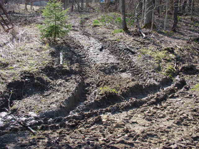

I'm mostly in the mud thats why I opt for the 1's...........

Al -- So much of this depends on your usage and local conditions. I had R4s on my first tractor. Great for loader work and let's face it, they just look so cool! /forums/images/graemlins/cool.gif But they loaded up with mud with annoying regularity and left me stuck in really inconvenient places. Since I log in the woods with my tractor, and do a lot of backhoe work in clay or near streams, I opted for R1 aggies on my present tractor. Love em, and will never go back to R4s given my needs and soil conditions! I finish mow with mine as well, and unless the ground is completely saturated the lawn shows no damage from the tractor at all. The marks on the lawn come from the narrow tires on the mower itself.
Good luck with your decision. Seems like everyone makes do with whatever they select.
Pete

I'm learning to deal with the R4's by now, but mostly I think they're a pain in the rear! I've had to deal with a lot of working in the mud, and they just load up so easily. It doesn't come out easy either, it just falls out later somewhere that you don't want it! I'm always doing top gear runs down the road to try to clean them out. I'll admit that some of it is learning to use the equipment, and recognizing when you are getting close to the limits of trction, but sometimes you just have to go in there anyway!
You can load up the R1s too, but they don't hold as much and it falls out much more quickly. I would definitely get the Ag tire if I had it to do again.
