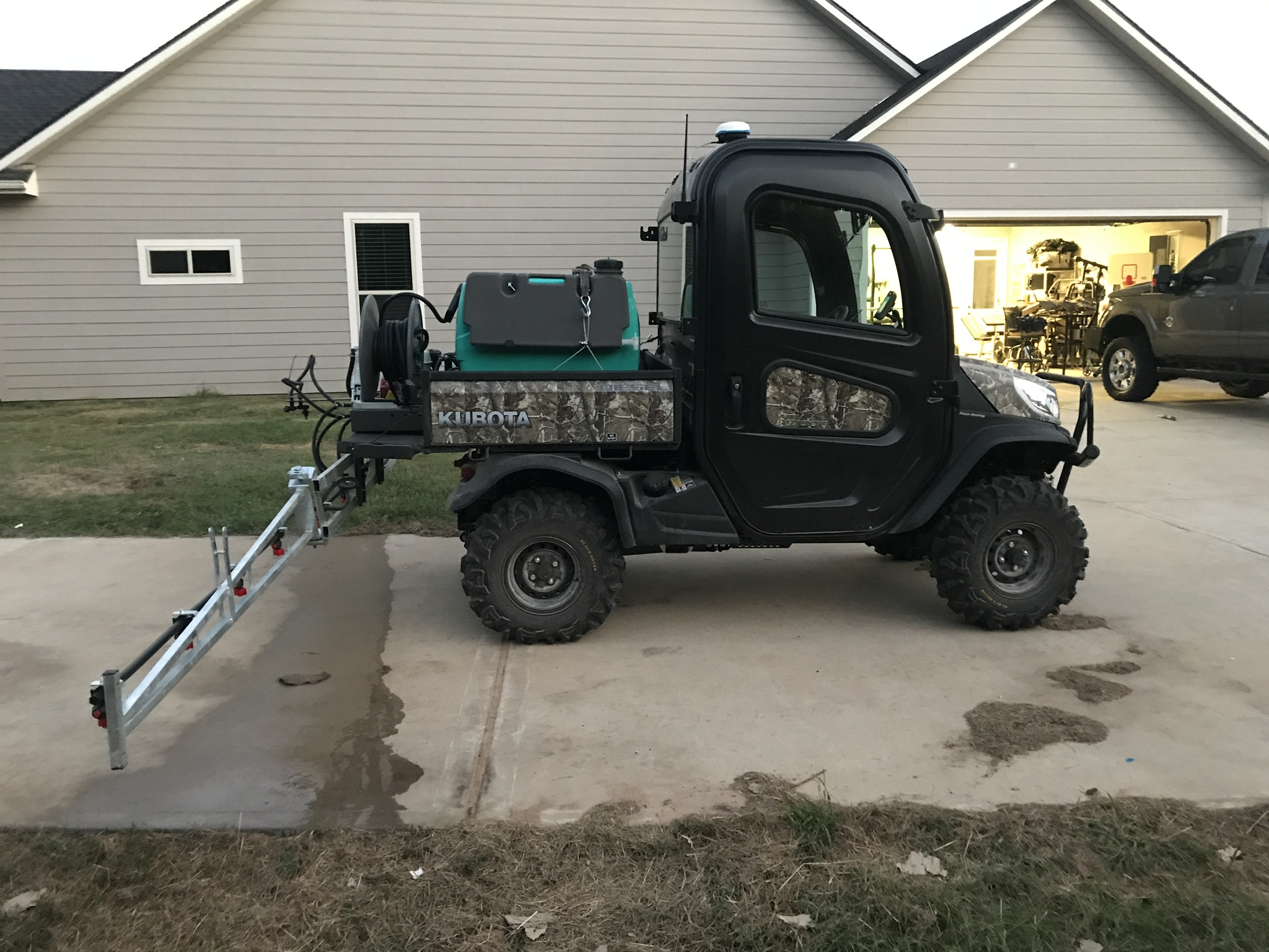

There is certainly a new thought rolling around in my mind. I had never considered UTV spraying, given I have a tractor and no UTV. However, I'd like to purchase one for the farm, and the thought of being able to get in the field sooner/when needed, rather than when everything dries out enough to get the tractor in, is alluring.
How would your UTV work with an Enduraplas, spraying 20" alfalfa? I'm guessing that is about the tallest thing I'd be spraying.
A smaller tank for my property certainly has its appeal in some instances. A larger tank in others. But, if I can spray alfalfa/orchard mix with a pesticide when it is needed, I might have to rethink everything. I'm always ready for a purchase which makes sense... unfortunately, the bankers are always asking for their part every month.
Also, does your UTV have an enclosed cab? Sitting 6ft in front of my booms AT BOOM LEVEL, with a little tail breeze does not make me feel warm and fuzzy.. or perhaps it would begin to, which would be the problem.
And finally, how easy/difficult is it to change boom height? The videos seem to have a solid mount.

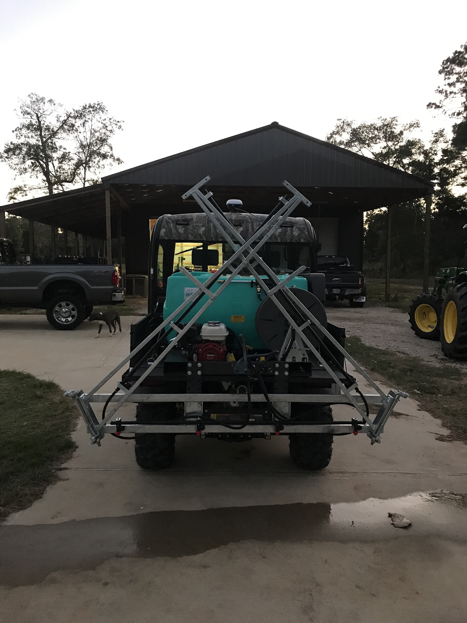

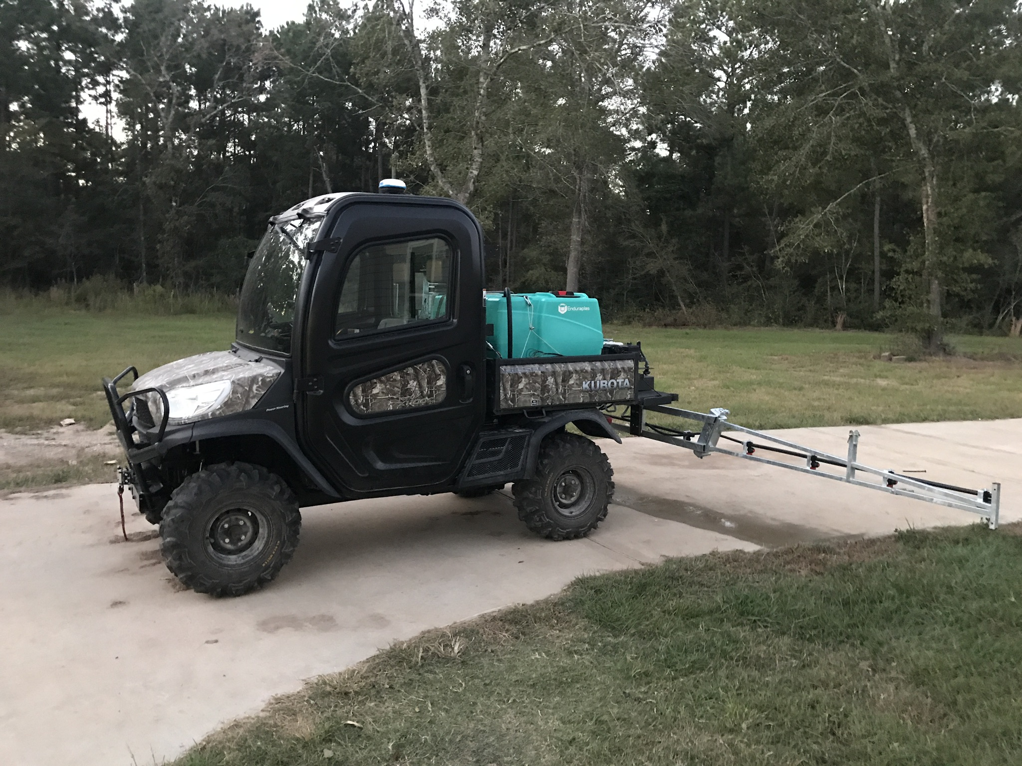

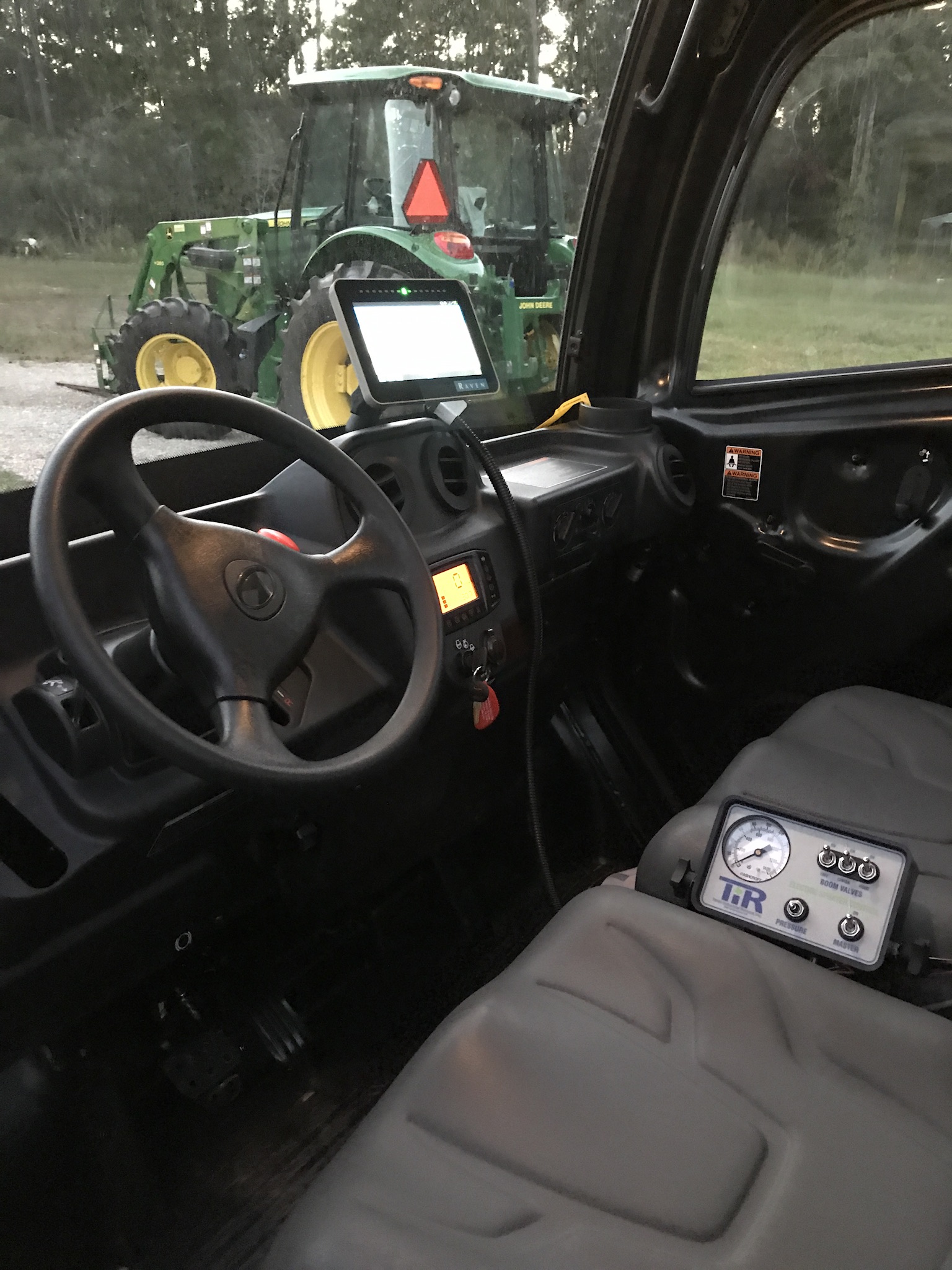

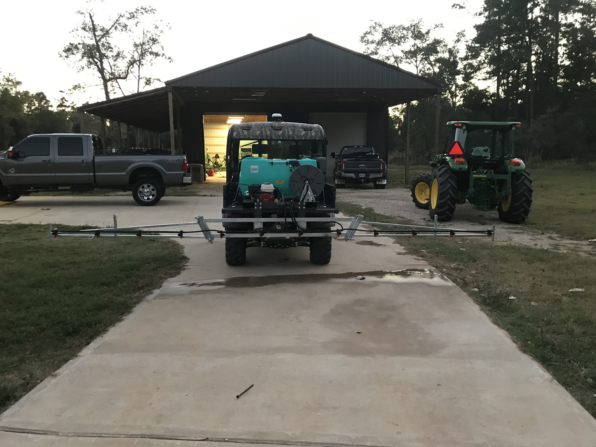

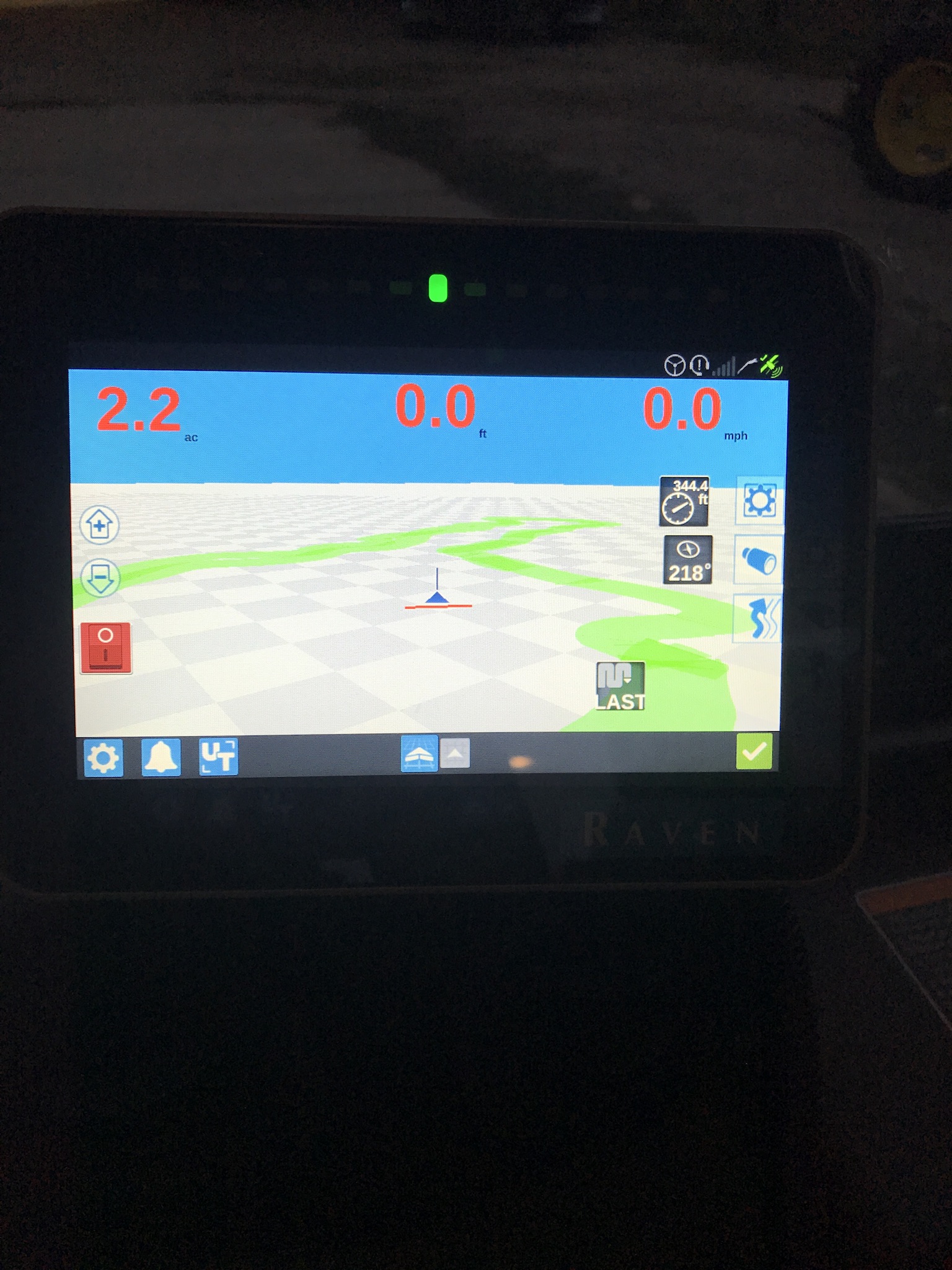

I have the kubota rtv x1100c. It has a climate controlled cab and is very tight (need to open a window a bit to close the door easily). There are several mounting holes you can choose for boom height. I have a 330 gallon water tank and 1 gas powered pump so I can quickly refill and get back to spraying. The rtv rides great, plenty of power and can be used for other projects too. The enduraplas has fork lift pockets so it痴 a quick project to remove it from the buggy.
Here痴 some pics. Going spraying again tomorrow. Really like the electronic valves for the cab. Gps is almost a must to reduce overspray and ensure complete coverage without having to rely on dye or guessing.

The rtv cab will protect you from mist. Nothing for what you breathe.

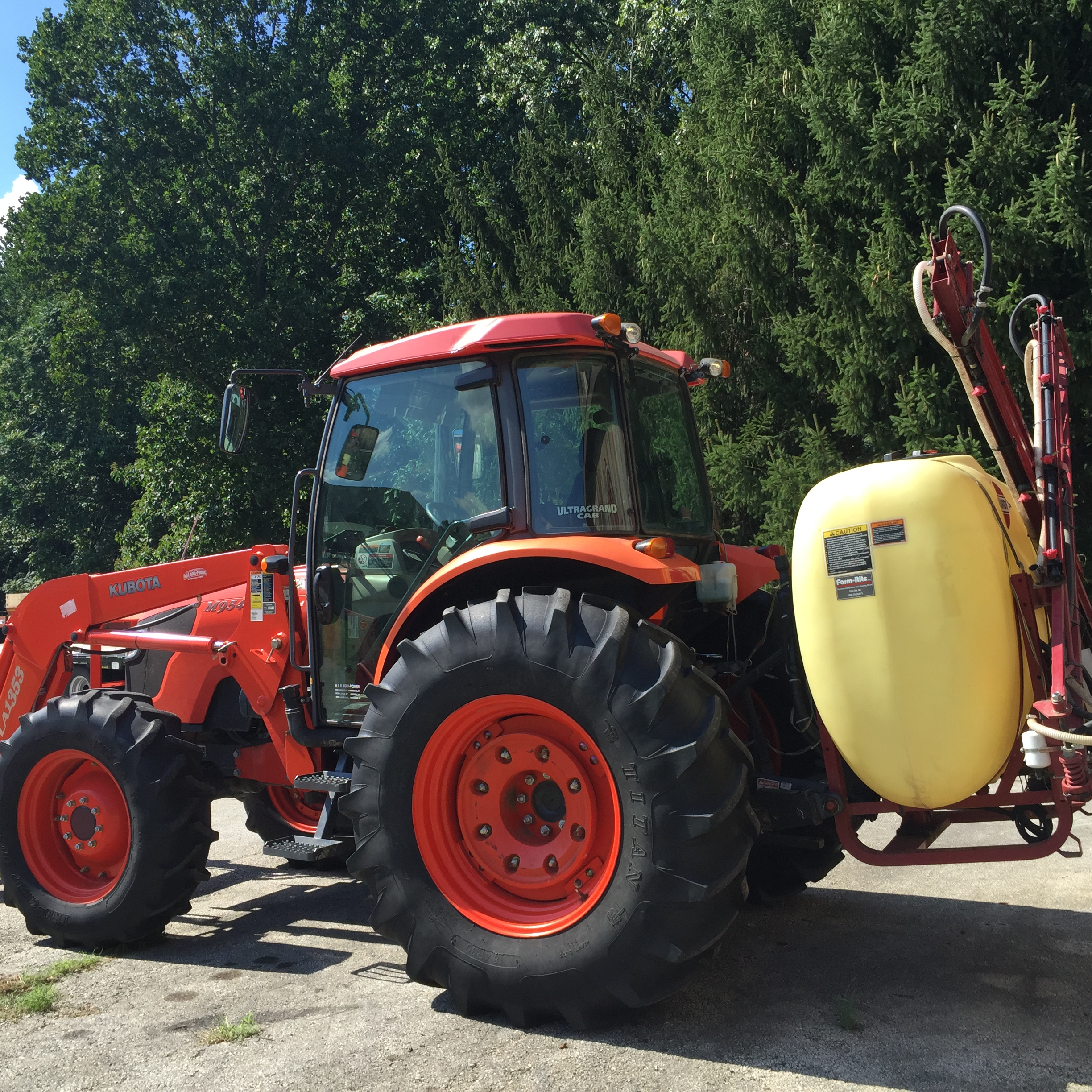

I purchased a used 3pt hitch boom version.
240gal
45’ booms
Foamer, which worked initially but I think the compressor sprung a leak as it isn’t working now, although the pump is running. (I’m thinking about removing it in favor of A rinse tank and potentially GPS down the road.)
PTO centrifugal pump (Hypro)
Wet boom... although I’d like to change it to dry if I ever get around to it. I don’t know that it would make sense for my purposes though.
Single nozzles on 20” centers
Teejet 744A 3 section controller.
Hopefully I can get it tuned up and working well for my purposes.

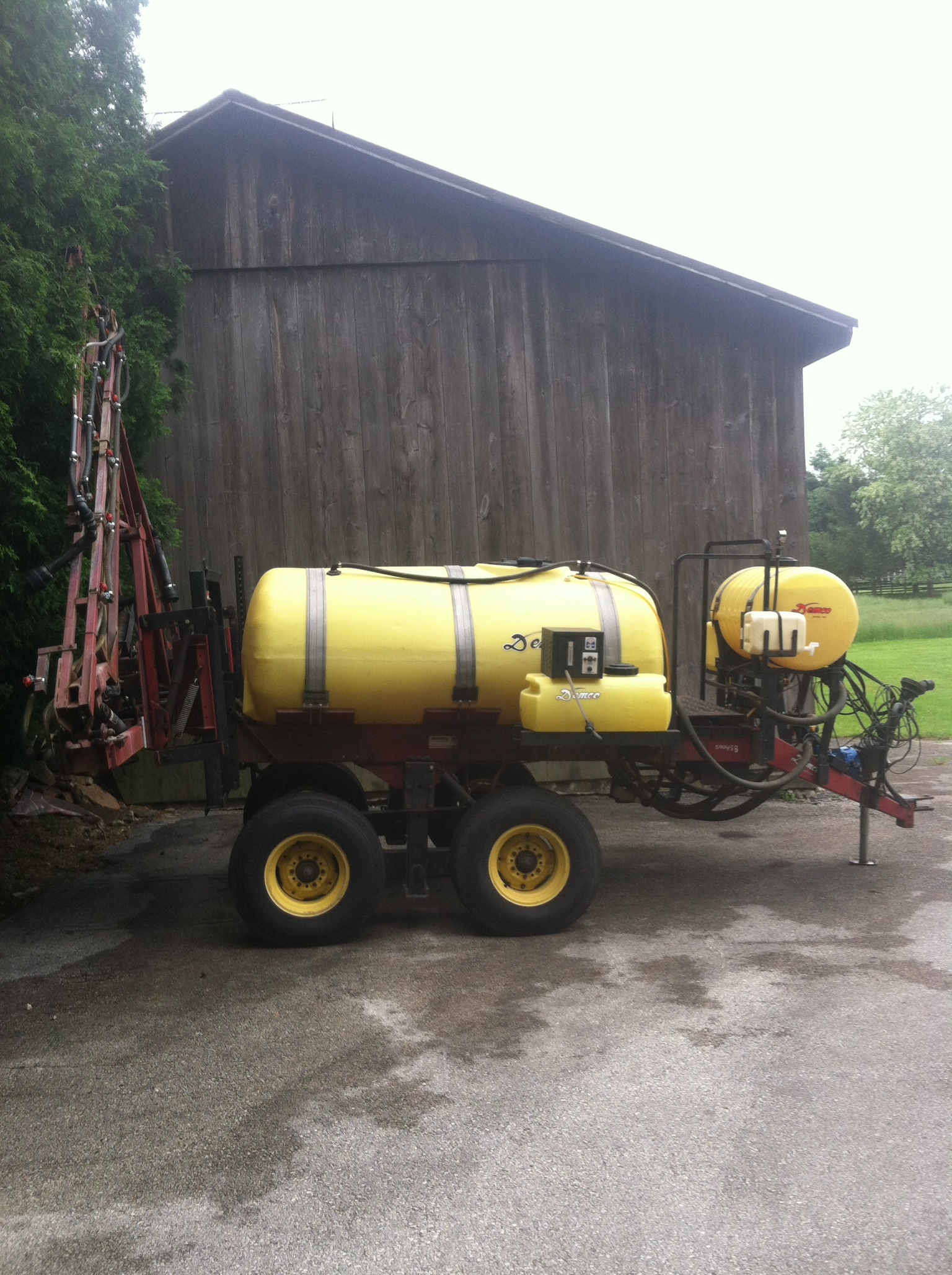

I've been working on modifying the new sprayer so that it has a boom as well as boomless function. I also wanted the boom to be hydraulic. I may hinge the booms again or fab them so that they can just be quickly slipped off. Or I may just leave them like this. I'll get the spray tips on and decide. I love the way the hydraulic fabbing turned out.
