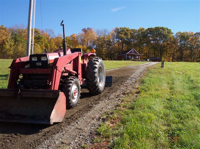

Im not sure I can add anything more helpful than the advice youve gotten allready ! I just wanted to mention that on my MF-1040 my tire combination is 13.6x24 rear with 8x16 up front. The rear rims our dished out for stability and the traction is adequate. The tractor weighs in dry weight 3800 lbs without the FEL and or implement.
Im including a picture of the machine with the above mentioned tire sizes. As I said previously, traction is adequate grading my driveway bottom to top with a 6ft rear blade, and I have had that blade loaded.
