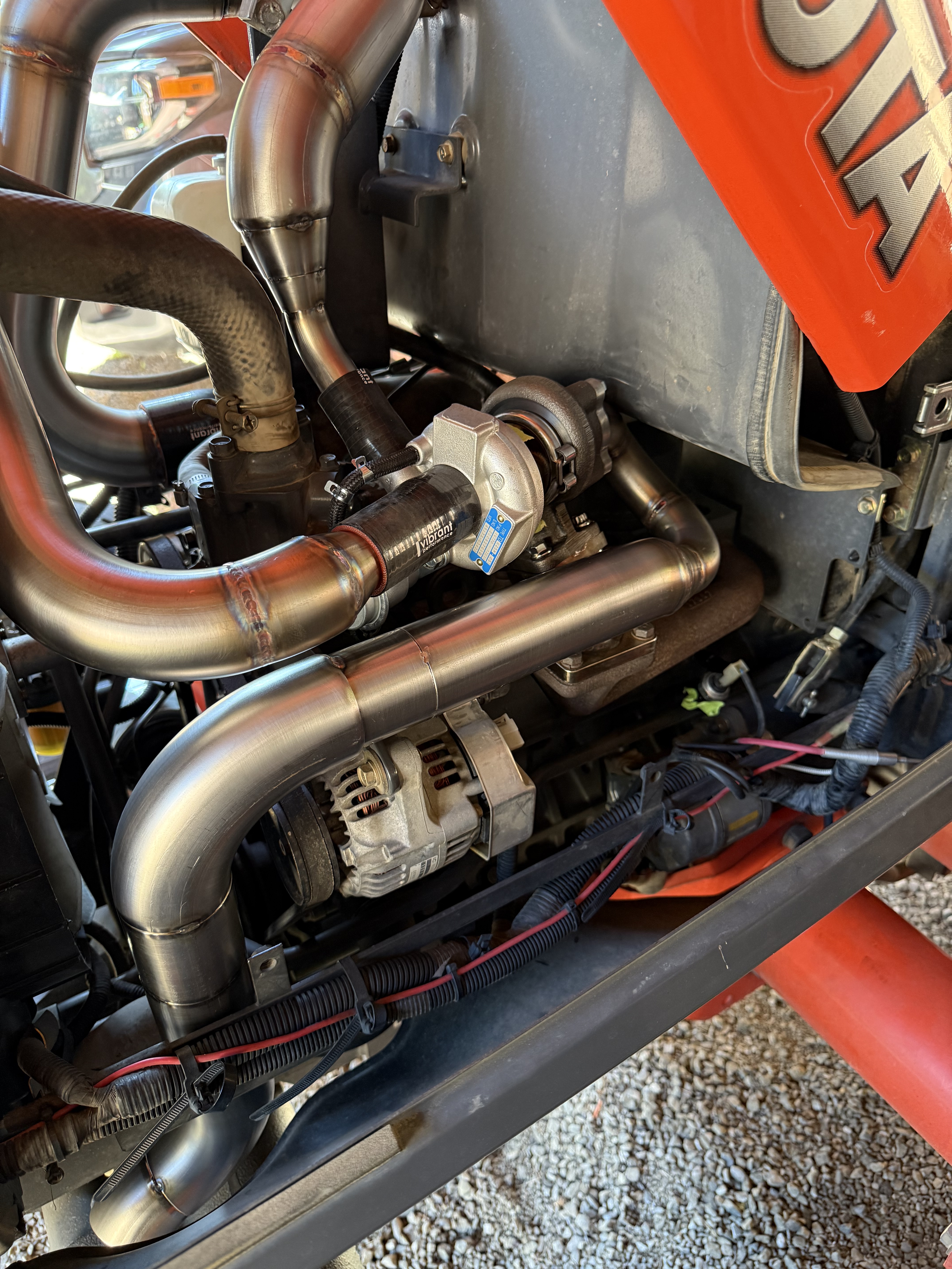

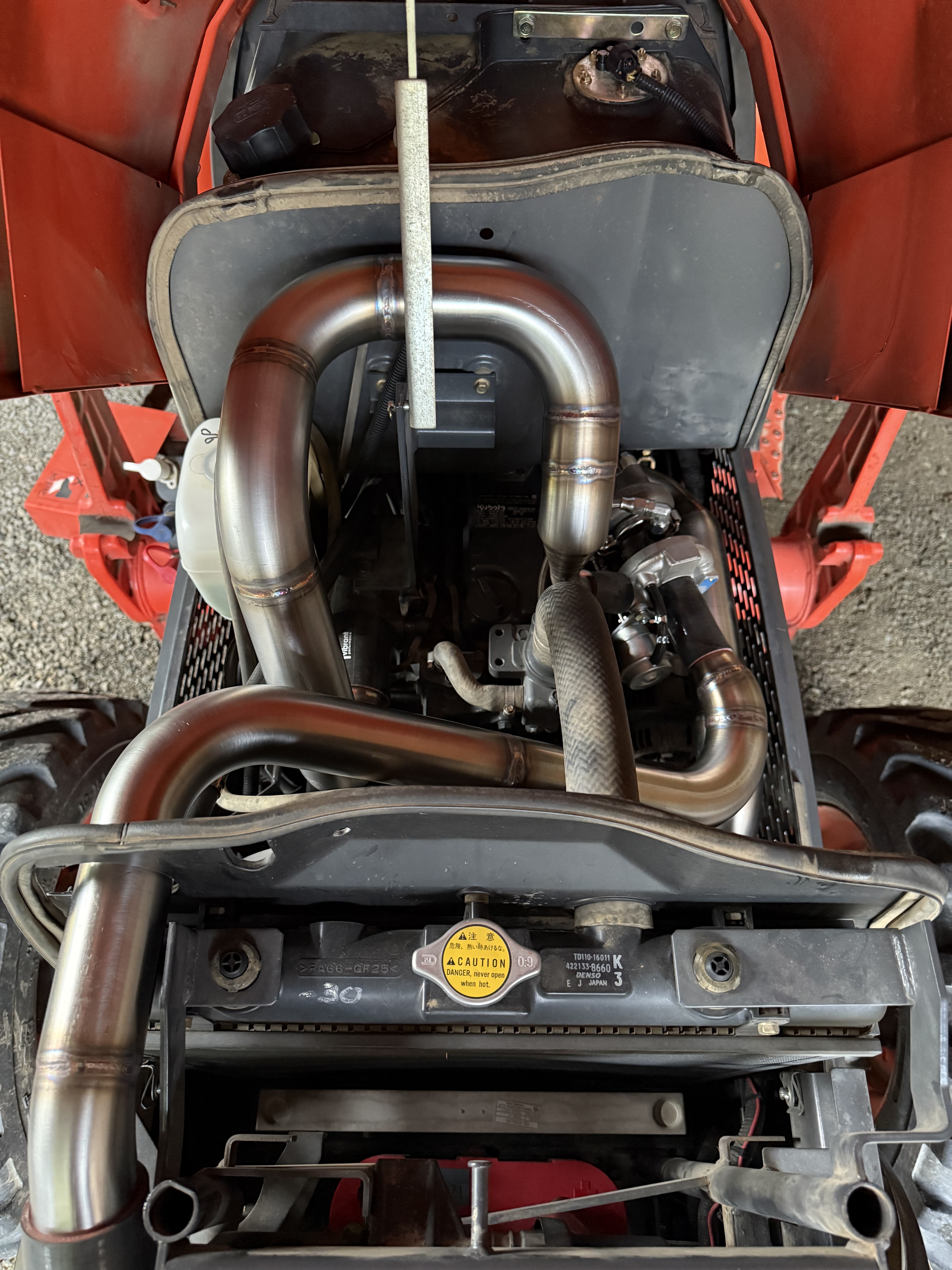

You have to monitor EGT’s on a Turbocharged N/A application like yours (and with the L2501).
It is complete speculation regarding the reasons why your engine failed at 400 hours. It could be pistons. Or, it could be 1,600 degree combustion temperatures sustained over a long period of time. Who knows…If you’re not monitoring engine diagnostics and you have no idea on combustion temperatures it’s no surprise it eventually failed and I’m rather surprised it lasted 400 hours.
The D1703 is a very capable engine that can be boosted safely assuming the user monitors engine diagnostics and maintains a safe EGT and combustion temperatures.

great write up. I wonder two things:
1) where did you end up integrating your EGT reading? Did you put a gauge on the dash somewhere?
2) With the fuel adjustment, what's your average runtime on a tank vs before? (increase in consumption)
Thank you!
EGT’s are being recorded before the Turbocharger in the Turbo adapter. It’s the best compromise and gives us a measurement based on all 3 cylinders. Right now, I’m using a diagnostic gauge that I have mounted on my loader bracket. I’ll eventually transition to a fixed gauge on the dashboard.
I haven’t yet measured the fuel consumption. The consumption has gone up a bit, but, the Tractor remains incredibly fuel efficient.
