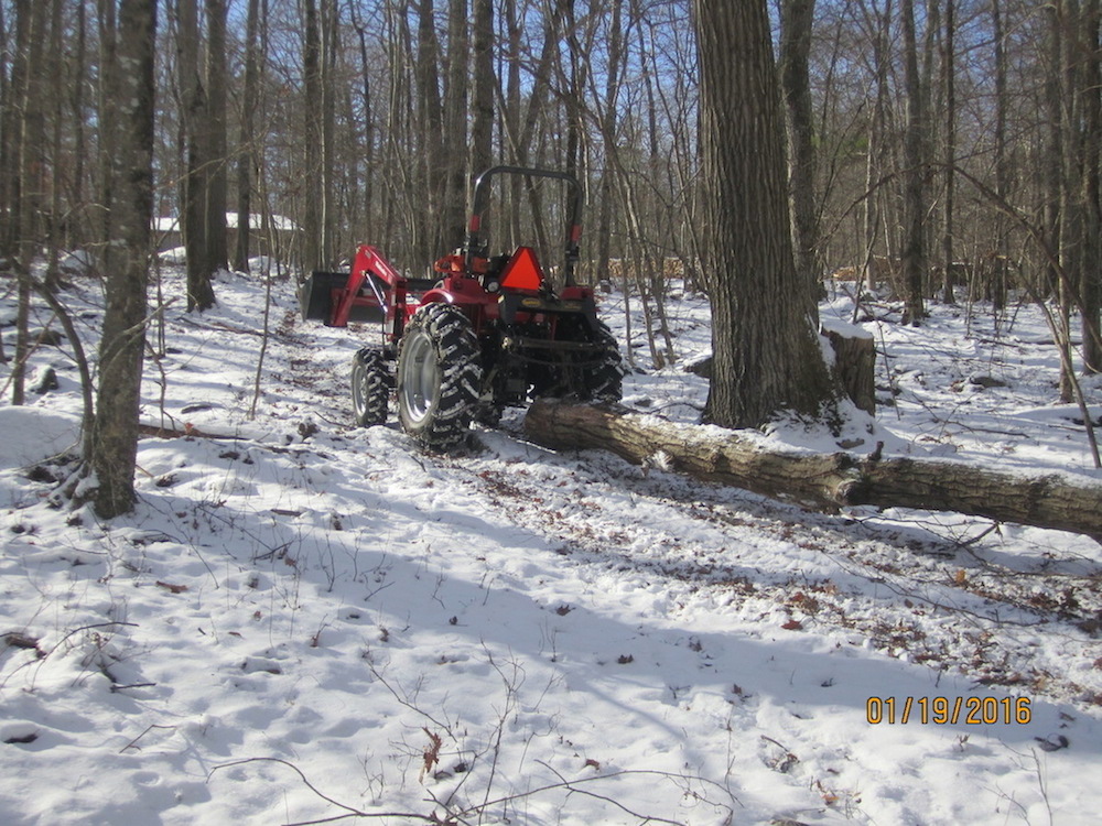

Power hop is corrected by adjusting inflation pressure and axle weight (ballasting) to the needs of specific applications. Blanket statements concerning tire fill levels having a linear effect on power hop are incorrect.
Correct. Some ballasting to alleviate requires less than 40% fill and further differentiates whether the tractor is mfwd or 4wd.
All and all, not applicable to the way I use my tractor as probably for a lot of others here.. They should have filled them to 75% as their blanket "theory" doesn't effect my skidding logs out as much as weight.
I didn't "power hop" once while pulling this stem out nor with the other 100 stems.. Must have been the 50% tire fill :)
