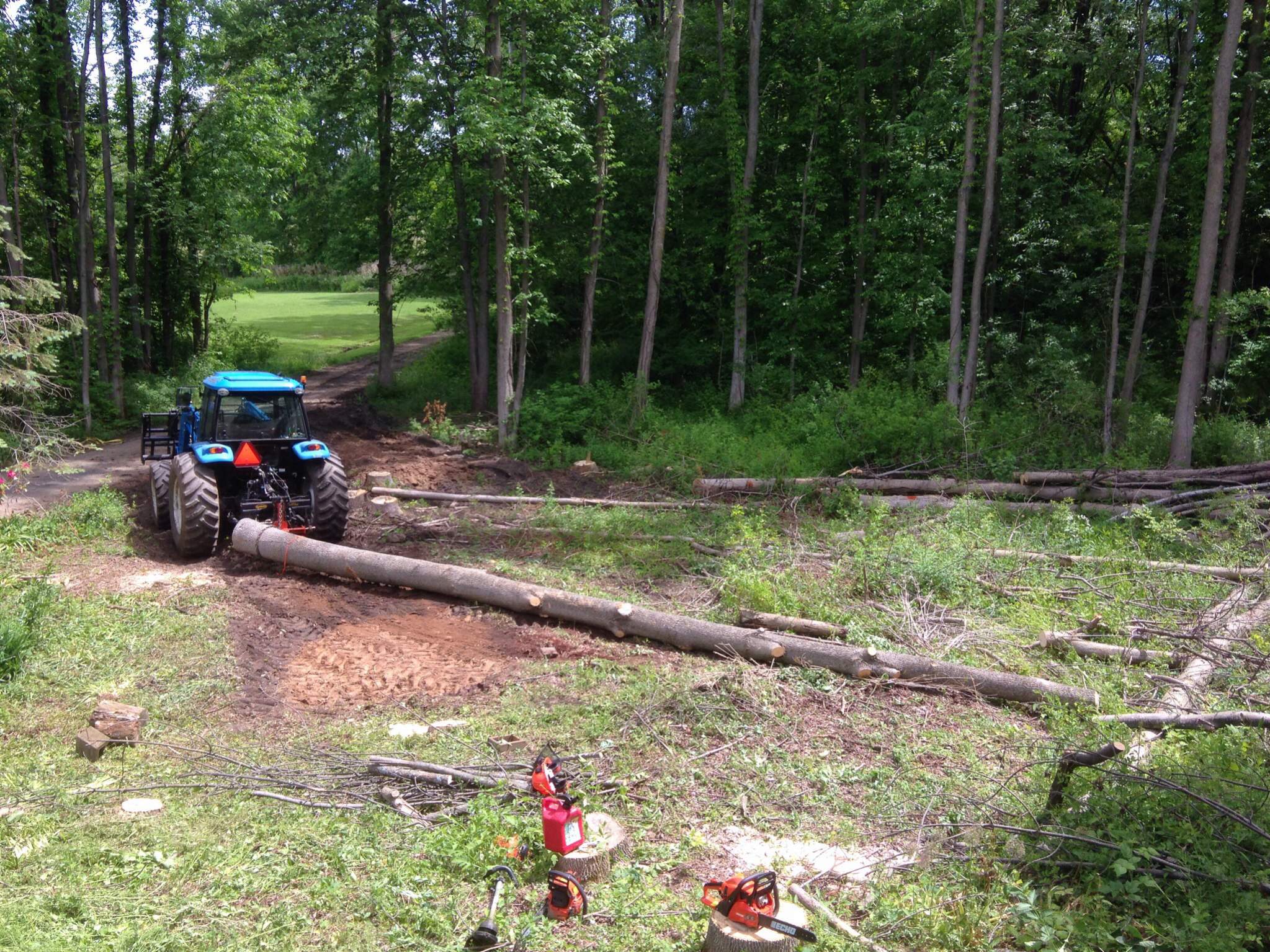

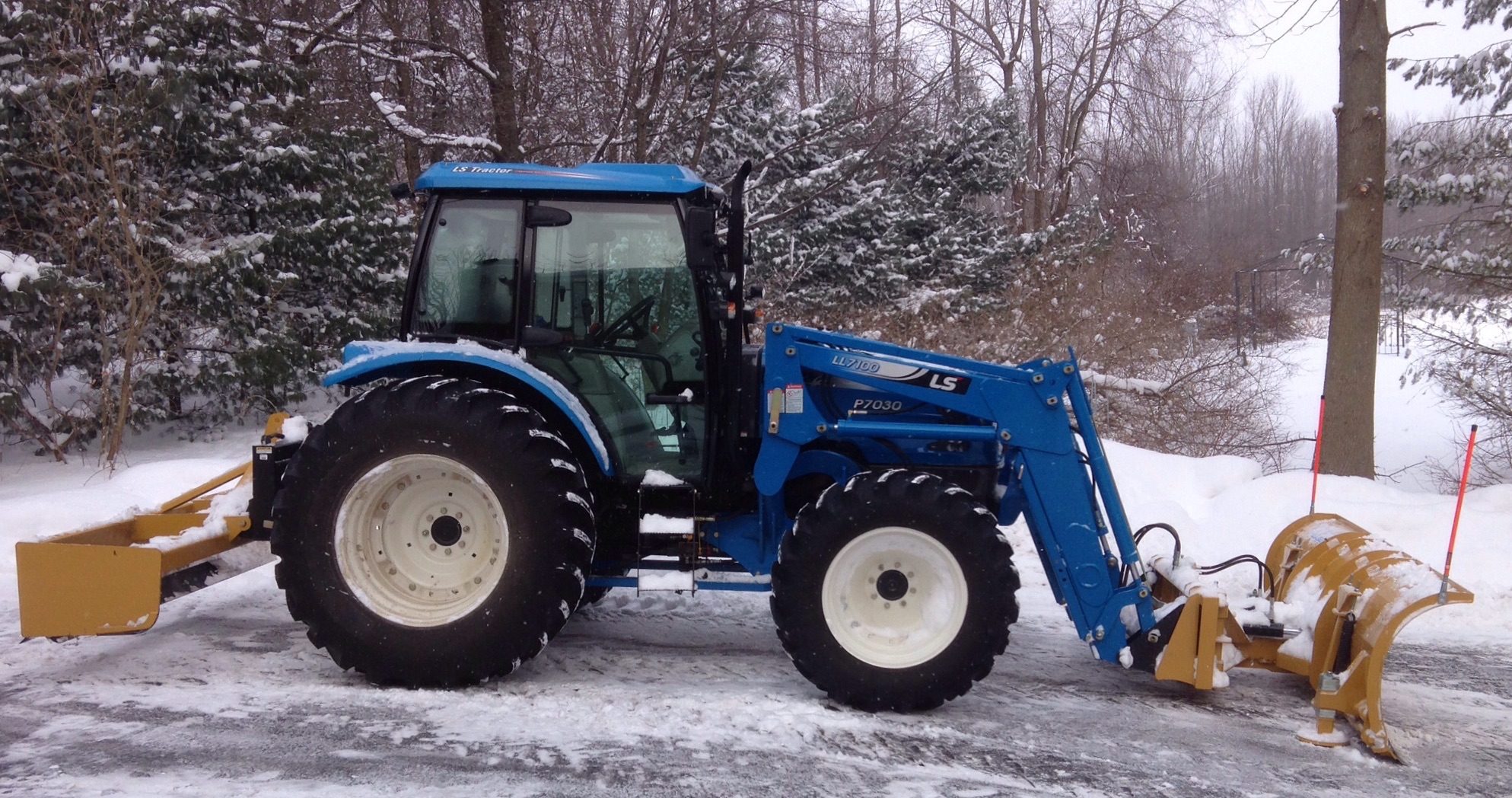

I have the P series that I run a snow plow with without chains or loading the tires. Done a great job so far but not sure how my steep compares to the OP. I have about 300' of pavement by the house and 1/4 mile gravel drive to the road.
I also do a lot of tillage and log handling and my proprty is very wet. I have plenty of weight and with all wheels churning I can dig fast enough already. The one time I would like more weight is handling logs after dragging them out. Hopefully I can pick up a logging winch to solve that problem!

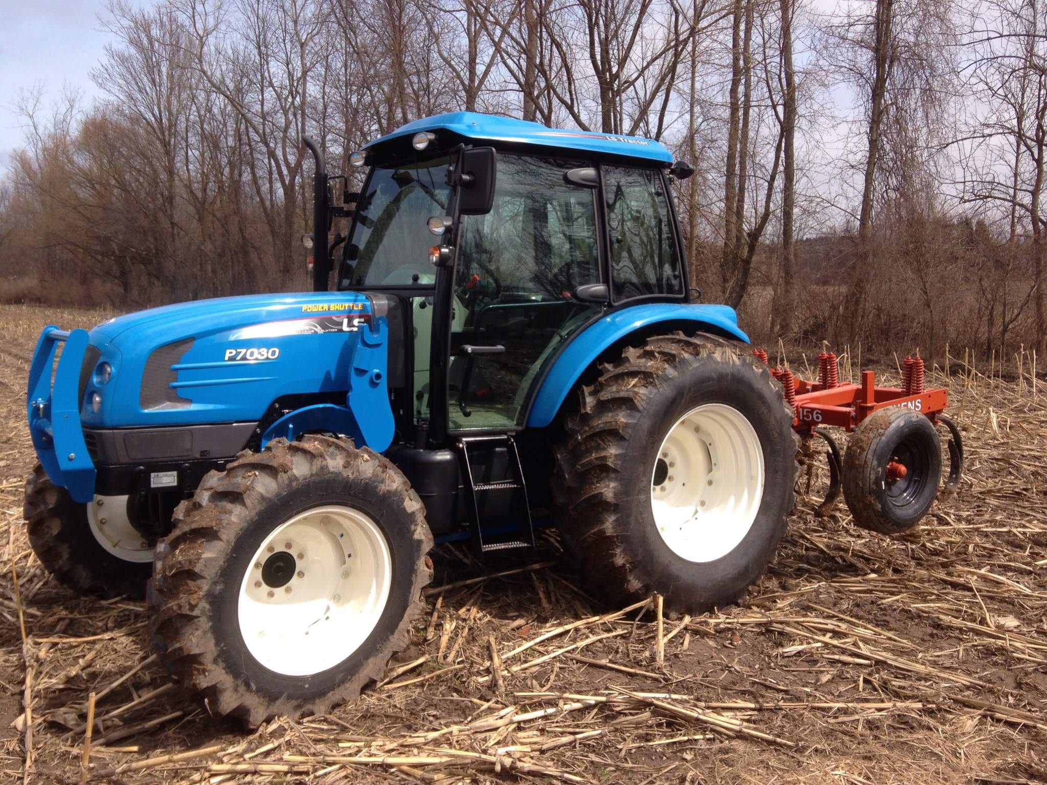

I would get the front and rear tires widened before delivery, especially since you said you lived in a steep area. On mine it put the tire centers out further than the fenders but results in a very planted feel. I would get them done before you get the Rimguard, handling loaded tires and wheels, especially that size are a real load. Here is a photo of the plow setup and another where you can see the width of the tractor. Have fun!

What do you mean by getting the tires widened? Is it a different wider ag variety? If so do you have the size? Thanks for all of the replies. They have really helped.

The rims can be mounted on the hubs in different configurations to adjust the wheel spacing. I believe the are 4 possible combinations.
CT
   / Ag tires, LS p7010, and front end loader #10
Tractors are usually shipped with their tires in the narrowest configuration. Some dealers don't necessarily change them unless the customer requests it. They may want them in the narrow setting for certain crops, entry into stalls etc.
I found a photo of my tractor where you can see how you can change the width by flipping the wheel, changing the bolt locations etc. Same for front or rear. (Especially if can enlarge it) The difference between the min & max settings on mine is 10".
My only suggestion is you have the dealer do the change if you want it, especially if you get the tires loaded. Have fun!
