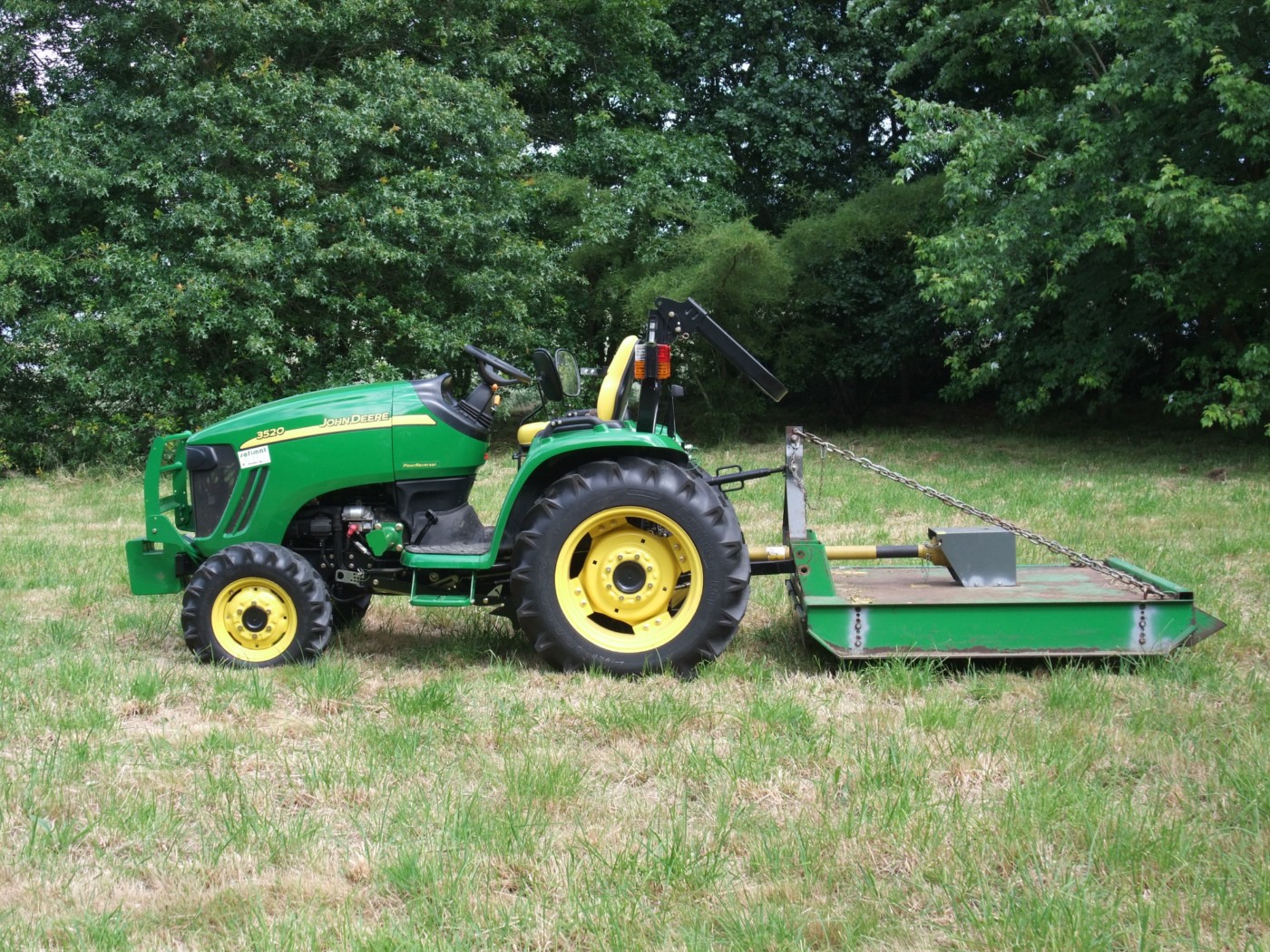

I have no experience with R4s, always had R1s and really appreciate the traction. I had two Massey 35s, both bought used, and the tires didn't hurt the grass. Changed for a new JD 3520 last year and discovered the brand new tires could easily make a mess in the yard. I now avoid 4WD and sharp turns as much as possible around the house and I'm happy to say a divorce has been avoided.

   / Ag tires on my lawn, my opinion #7
I hear what youre sayin about new tires. It may be those ag fronts on the JD. With the loader they are carrying a bit. Also in 4wd, if the fronts dont have a good lead ratio and good dynamic toe out you will have scrubbing in the turns which will leave you fixing the turf every time you turn hard.
Your JD seems to have a more aggressive R1 than mine. Also, it is a bit heavier than my 2610 w/o the FEL or BH. That may be the difference in why it would tear up turf.
