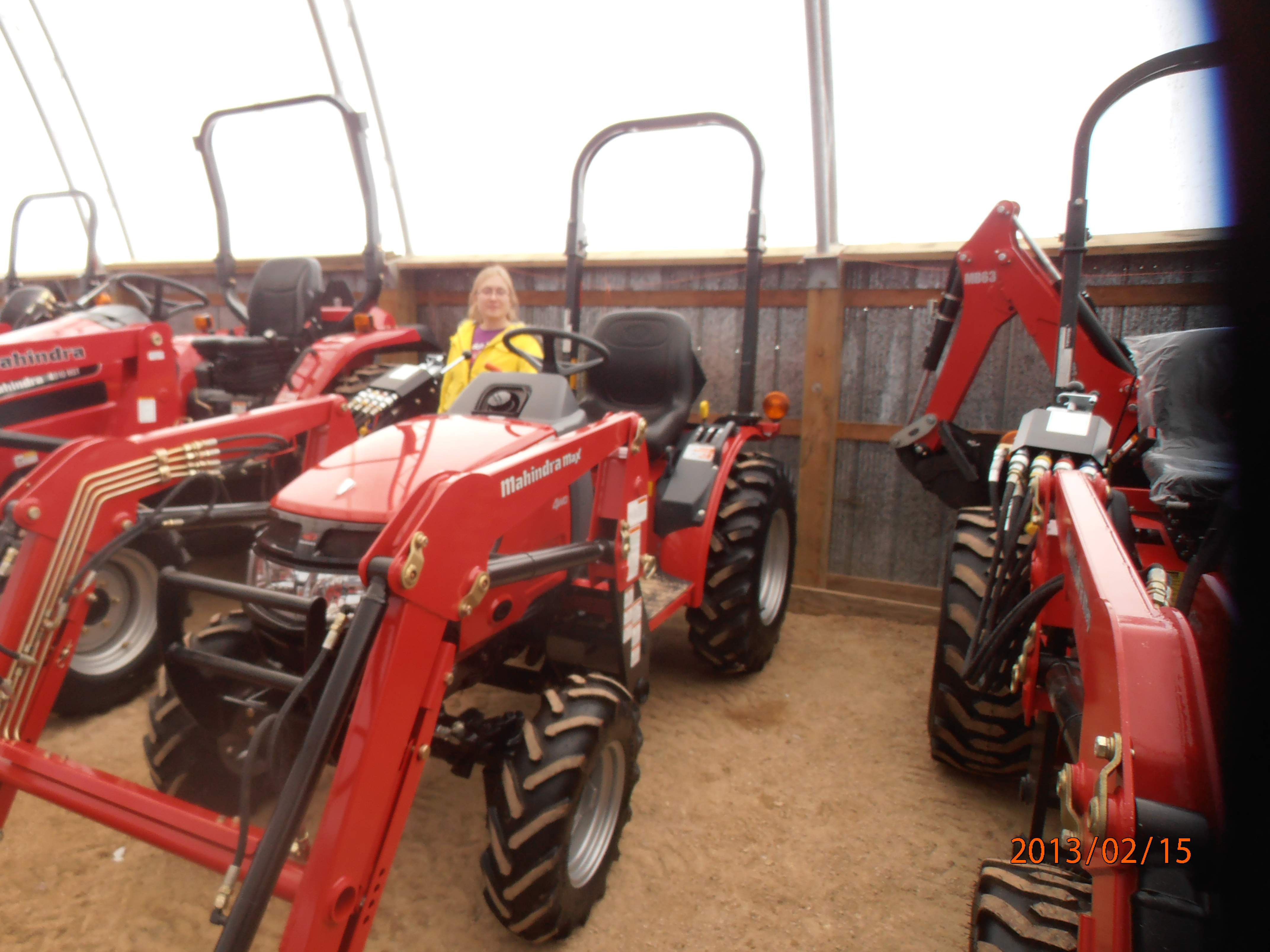

I think you need to decide on this one. Don't even know if you have a loader. Either tire will work with your Bush Hogging. You have to look at it and if you like the look of R4 go that route. Its hard to find a compact with R1s so I will post a pick of a Mahindra I checked out. I like the R1 on the left but the wide R4's on the right look nice and beefy as well.
