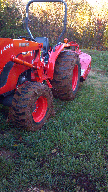

Here a pic of r4 in the mud. You can tell how deep it got and it came out of it just fine, didn't stop my momentum though
