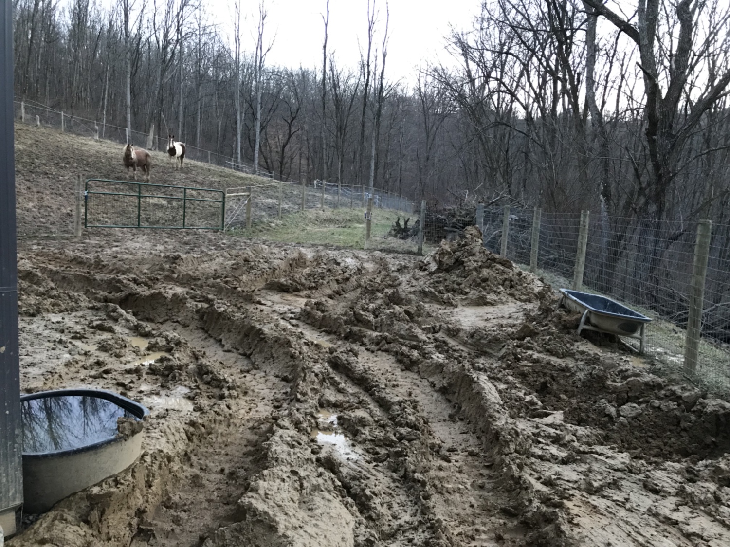

Ps: This is what I was into earlier this week preparing for the flooding we are getting now. I used the loader to make that big pile after I reduced the elevation to promote drainage in this area until I can fix the mess come dry weather. The mud was about 6-8” deep, just below the top of my mud boots in some places.
