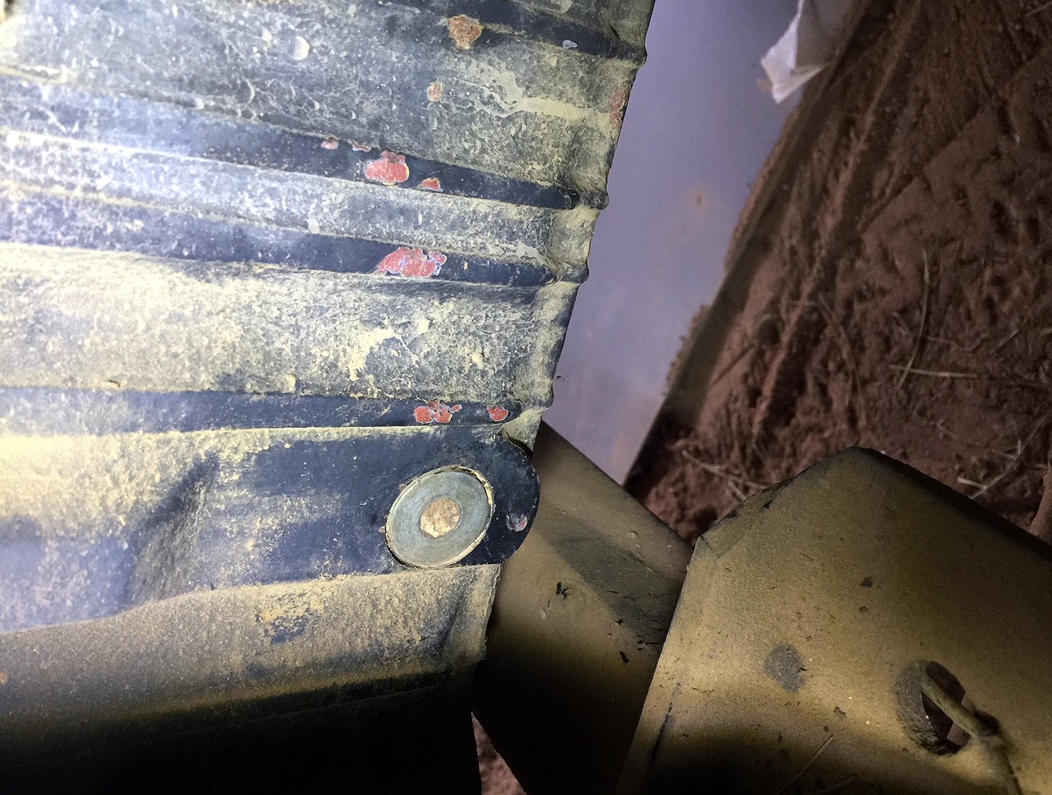

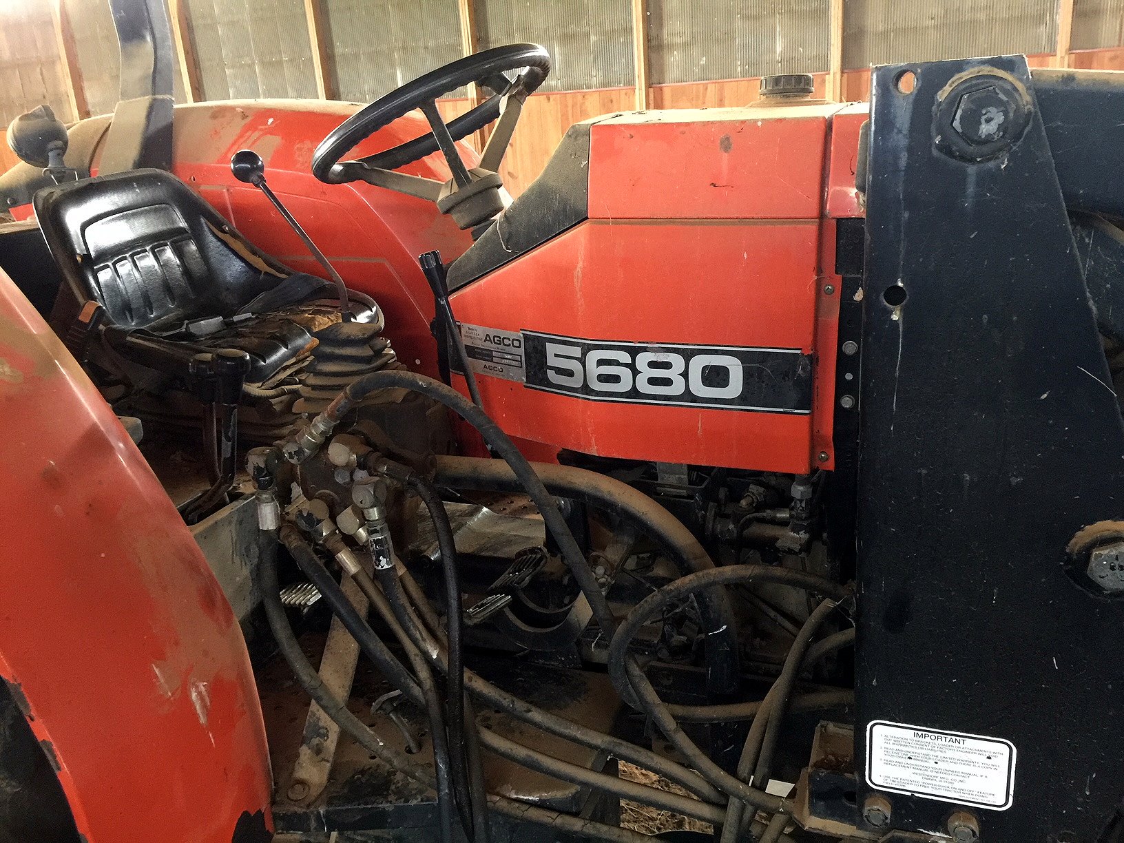

I am trying to find the drain plug for Engine oil on my AGCO 5680 tractor. Does the engine oil also go into the transmission. I really need to find out how to drain the oil.

It's on the bottom of the oil pan, I think it will be Allen head. If fact there's probably two of them there, and they are flush so you have to look for them.
NO, the engine oil does NOT go into the tranny...

Thanks Rob, I was looking and feeling for the plug to be sticking out. I will try again today and look more closely for the Allen type plug. I will let you know and maybe even take a picture

I took a 2nd look and found drain plug on lower right rear side (not bottom) allen hole was plugged with dirt so it blended in.

Hey, I'm glad you got it! Those tractors came with all the tools to do the maintenance, including an Allen wrench that fits the drain plug...
They are good tractors...
