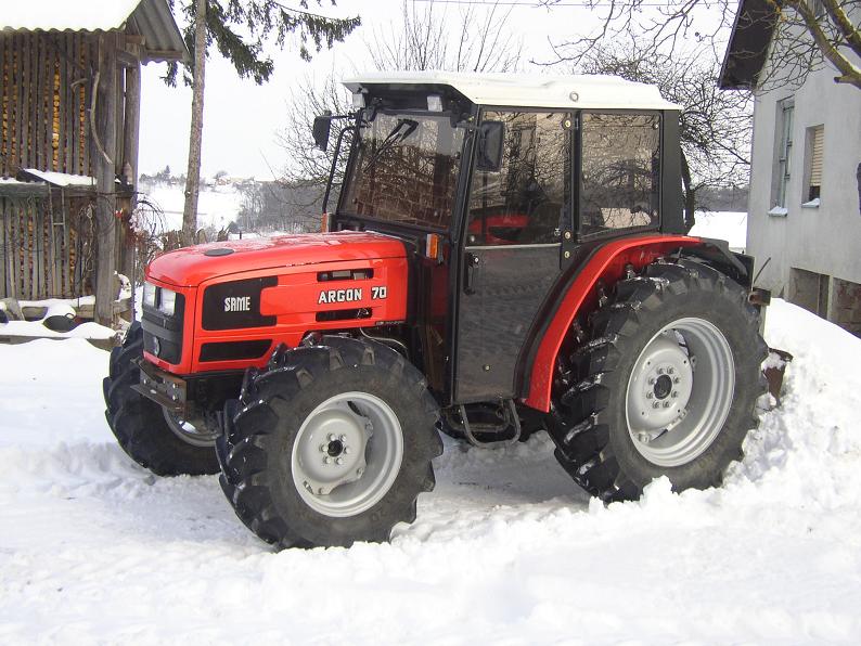

SAME uses OWN air cooled engines, not a Deutz!!!
Transmission and hydraulic has own oil, and engine has separated oil.
AGCO 5680 is rebadged SAME Explorer
BTW; I have his smaller brother at home /forums/images/graemlins/wink.gif

/ Agco Allis 5680? #9
Nice looking tractor. Looks a lot like my agco-allis 5660 but with a cab and different color. I have an alo 310 loader on mine also.
/ Agco Allis 5680? #10
Your 5660 is equal tractor to mine, just with some differences:
- plastic removable hood
- turbo added for 70hp
- stronger rear end (bigger bolts pattern, like on 80 hp models)
- 24F 12R tranny
- 40 km/h (25mph) top speed
- 540/750/1000 shiftable PTO
- front and rear brakes
- front and rear differential lock
- wide metric tires
Cab is aftermarket, factory mounted.
I don't have loader, as 95% of tractors are without them here.
