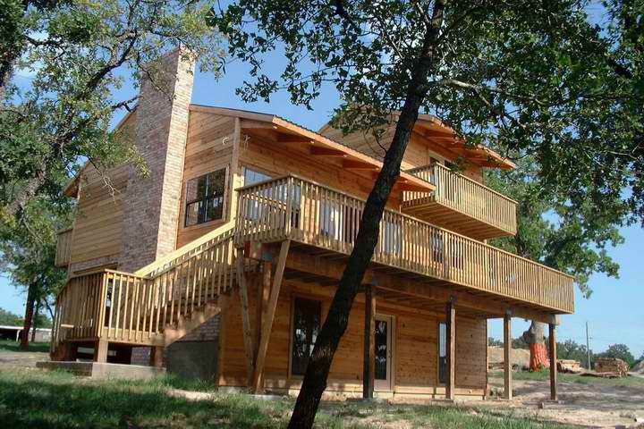

You especially got my attention with those post supports. On my deck, we used 6x6 cedar posts, but the builder just drilled the concrete bases and put 3/4" rebar in there for the posts (see attachment). I don't think they will rust out during my lifetime, but sooner or later with moisture under the posts, they are gonna give out. Like you said, your stainless will be there for a long, long, time. Do you think I should do a retrofit? /forums/images/graemlins/confused.gif

I don't know what your professional was thinking. I'm sure he's done it right.
Not being a trained professional I had to cover my backside. /forums/images/graemlins/grin.gif
I knew the deck would be wet often. I knew the presence of water expedites the deterioration in cedar.
So I designed a plate for the post to set upon that was above any standing water. I used stainless because of it's corrosion resistance.
What was fun was making the blocks to hide the cavity under the posts. They had to cover but they also had to vent. I got lucky and it worked.
In your situation I'd worry more about exposure to water on the end grain than I would the rebar anchor-studs. If your posts are sitting flat on concrete and water can sit there, the cedar will be gone long before the rebar.
I love your place, stone gorgeous as they say around here.

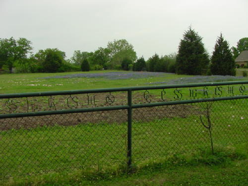

#24
This morning I stopped by to take some pictures of a job we figure we did in 94. I've been wanting to get some good pictures for the new web site. This is the only fence in a fence I know of.

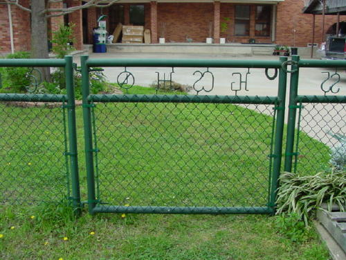

#25
here's one of the walk gates. All the brands we made one at a time and represent either a family brand or a fantasy one from the kid's initials.

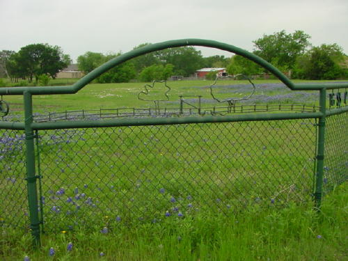

#26
fence with Bluebonnets and Indian paint brush in the background

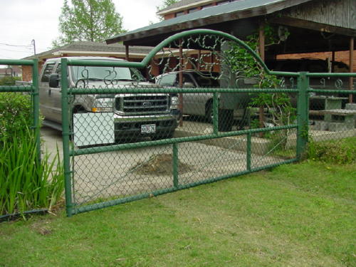

#27
This is a very tight family. I remember when we were talking about the drive gate I left with the impression that a tree would be representative of them from my perspective.

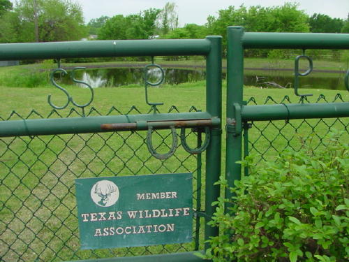

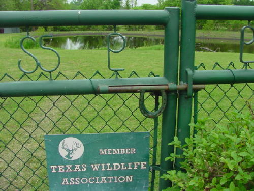

#29
Here's my favorite gate latch. When it's closed you can only see one horseshoe. And when it's open you see two.
Yest the gate has sagged a bit over the last ten years. Time while generous isn't always kind.
