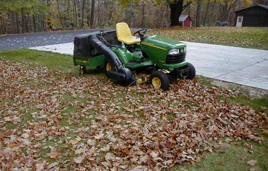

czyal
A few pics of your rig would help understand what you are faced with.. sounds like a good project, if you can get it working good for you before getting loaded down with leaves to pick up. Good luck to you..
I was out yesterday with my MC519 cart and cleaned up a couple acres of lawn.. but this morning after wind and rain.. will have to do it again soon.
If you can rig up a hydraulic dump on your Agri-fab, makes dumping a lot more fun.
