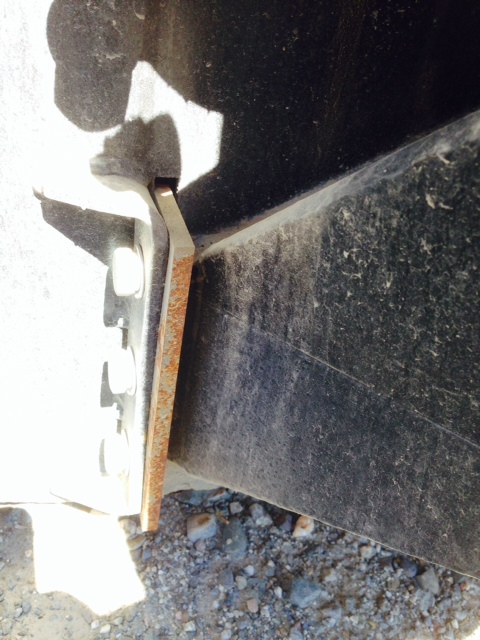

JD,
There is a ledger plate on the WC42G, or an anvil as I call it. Look again, it is adjustable/replaceable. If yours is missing that would be very interesting and may explain why the log jammed.
   / Agriease WC42G Chipper Review Please #32
To follow up on the previous post I am now convinced that this is one of the reasons that I experienced a jamb; I think that the limb rotated (it did have a slight bend in the end) as it met the knife blade and the shoot housing probably flexed somewhat, absorbing some of the energy of the flywheel/knife. Maybe that was a good news/bad news thing. Clearly, more robust sheer opposition would be a desirable thing to have. This really adds to the need for the correct bolt hardness.
   / Agriease WC42G Chipper Review Please #33
Dave,
Sorry, I was typing when you replied. Where is it located, please?
   / Agriease WC42G Chipper Review Please #34
See if this picture works for you. At the left side of where the hopper is attached to the main housing. Lousy photo, but you should get the idea.
   / Agriease WC42G Chipper Review Please #35
So I looked at the exploded view of the chipper and discovered that there is indeed an plate opposing the blades. Is it adjustable? Probably, I didn't try to adjust it. So Dave is correct, it does have one. Dang, these dealers can be annoying at times. I had no way of checking the gap other than using two pieces of 1/8" strap. I inserted them into the space between the blade and the 'fixed' plate. One would pass and two would not. So on my machine the gap is somewhere between .125 and .250". This despells my theory that the shoot housing creates the sheer. I stand corrected. Plus I no longer believe that the gap between the flywheel and the housing creates the size of the chip. It is however, interesting that the size of the chips comes out much larger than this approximate gap size. Anyway, there is too much blood around here to keep typing as I have fallen on my review sword. Ouch!
