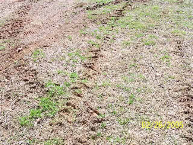

Not sure where to post this so I pick here. On my tractor I've got ags on the rear but it came with turfs. Since we really haven't had much rain in the past 8 months (about when I got my tractor) I haven't seen much in the way of mud. I put on the ags for running through the woods cutting atv trails and deer plots. After a day of soaking rain and moving the tractor around this is what I get.
This was taken around 1:00pm yesterday, no rain for about 12 hours. The ags did do some marking. I did have my Woods 5' FM on the rear. But we're on decent hill and the place usually drys pretty quick. The Suburban tire marks on the left were made on Saturday when it was still lightly raining. The other marks are from one of my atv's with ITP Mud lites on it, they tear up anything. So looking at the Suburban marks I'd say in my case the turfs would not have left much of a mark even with the FM, they are wider than the 11.2" ags. The R4's would have done better but I hear folks say they just don't bit like an ag if you are plowing or such.
so even though I like the look of the ags better, the turfs will go back on for the summer. Hopefully they will be needed(we get more rain this year).

If you mostly mow, use turfs or R4's. If your in the woods use Ag's or R4's. As for your grass, from my knowledge and the picture you have shown and the comments about the picture, the ground is mostly torn up where there is no grass or very little, which, is to me says there are no roots to hold the ground together. If you notice (and this is just me) that where there is grass, it is not torn up near as much. You can even see the truck tire tracks which you probably never would if there were a good sod. Correct me if I'm out of line. I speak from my own experience with turf or lack there of it.

dang pictures can "lie", but I see little turf .. just some grass.
grass does not equal turf ... turf (with an established root system) is MUCH more than some grass sitting on the surface ... looks to me like you've got maybe 1" below the surface with the ags ... that's NOTHING. In fact I call that "aeration" /forums/images/graemlins/smile.gif

Yall are correct as to the little amount of grass, lack of rain will do that. It is (was) common bermuda, but the turf tires wouldn't leave any marks to speak of. Here is a pick in wetter times, same place pulling into the left bay, 2 years ago when I built my garage.
I think my yard died and came back 3 times last year. We only water the flowers when we are gone. /forums/images/graemlins/frown.gif

<font color="blue"> After a day of soaking rain and moving the tractor around this is what I get. </font>
Thats what they are suppose to do. /forums/images/graemlins/grin.gif

In the first photo, it seems you may have a fungus problem from the fairy rings I see. Do you get mushrooms after a heavy rain? We have that problem here in Florida. It could explain the poor turf growth.
As for the tire marks, you didn't say if you were in 4WD, but 2WD will mark the grass a whole lot less than 4WD.

Yep that's the tree. It can put some serious hurt on you and a tire. My 2500 is just a 2wd. Guess I'd seen this sooner if we got rain before. Either way the turfs will go back on as soon as the grass starts growning again.
