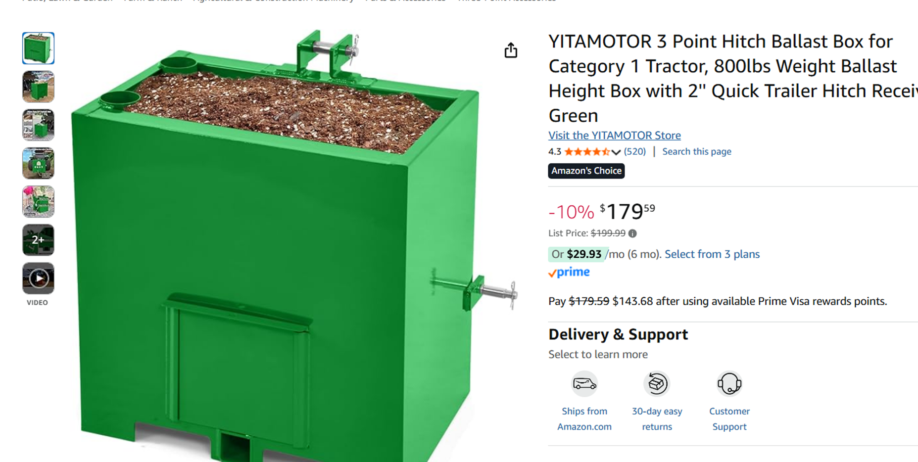

I know you could make something cheaper. But you'd probably have half of this in it by the time you buy concrete, hardware, etc. Wouldn't you? This is a pretty easy way to add ballast and they'll deliver it to your door -- free. I filled mine with gravel and then hung some brake rotors on rods inserted into the vertical holes. Haven't weighed it but it did the trick. (This is just an example -- there are dozens of options online from different vendors.)
Yeah, but that's just the box. You still have to fill it with something. I have a frame that I built and mounted to my 3pt. Its a big rectangle with a vertical 2.5" sq tube (2" receiver) welded to it along with a couple of receivers on the bottom. I have forks that mount to it. My long term plan is to run a piece of 2" sq tube through the center of a barrel and have it stick out about 10" on the flat sized of the barrel. The plan is to leave the barrel flat on the ground so that (push come to shove) it can be rolled around. I'll pick it up with the forks when I want the weight. I'll weld some tabs to the sq tube to capture the forks, and then run a bolt through them to clamp it to the forks so it doesn't want to move around as much. In theory, that would let me put it further out on the forks as well, taking even more weight off the front axle. I'm not convinced the clamps will hold it out there, but I'm also not apposed to drilling a hole through each fork and pinning the weight in place.
