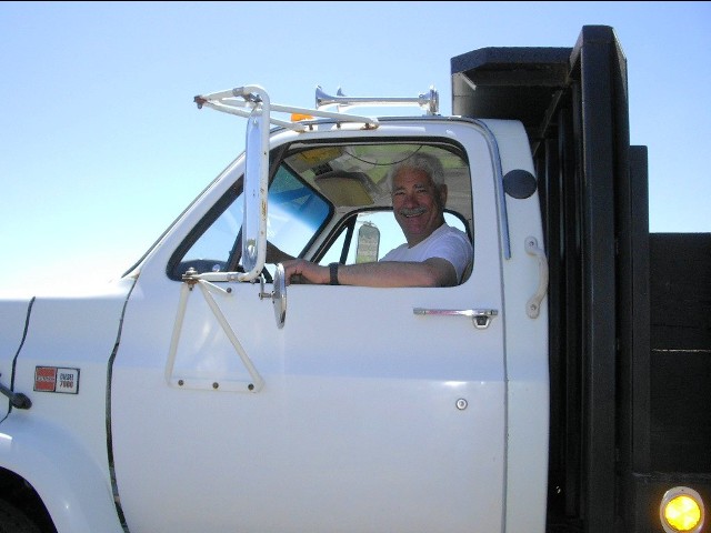

When I got my GMC Dump truck last month my wife was sitting in the drivers seat and asked me what that wire was hanging down along the window....... so I told her to just pull it out. Well, the engine was off and the air tanks full. I cannot describe her reaction when the air hit them double trumpets! /forums/images/graemlins/shocked.gif /forums/images/graemlins/shocked.gif /forums/images/graemlins/grin.gif Franks and beans ain't so bad.
