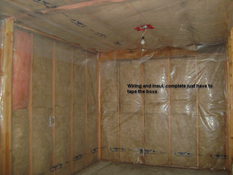

Bob112 don't know if this helps answer your question but my shop has metal ,1x4 strapping, fiberglass insul, 6 mil poly then drywall last year after 23 years I took the end out of the building to add on and everything was a dry and sound as the day it was built. With R40 in the ceiling during the summer even when over 100 F the temp. inside is 69 to 74 degrees and I assume the 1" space between the insultion and the metal shting has something to do with this.

Bill, I am unclear, you installed a membrane between the metal sheeting and the insulation? Or no? What was it?

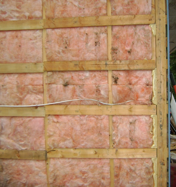

Bob112 I have no membrane between the metal and fiberglass just a 3/4" space the strapping provides. When I sheet with board and batt over the strapping I first put tar paper but still maintain the space to the insulation. Over the years I've remodeled or renovated building during winter where the insulation was a solid block of ice. In every case this was a malfunction of the interior vapor barrier having rips or tears or just missing. I think a layer of foam under the metal would be a good plus.
This is what the insulation looked like under the metal after 23 years.
