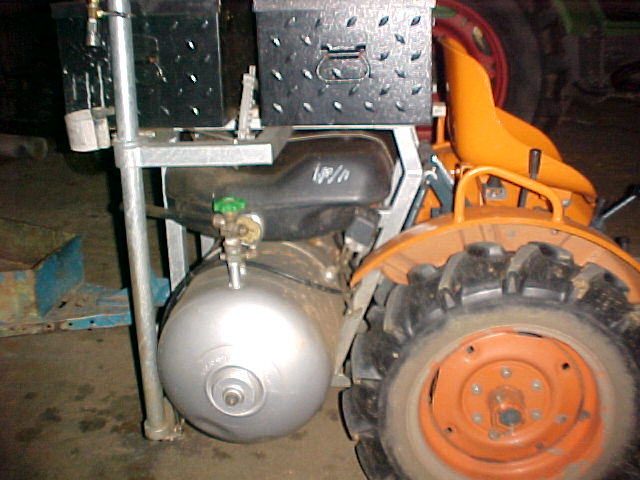

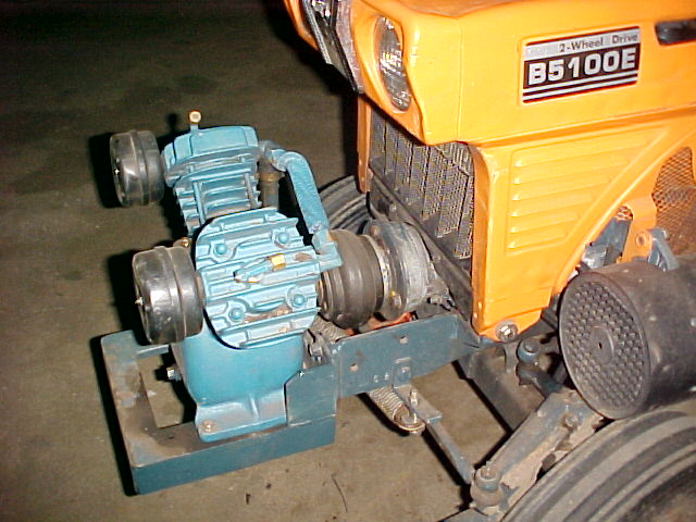

What kind of magnetic clutch is that?
I was just thinking I'd get a PTO clutch off the bottom of a lawn mower, but yours looks different.
It's a Warner Electric No. 5215-57.
Didn't come with a pulley, just a flange with 4 1/4UNF theaded holes.
I was told when I bought it that given the "jumpy" rotation of a i/c engine I should fit a Tyre coupling. I just fitted a chain coupling I had lying around.
The rivets at each end of the three "springy" flats that transmit the drive when engaged began to break, so finally fitted a tyre coupling but only after the clutch. (this was midway through the first season)
This season had a bit more trouble including one springy flat breaking by the rivet. Have now fitted thicker and wider spring flats (blades from a DeWalt recipro saw) and bigger (5/16) rivets.
Survived the last 2/3rds of this season OK.
In reply to the guy who questioned volts/amps/watts my understanding is that for the same watts you need heavier wiring, contacts etc when those watts are coming in 12V and obviously higher amps than when it is 240volt and low amps.

Allenr, that's quite a setup of you've got there. I've got a back-burner project I've been thinking about for while and you've given me an idea of how to solve one of the problems. But, if I could ask:
1. At what RPM speed does the compressor rotate?
2. I don't see a fan or the original flywheel which probably has a fan, so do you have issues with it over heating? By mounting it front of the engine near the radiator fan does that help with cooling?
3. What type of pruning tools do you use that use compressed air as the power source?

Thanks SR.
1. I run the engine at idle, it doesn't have a tachometer but I'd guess it to be 7 - 800rpm like larger tractors. Might rev it up a bit for initial pump up in the morning.
2. Yes the original pulley had a fan built in. Presumably the engine fan creates a little bit of air movement. Mostly rely on the fact that it is running at much less than the 1500 max rpm and probably only turning 50% of the time. It doesn't get hot.
3. It generally runs 2 or 3 Ofma & Felco pneumatic secateurs which have a cylinder that fits in one hand.
