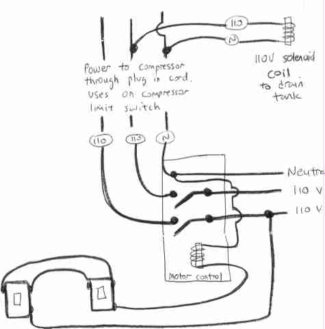

I put my compressor in a remote location to keep the noise of the compressor away from where I'm working. I used the heavier sweated copper (Type L) and it has worked out well. It is easier to put in than cutting and threading pipe. Some will say to use PVC (and it's pros and cons have been debated here before), I think is unsafe as it has a higher chance of failure from fatigue and trauma, especially when cold and under pressure.
I put a "normally open" solenoid (energized with a 120v coil) at the bottom of the tank so that the tank drains whenever the AC is cut to the plug, and closes the solenoid whenever the plug is energized. I also wired in two remote three way switches to control a motor control relay (sized for my compressor). The coil on the motor control relay is run by a 120v AC. This allows me to turn the compressor on from the two remote 3-way switch locations, and when I turn it off it drains the tank through the solenoid.
There is a crude wiring diagram attached.
