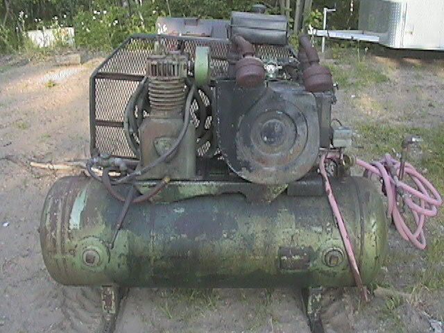

I found this on craigslist 120 gal tank, 200psi, 16HP $300
Bores are 5.5" and 2.25", stroke 3.5".
