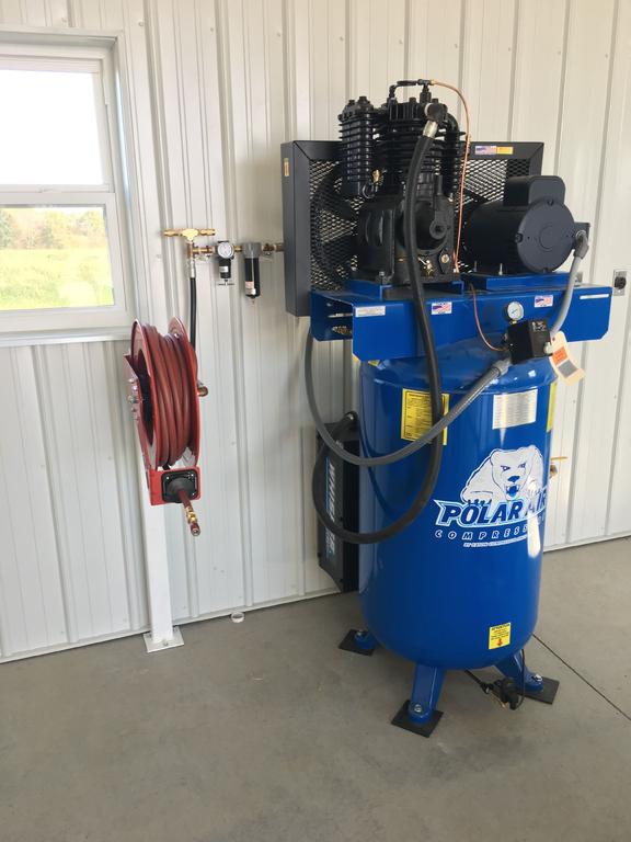

Here it is when I got it hooked up. That was in late October. The shop has filled up considerably since this picture was taken. I went with the blue because it is similar to the color on our lift. Plus, my wife said she didn't want to see any more John Deere green... It is a very heavily built unit. Both the intercooler and after cooler are cast iron. Others I looked at only had an after cooler, and they were just fins on copper line. The pulley is built with blades that move a lot of air across the whole unit to cool the air going into the tank. Having an auto drain is nice, as well. I'm not sure what I did wrong to make the picture show up so small.
That's a nice clean install. I like it!
