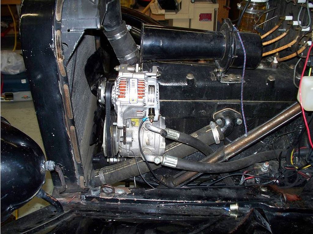

Those Red Dot a/c units draw a lot of current. So would any application where you had to run a condenser fan as well as a blower fan. Usually in the 30-40A range. A little lawnmower battery won't handle that for very long. You'd need an alternator and larger battery.
The newer auto a/c compressors don't draw much hp--About 1-2hp at most. The little Sanden SD508 is pretty compact too. I know of a guy that installed a/c in an antique Model T car and they only have a 20hp engine. He says he can't tell it's running but the Model T has lots of torque too.
Found a picture of his install.

A model T with air co. Now I've seen it all.
