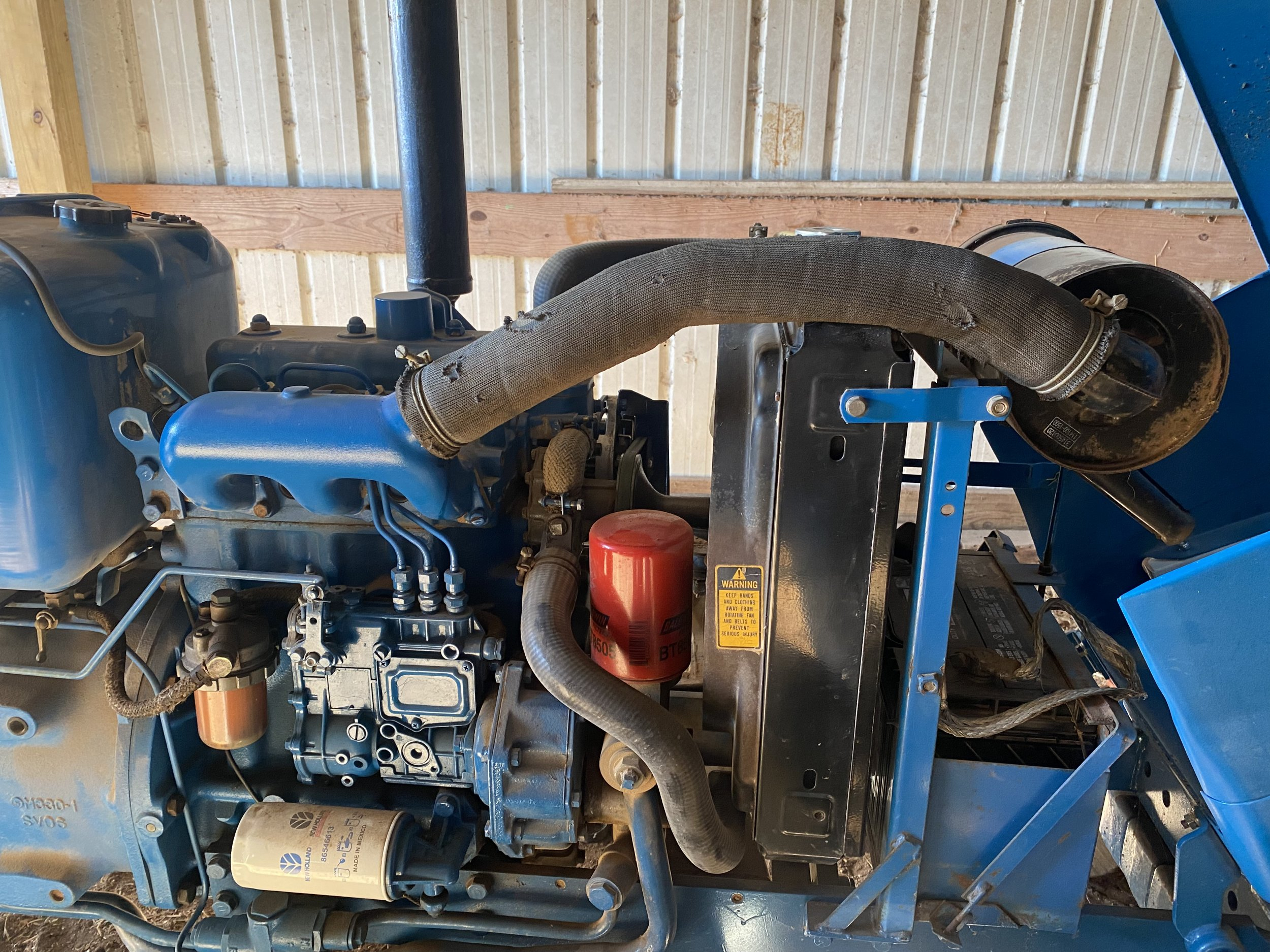

I need help finding a comparable air hose I’ve gone to the parts store and they could not find a hose that would work the normal hose they had would not work because it needs a spring inside to keep it from closing up its 3 inch diameter

I'm not clear on what your looking for or the problem your trying to correct. Are you looking to replace or extend the hose connecting the air filter with the intake manifold? What is wrong with current hose connecting the air filter to intake manifold?

It’s dry rotted just need an exact replacement

It seems pretty clear to me. The Op needs to replace the hose from his air cleaner to intake manifold, and the one at the parts store would collapse from the vacuum to which the hose is subjected. If the hose is heavy enough, it probably doesn't need a spring. I am not sure what stores they have in Middle Tennessee, but around here they have a chain called "House of Hose" that specializes primarily in hydraulic hoses, but has a full range of hoses of all sizes, up to several inches in diameter. I'd also check online. It isn't surprising that a local run of the mill parts store would have nothing to help.
/ Air hose #6
If it is leaking, you could probably duct tape it as a temporary repair while you find a replacement hose.

I don't know if the contributors can help with this one, however I would buy the hose with the "spring" inside and try it. Cut the spring back at both end so you get good seal at connections points. Alternatively, you can remove the entire spring and see if the hose collapses in use. The reason the spring is inside the hose is to provide support to the hose while while is sees heat of 210-300'F since these hoses, with the spring inside, are typically used to carry hot water from engine to the radiator. When unsupported hose, depending on construction, sees these higher temps they lose their rigidity and collpase under suction, since your application is air temp, you may not see hose wall collapse.

Since it's an air hose, all you need to ensure is that it's air tight. I would look for a rubber hose that can make the bends and replace the straight sections with metal pipe. Hose clamps will make it air tight. Depending on the size of the hose, you might be able to find something in the HVAC department of a store, or online.
I added a very large air filter to my dump truck that's located in front of the tire, just behind the head light. To get there, I used flexible metal dryer ducting.

It’s an air hose from the filter box to the manifold
/ Air hose #11
Any heavy truck repair or dealership that has a parts department will have what you need.. You need a heavy wall intake hose for a big truck. Most of them are now red silicone rubber and are very stiff and it's sold by the foot.

Sounds good thanks for the help
/ Air hose #13
Also check out ONLINE auto parts places like Summit Racing or JEGS as the use a lot of these types of silicone hose for supercharges and cold air intakes on competition engines.... Also consider maybe a section of PVC or Aluminum tube to span distance and just two short section of hose as connectors...

According to his heading, it's a Ford 1910. And with the picture he posted, I would agree. He could possibly get a wire reinforces flexible radiator hose. Possibly at a large truck shop.
