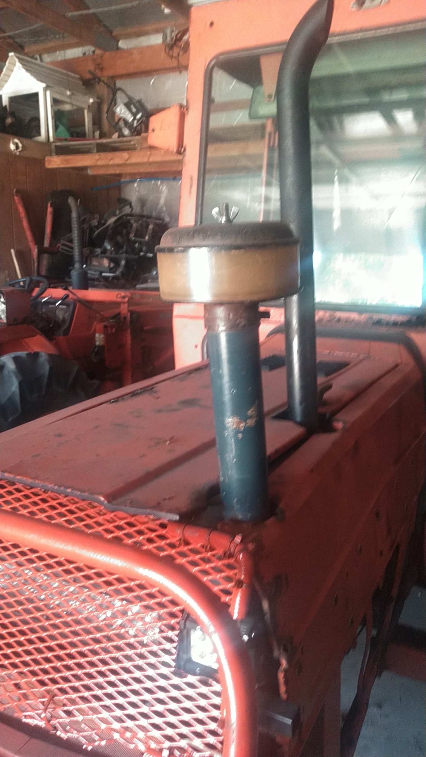

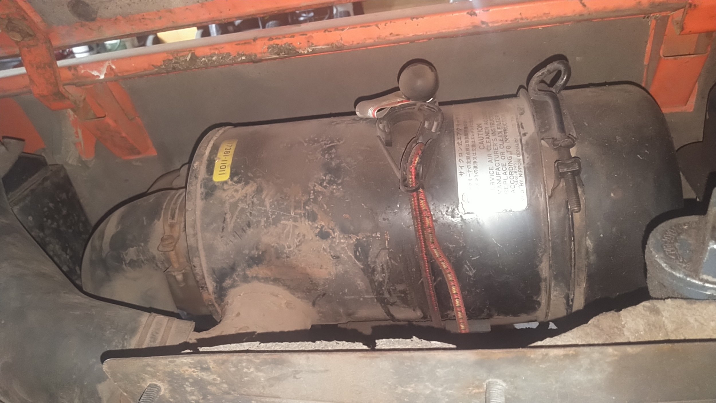

Recently changed all fluids and filters on this l4150 wondering what this intake snorkel is for and if I should bother to fill it with oil? Or aquire a paper element for it? Never had one, did clean it out though it gets pretty fouled up when I'm using it to chip, till, or hog with it. has the main inner and outer filters in the canister.

Never seen a later model Kubota with anything but a dry paper element air filter, you don't want to 'oil' anything in there, just renew the paper filters. That tractor is filthy, time for a bath.

Looks to be a Donaldson can. I'd inquire with them about the filters if the item numbers aren't on the filters themselves. Keep in mind, a failing filter will destroy any engine quickly.

Still has the main Kubota filtration system near the intake, the smaller snorkel just feeds the dual filters in the can

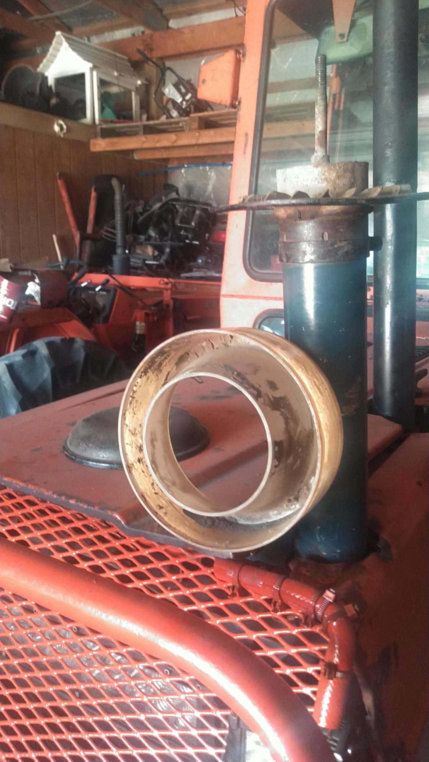

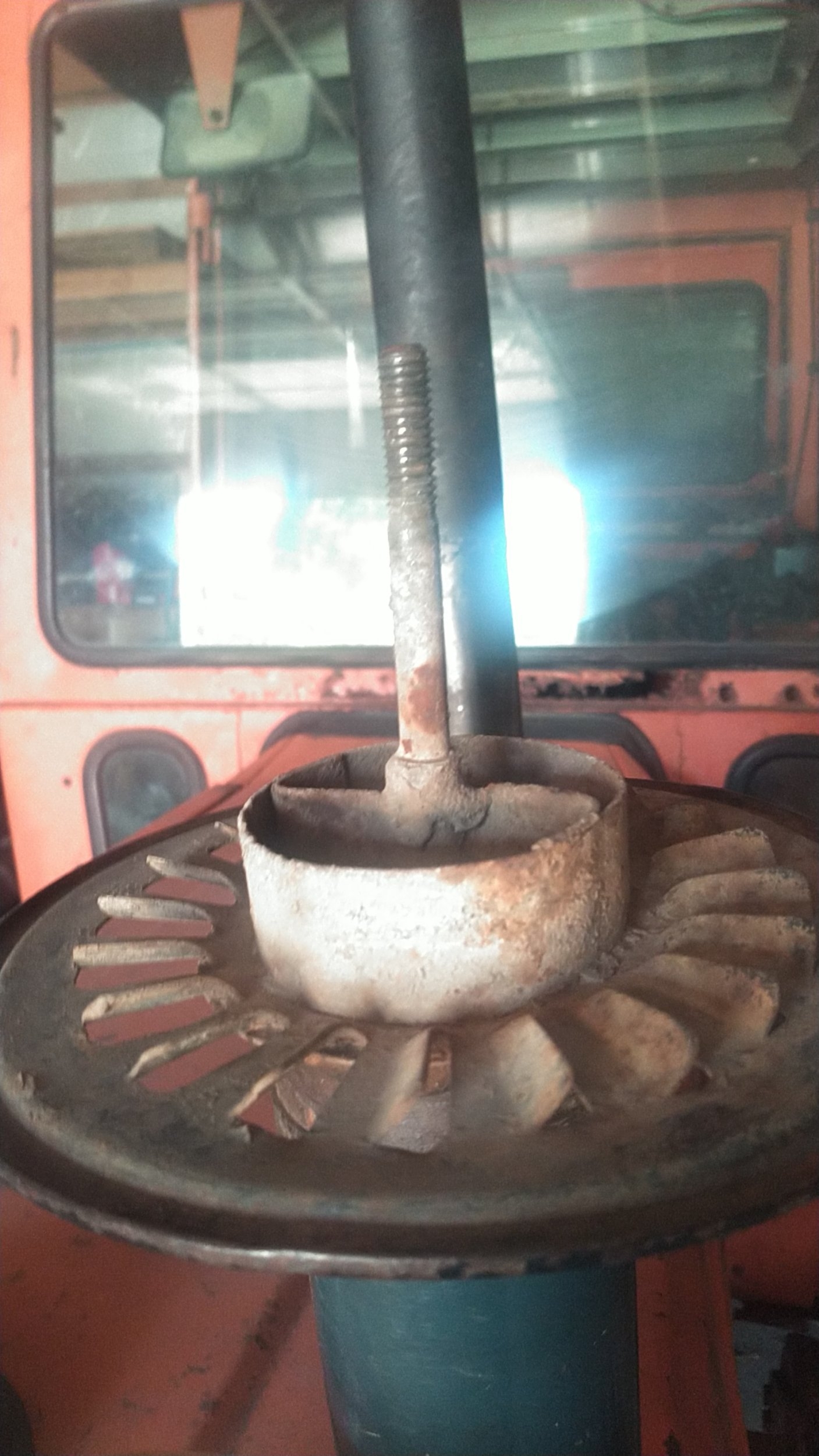

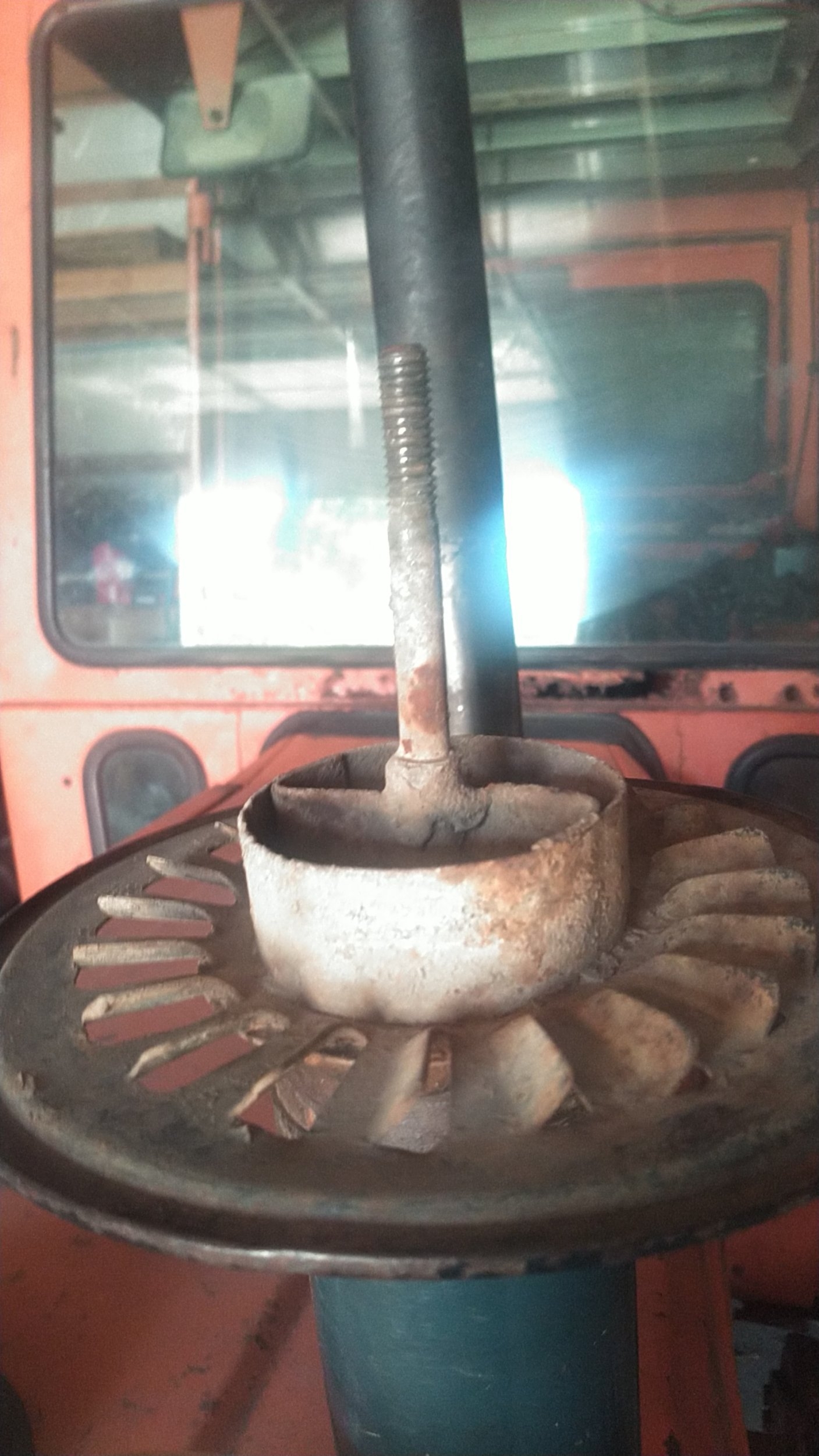

Oh jeez, my technical handicap is highlighted anyways posted new pictures 1st one is the dual filter Kubota air filter can next pictures are of the external intake/ snorkel leading to factory Kubota can.
   / Air intake L4150 #8
The plastic bowl filter just clean it. Its a dry dust collector no oil needed...

Thanks that's what I was figuring, glad I can post stuff like this to more knowledgeable folks on here. To many filters probably starve the tractor for air.
