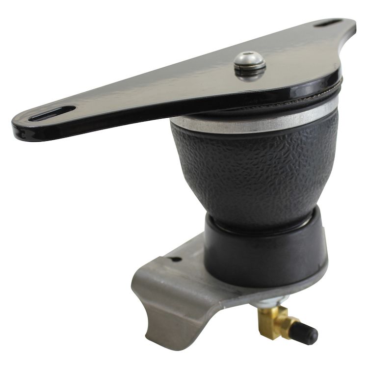

I'm not familiar with air ride seats, in fact I've just had my first mechanical suspension seat with my new tractor and it's like 1000% better than my old one, that was a Kubota B7000.
Anyway, I was just brainstorming a bit and come up with an idea. What if we could add an airbag to a mechanical suspension seat and make it a low cost air ride seat?
I've just found these:
Sold by Revzilla for bikes
I shouldn't be too hard to add either 1 or 2 of these and make a good air ride seat. Or maybe someone knows a better source for airbags of this size.

I think I remember seeing something like that in McMaster Carr.
   / air ride seat? #19
You are right. They have another types and bigger ones also. I would imagine this would need a shock absorber.
