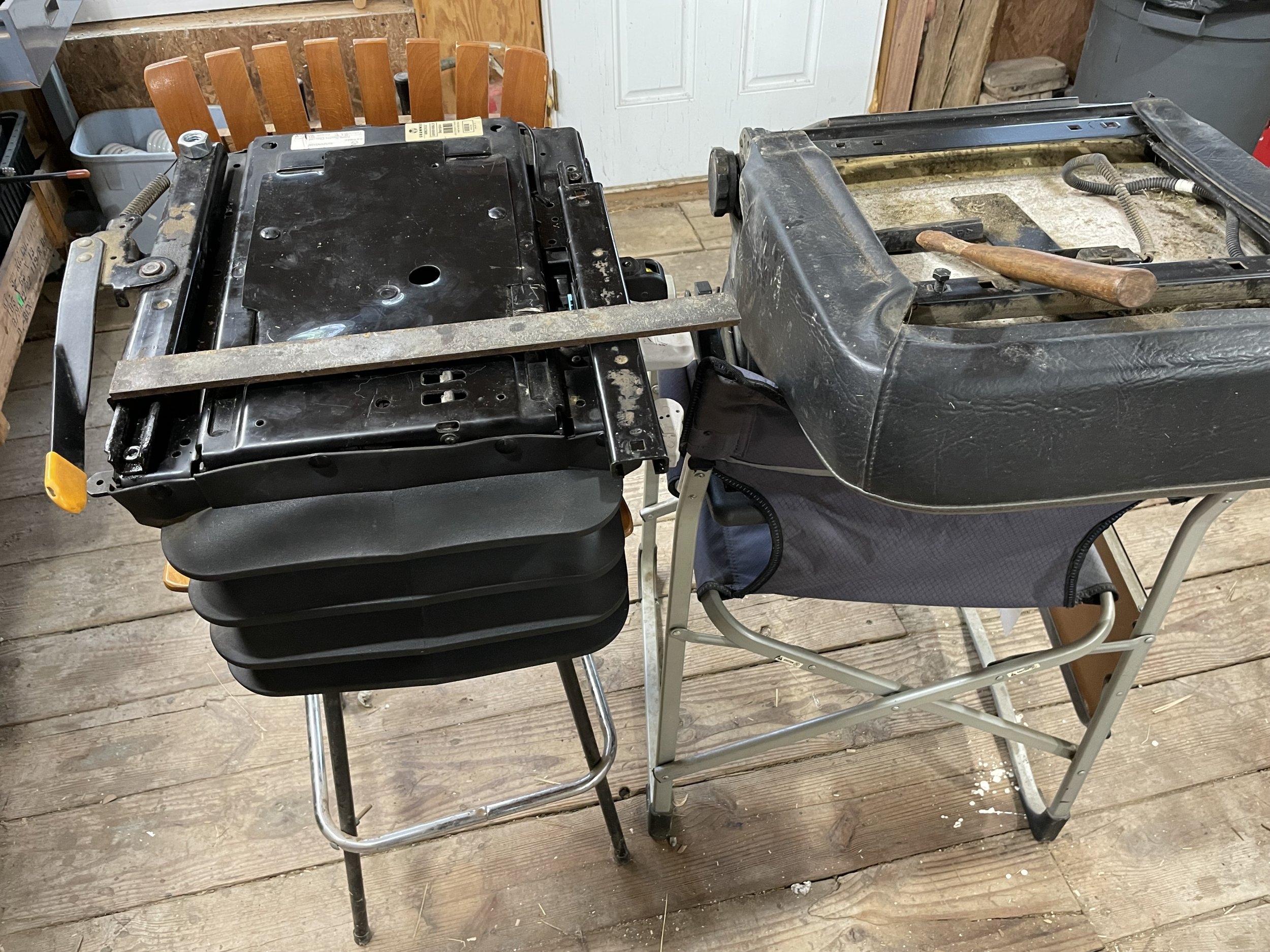

I recently added a Grammer MSG75 Low Profile air suspension seat to my ZD326 zero turn mower. I did a blog and added some photos showing the process.
Quest for a better Zero Turn Kubota ZD326-6P Modifications Divergent Stuff
Bottom line is that it's giving me a lot smoother ride on rough ground. Previously I'd describe the ride on rough hard pack as sitting on a jack hammer. Now its more like a pogo stick. It doubled my seat suspension travel height and eliminated the jarring on my back and bobble head. So far I give it an 8/10. I wish I did this 8 years ago when I bough the machine.
Let me know your questions and comments!

Did you just add an air suspension base under the existing OEM seat or whole new seat? :confused3:
   / Air Suspension Seat Mod for Kubota ZD326 Zero Turn #4
It’s the original Kubota seat mounted to a new Grammer MSG75 low profile base. The Grammer base comes as a single self contained unit.

It was not an easy install. I used the full size Grammar seat base from the tractor. Figured I need it more on the Zero than the big tractor. It has lots of stroke and can soak up big bumps pretty easily. Usually set the ride height to lowest level that does not bottom out on worst bumps
