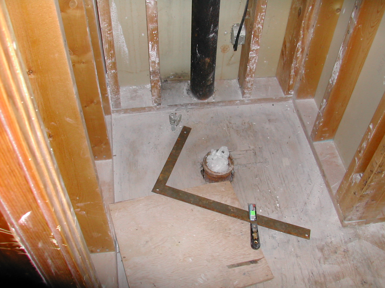

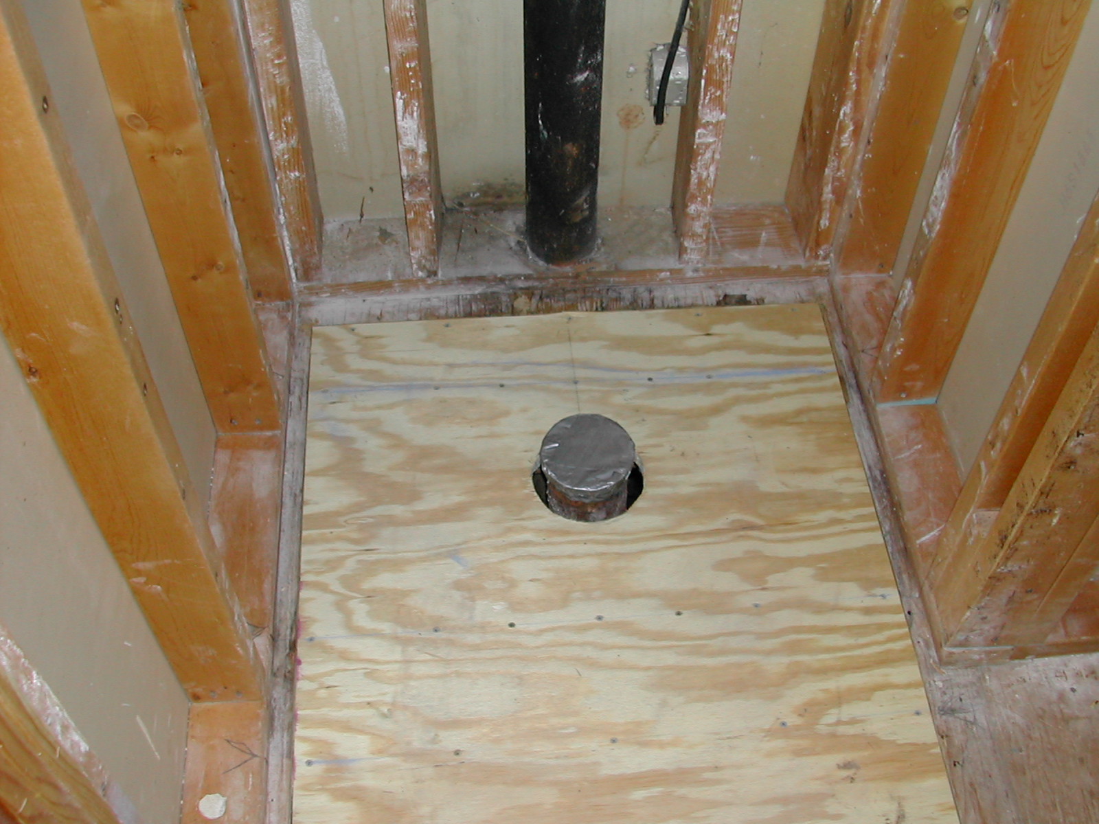

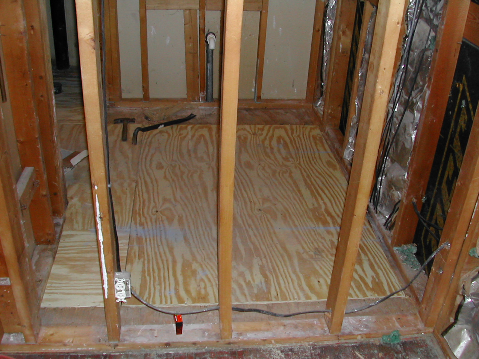

So, today's project was to get the rotten subfloor out, and the new subfloor in, in the bathroom.
Side projects involved, cutting off another water line and capping it, getting the dump trailer unstuck when the wife backed it into the "gooze".

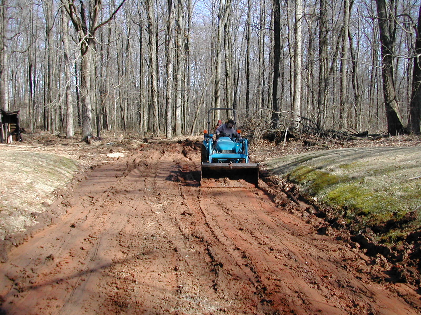

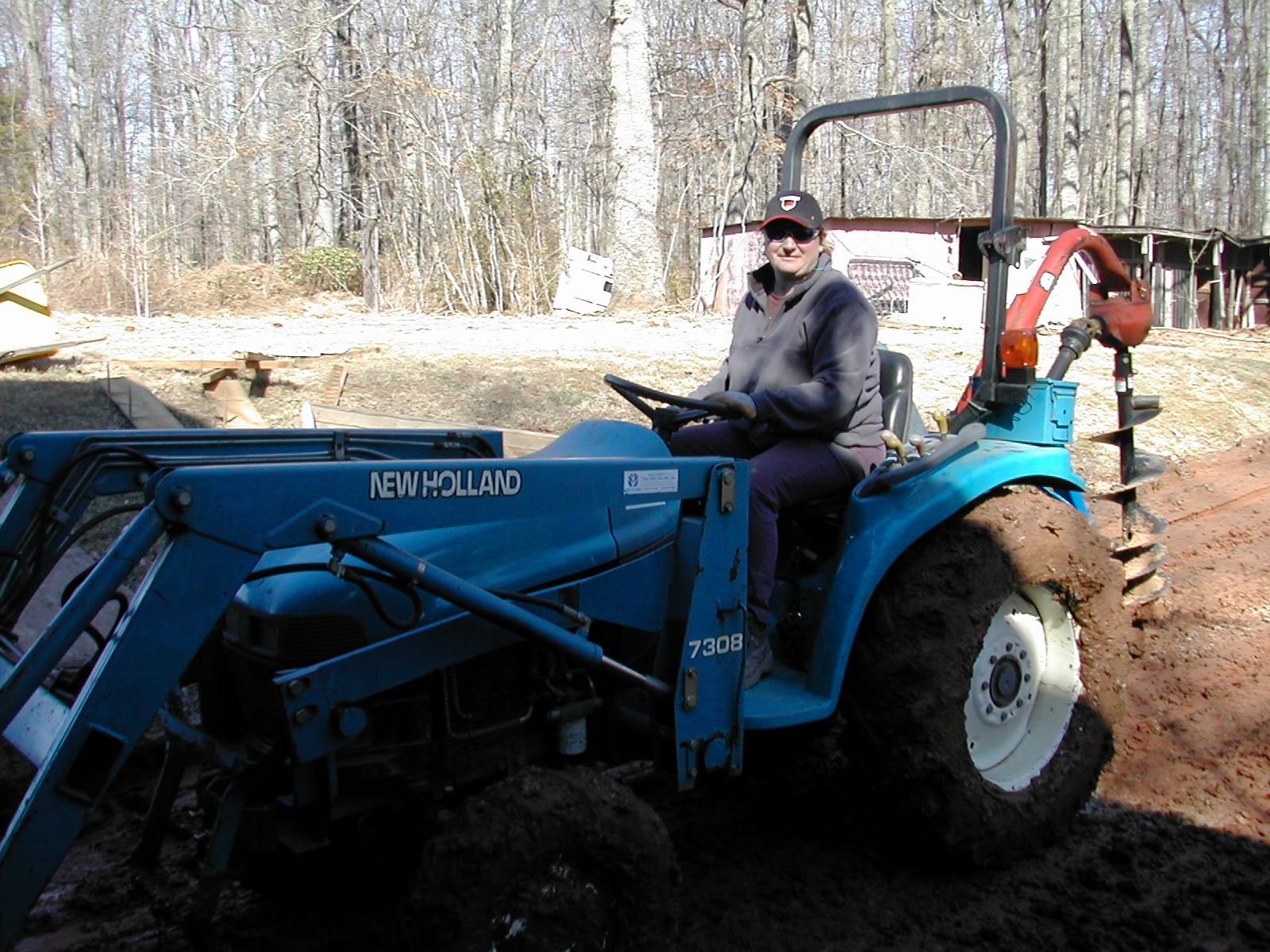

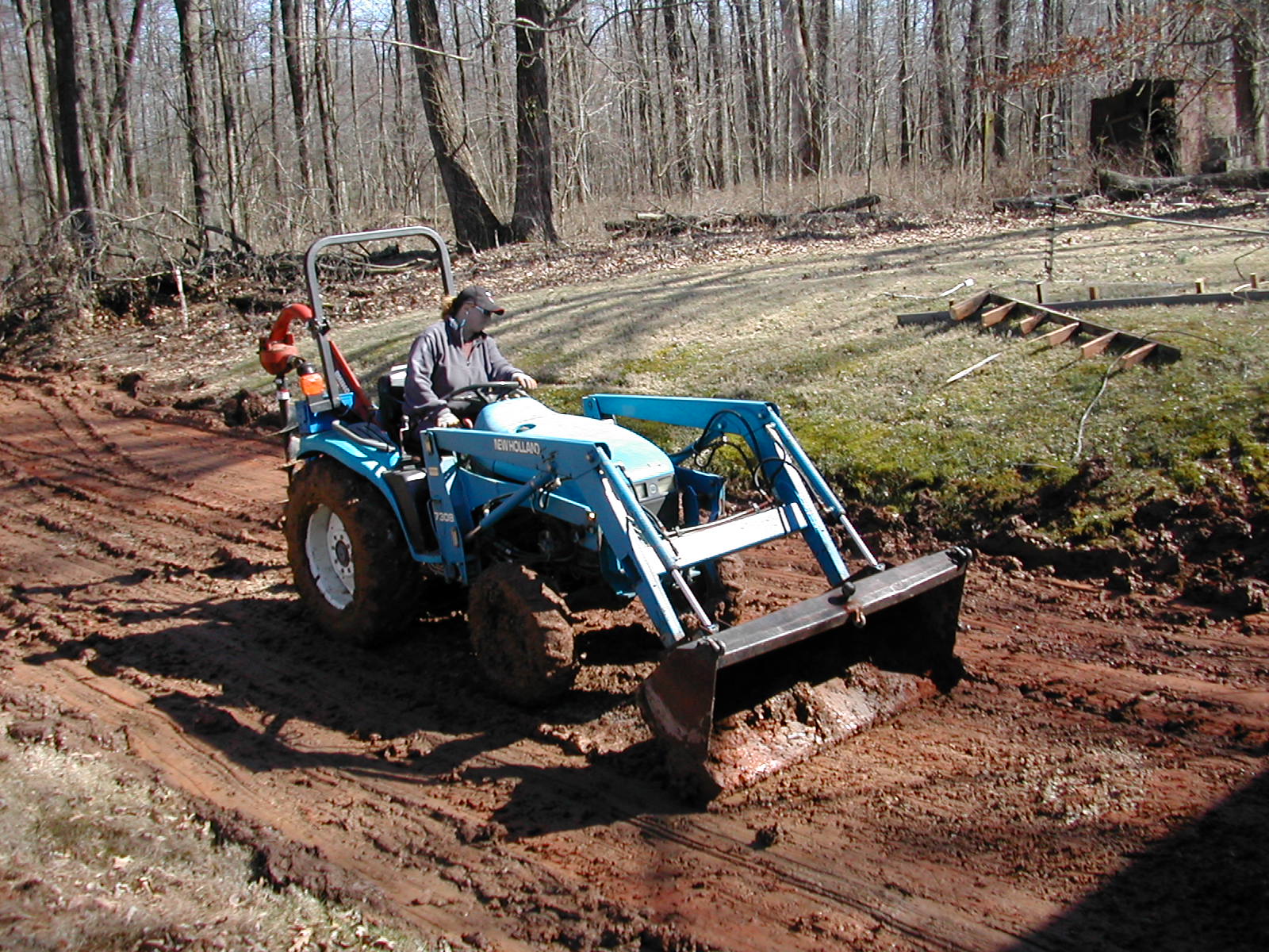

So that is the DW operating HER tractor, you can tell it is hers because it is running at the moment. Now let that thing break and it will instantly become MY tractor :)

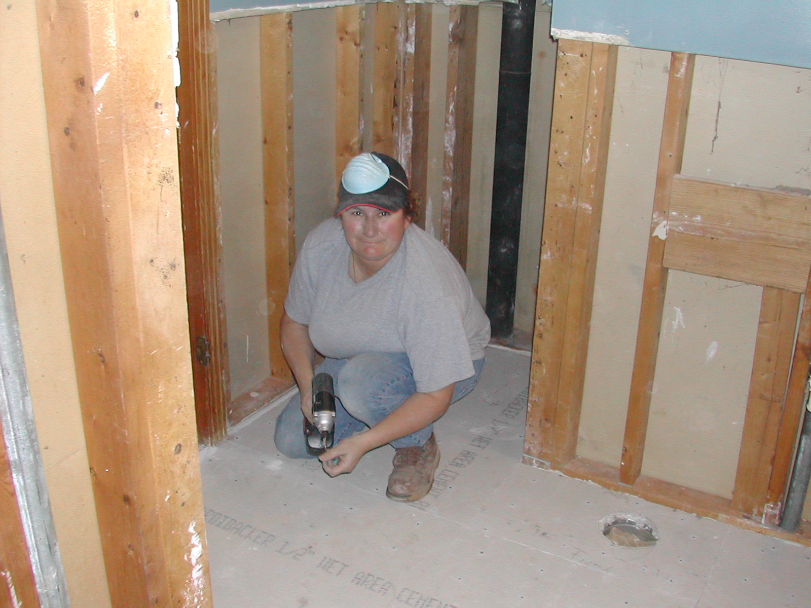

Pictures of bathroom floor a bit of before and after, and some of Hanna doing the Tractor work.
Next post will be the tractor work.

Hanna on the tractor pics.

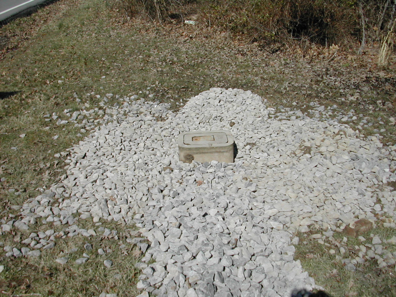

We filled in a big sunken spot in the drive with some 2/3 and then top dressed with crusher run.
I called the water department, and asked about an extension for the water box as I want to run my drive over that, my water meter also sits under water.... So the guy came right out and was very helpful, we lifted the box, and played around with it some, then decided we should go ahead and put a meter riser in, so we dug everything back out, raised the meter a foot I think then repositioned the box down on it. So now my meter is out of the water, and my box is about where I want it, we locked it in place with some 2/3 stone.

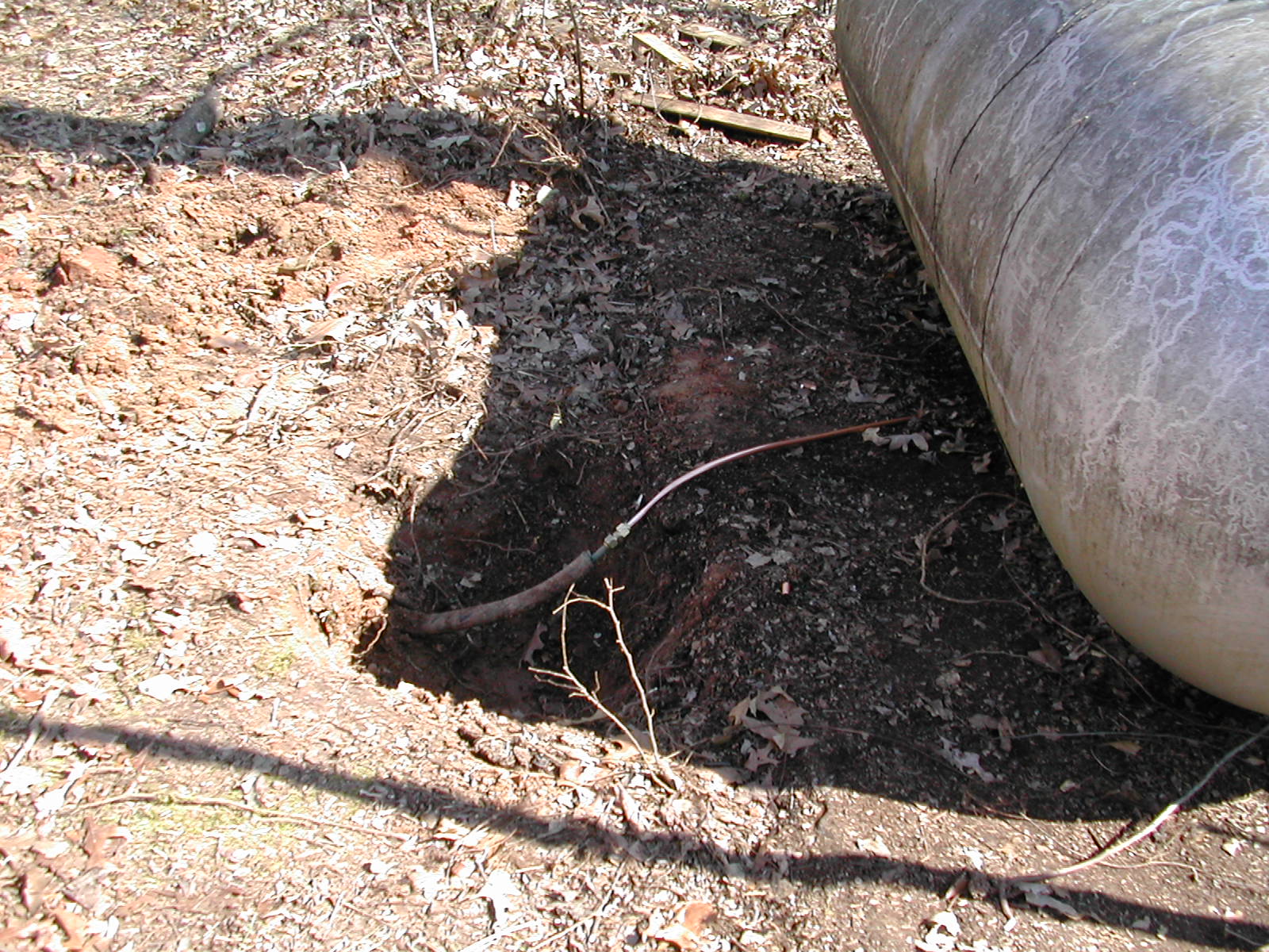

I then wanted to clear the thorns and debris away from my propane tank. The Gas Check folks were coming out today to inspect my system. So I am clearing the stuff away with the tractor, small tree's etc. leaves and such piled up on the side of the tank, being carefull not to hit the tank, I put the bucket down, looked to make sure that the gas line was on the other side of the tank, and as I was pulling back, the gas tank came with me............. :( OH CRAP! Turns out, they ran the gas line down the far side of the tank, then under it, and out across the concrete on the side I was working, so I moved the tank by pulling the gas line............... NOT COOL. The wife was pretty amused though that I had destroyed something, and it does put a special spin on it when I do it with the tractor.
So now I am debating what to do, the gas company is on it's way, my system is broke, I have to pay $100 for this inspection and I have an inop system.. :( Thinking honesty is the best policy I call them, and they are just, oh, no big deal, we are almost there, but they did not have any 1/2" in the truck. I volunteer to go get a roll of 1/2 and they say great, they have everything else. They show up, I have it dug clean etc. I have the tubing, they splice in and do the check. No extra charge and they are happy with everything. So my oooppps cost $17 cash, and provided some good entertainment for the wife to see me squirm.

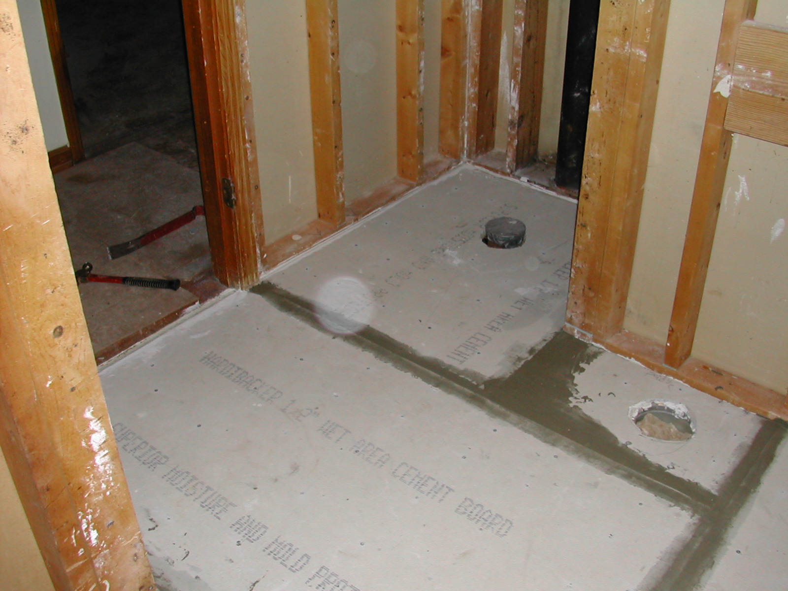

Hanna laid in the Hardy board for the tile and got it all joined and mortared in so they can start tiling in the morning. They also picked the sink unit out and think they found the tub unit she wants.

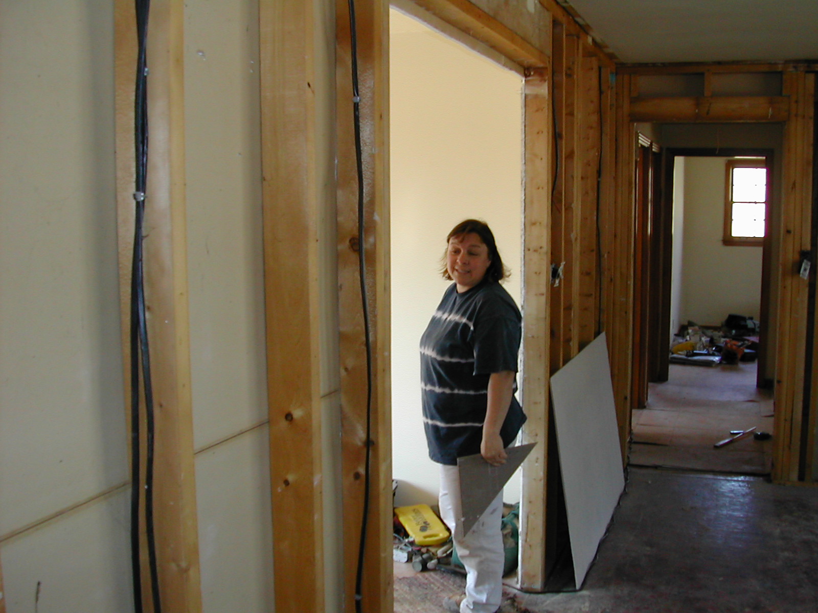

OK, here are some pictures.
This is the big trackhoe I can borrow.

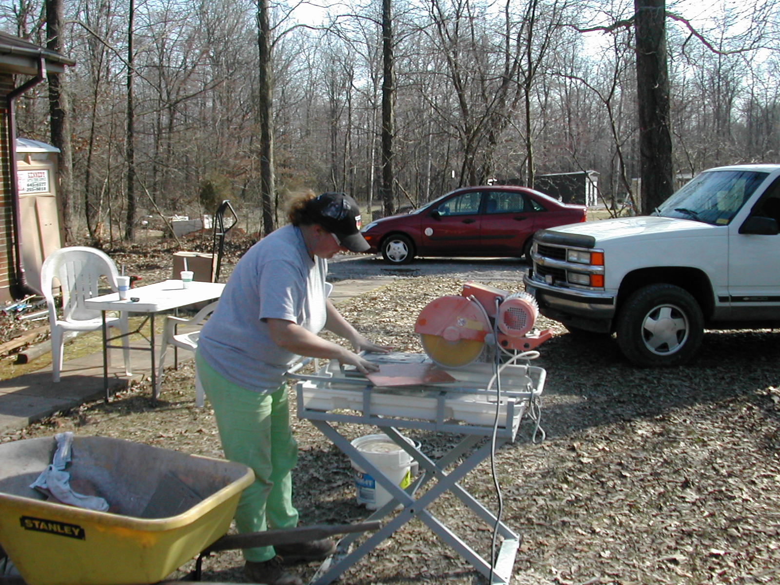

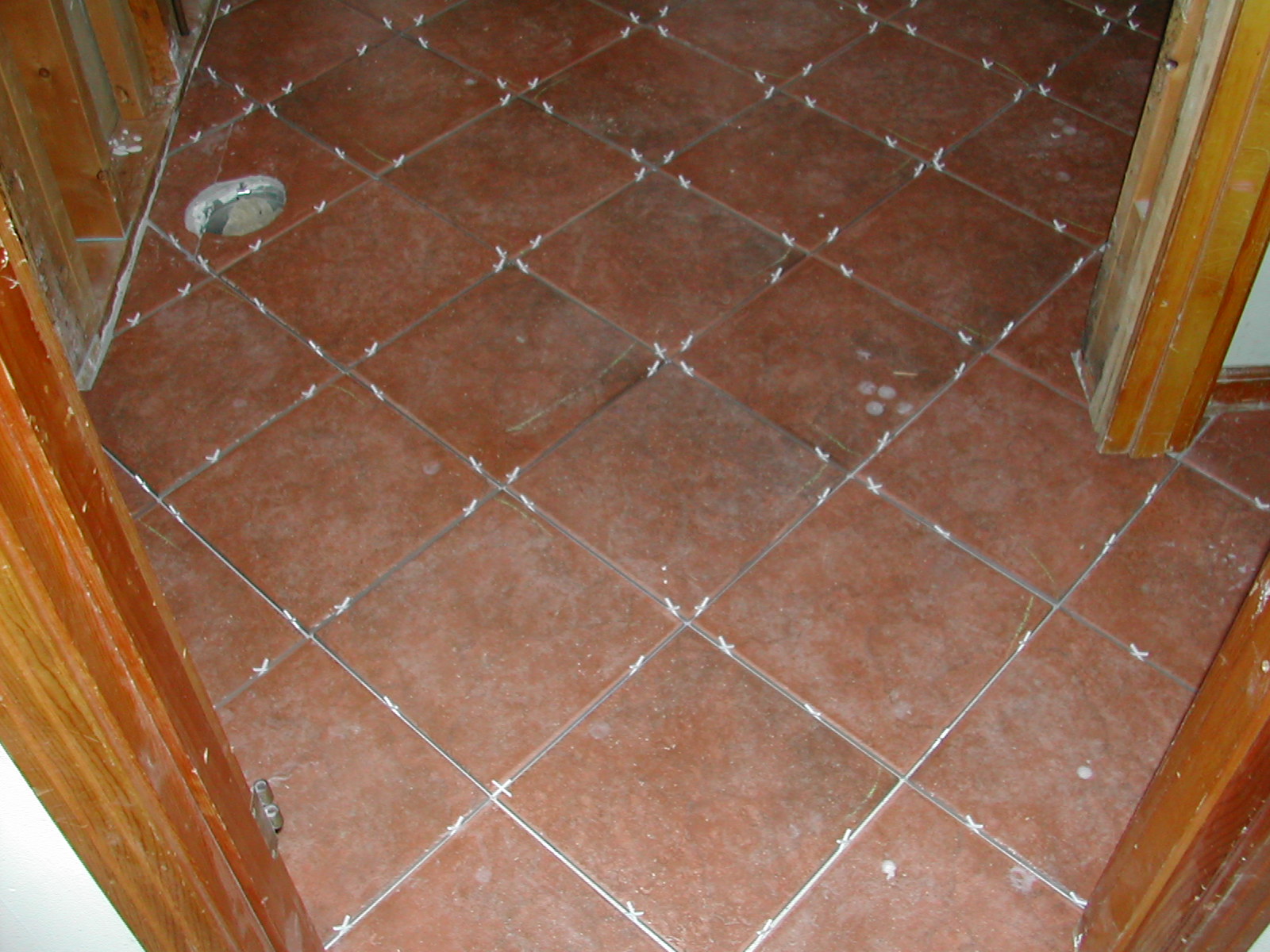

We are laying harde board for the bathroom, then Tiles. Hanna got these at the closeout place for 50 cents each.
She told me yesterday I was putting in new windows. I think I will have her wait on the tile till I replace that window so I am not working over new tile.

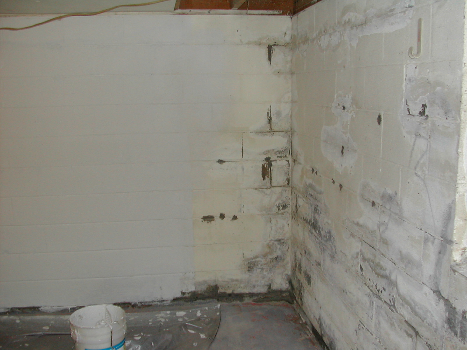

I ground out the crack in the concrete, and filled dry parts with concrete crack sealer from quickcrete. I wire brushed off any remaining mold so I could start going with the UGL drylock. UGL drylock can go over damp, not wet areas, matter of fact in the summer when applied to new block, they will wet the block to slow down the block sucking in too much.
