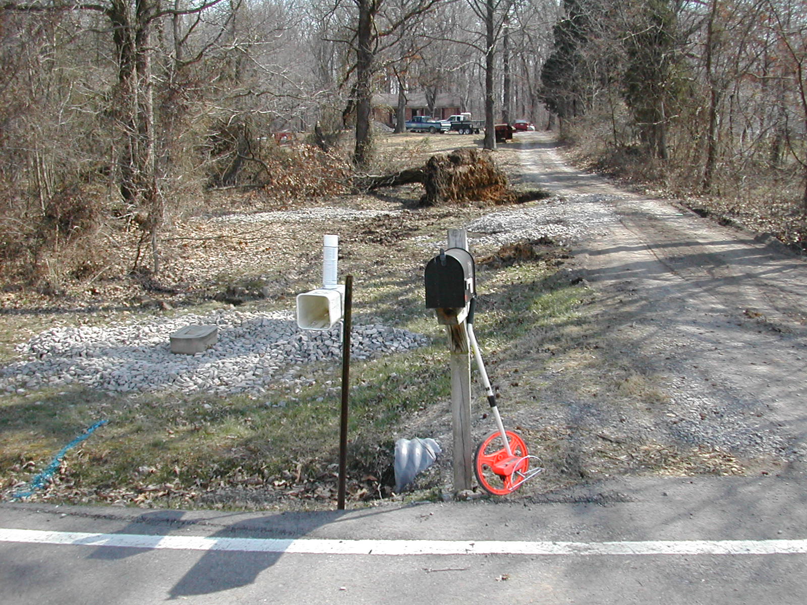

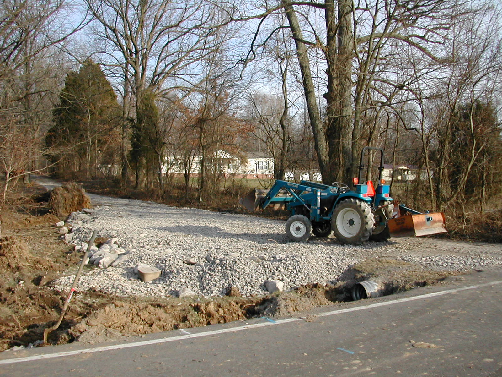

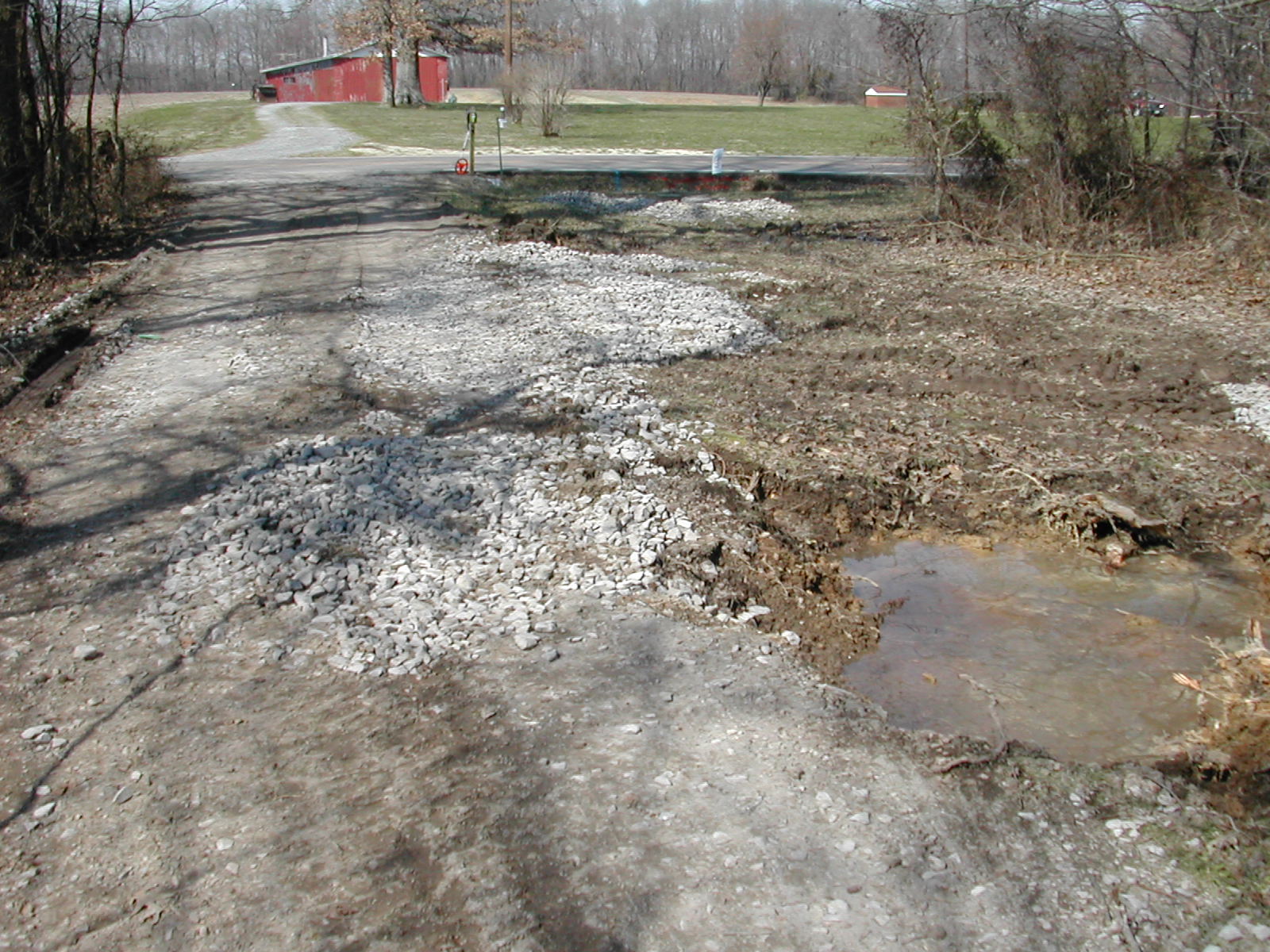

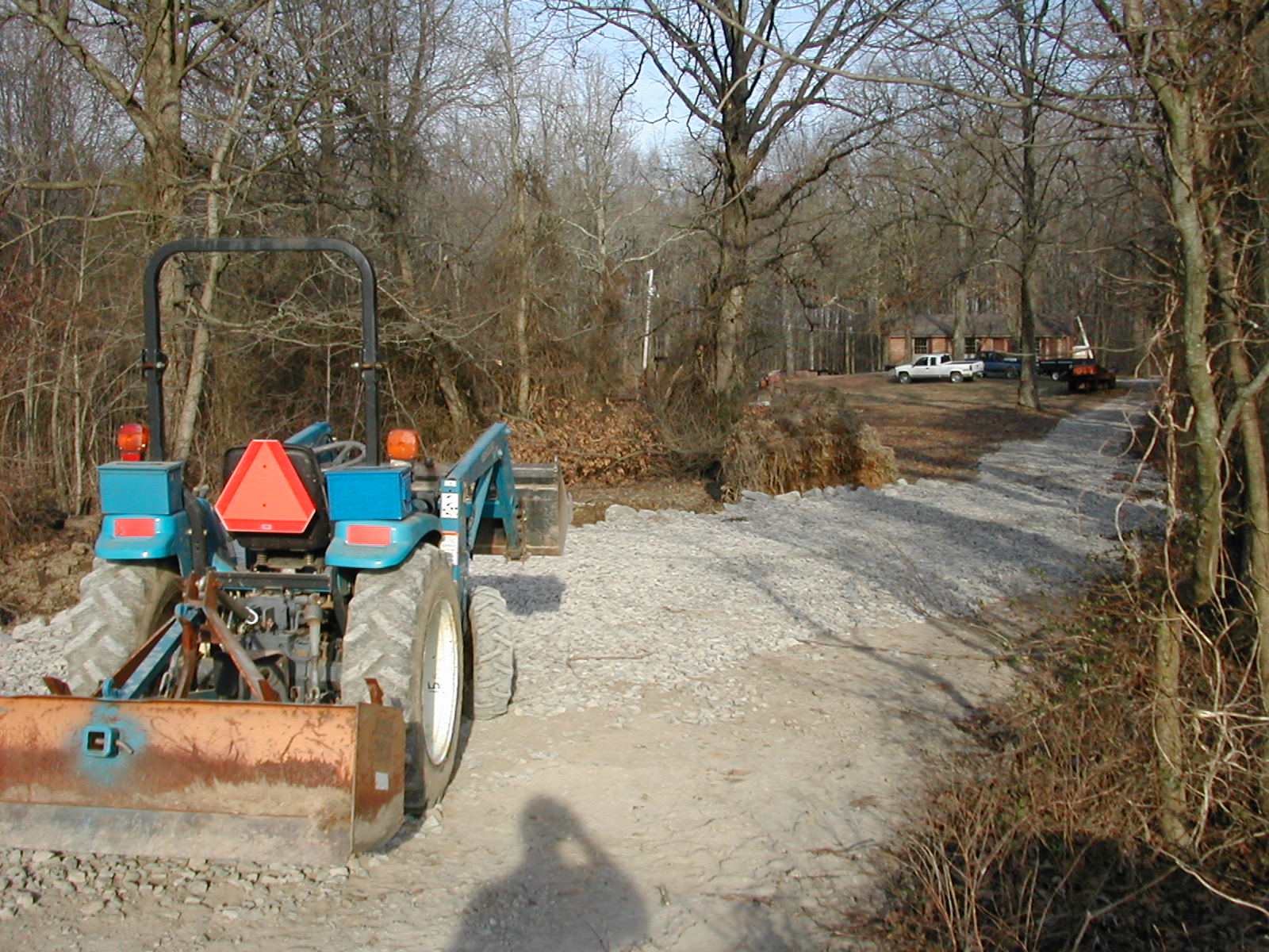

So yesterdays project was to get the driveway wider coming off the road.
This has to happen to get the mulch delivery trucks in off the road. Hanna needs to start working again, and this is a key part of our business at this time of year.
So, you start by using a poor man's backhoe, and digging where I want the culvert.
And you move the mail box and paper box.
And your wife comes out to help, and decides she want's to go ahead and dig the pond out front "NOW" to get the drainage out front better. So we go around about this for a bit, in a good way, and we are on the cusp of buying a backhoe, I figured Eddie would give me 12, $1000 payments, but he wants cash, so we are going to rethink a bit. So we get back to expanding a driveway.

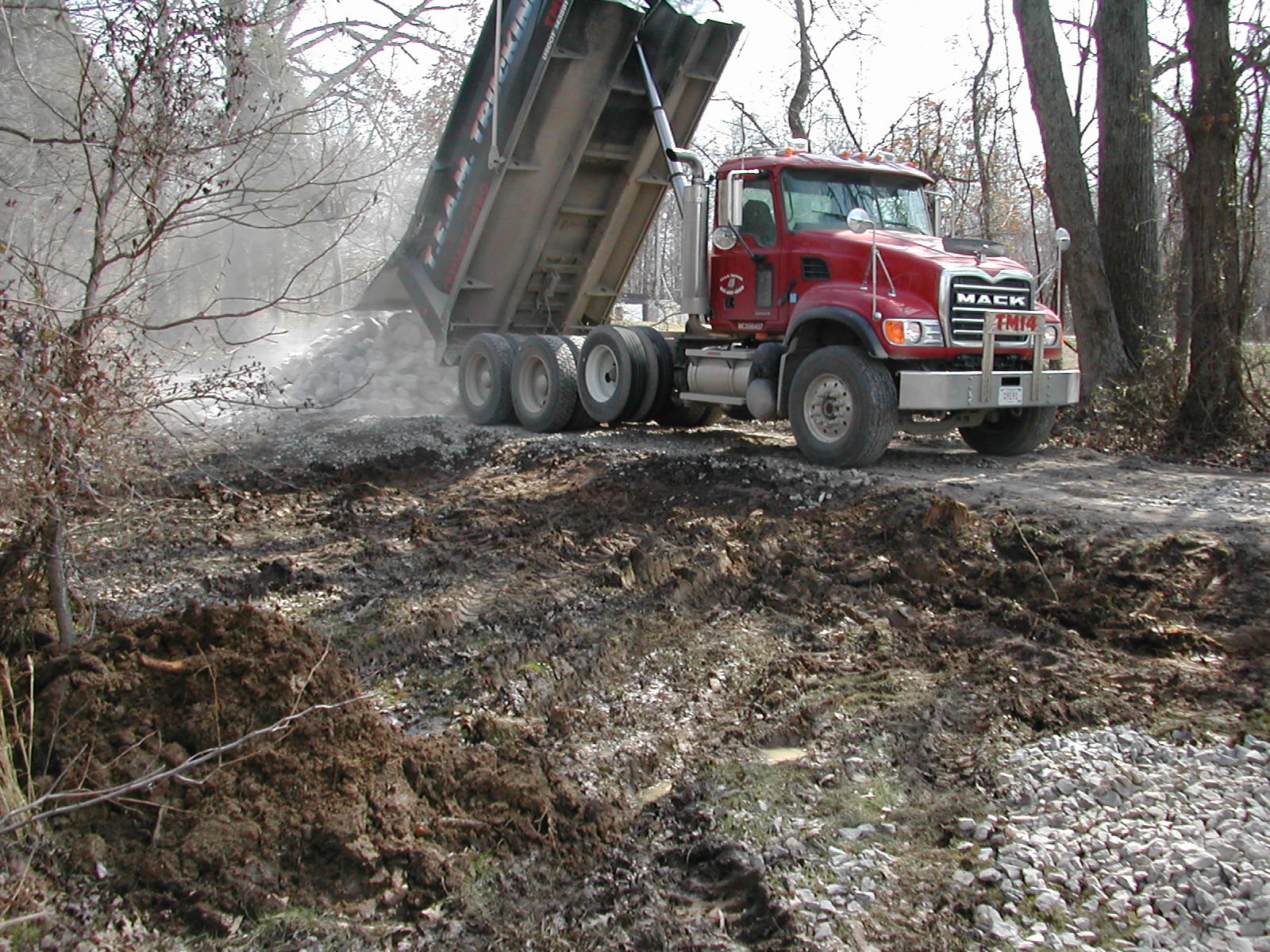

So, first we remove the mucky soil beside the drive.
Then a $315 tri-ax load of rip rap gets dropped, of course right in the drive,,,, as he was not getting into the muck, so me and Babe get to move 23 tons of rip rap into the proper place. Would have been a better place for Bob the bobcat, but he is still at the other place.
So then a $315 Tri-ax load of 2/3 stone come's in to top the rip rap, Babe likes moving 2/3 a lot more then he likes moving Rip Rap. Little box blade action and it is starting to look more like a drive.
We brought out a trailer load (4 tons) of Crusher run, so I dropped that up near where my culvert is going, hopefully today I can pick it up and get it put in place.
