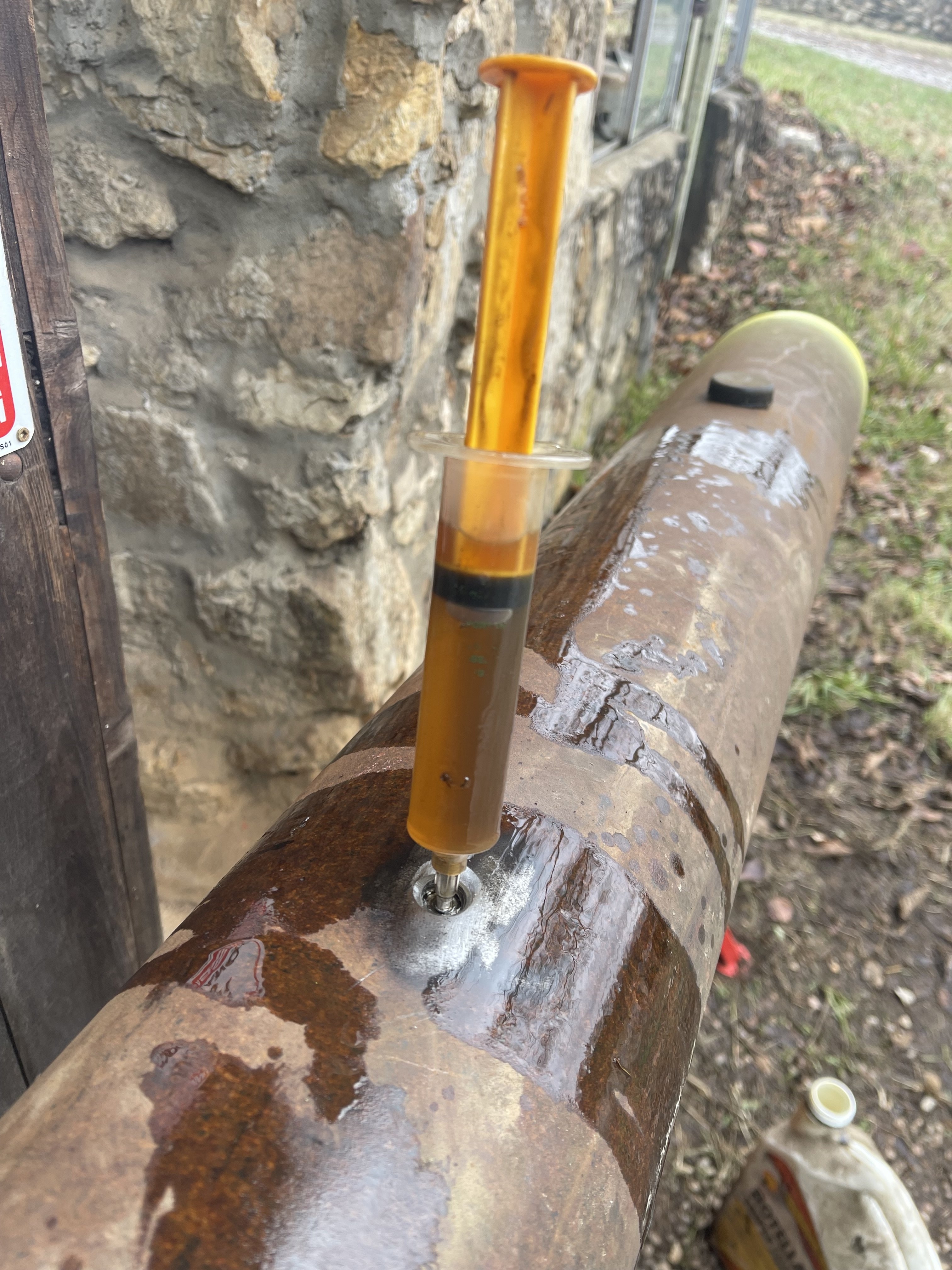

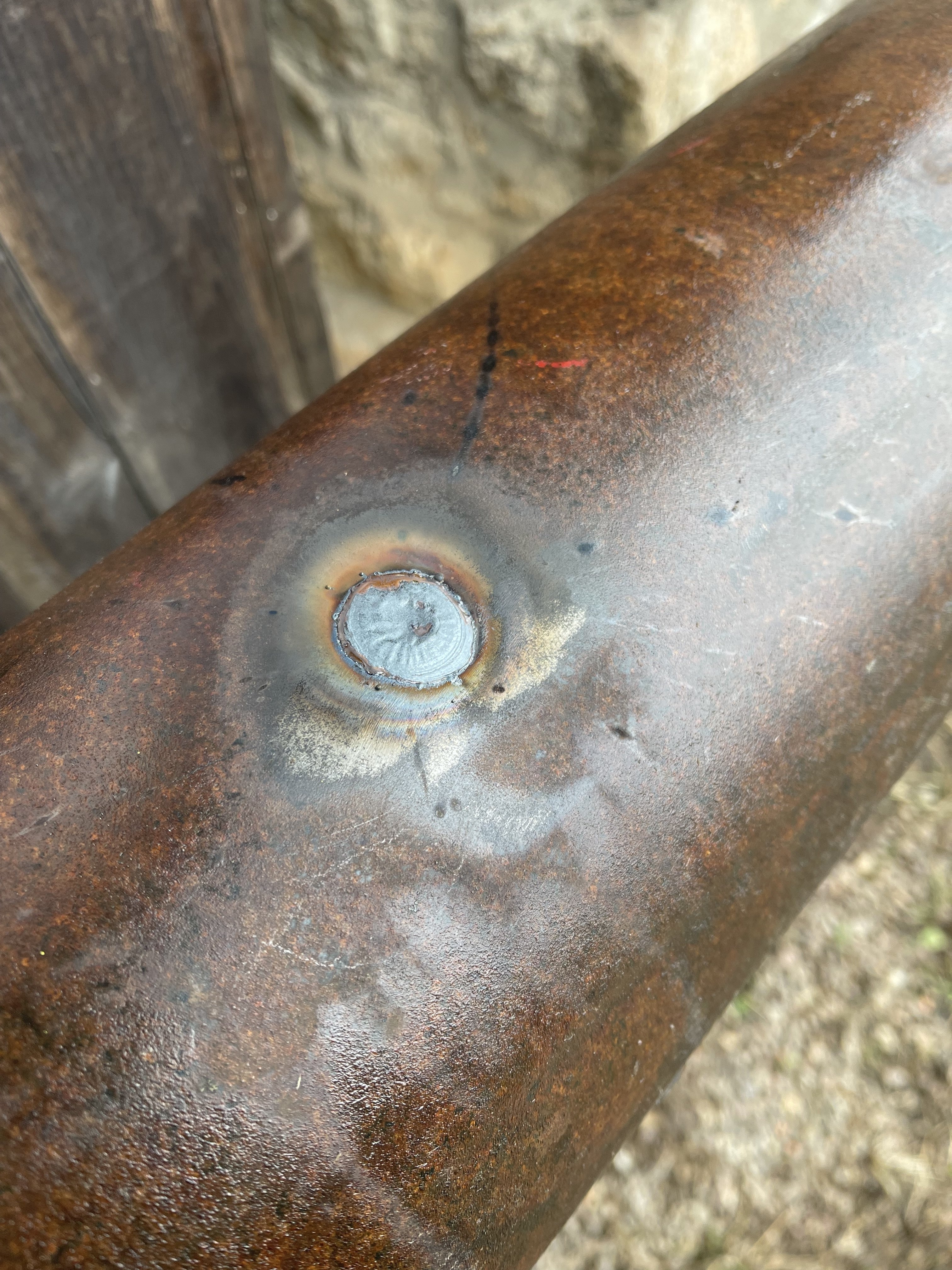

Decided to add four, 1/2” plug welds around the center to further tie the two tubes together. Super heavy duty. Because of the corrosion and nearly 30sqft of internal surface area, injected about a quart of Rotella engine oil into the roller before sealing the last weld. Should be ample to eventually cover all surfaces. Good use of an old turkey injector syringe. Ready reinstall!
