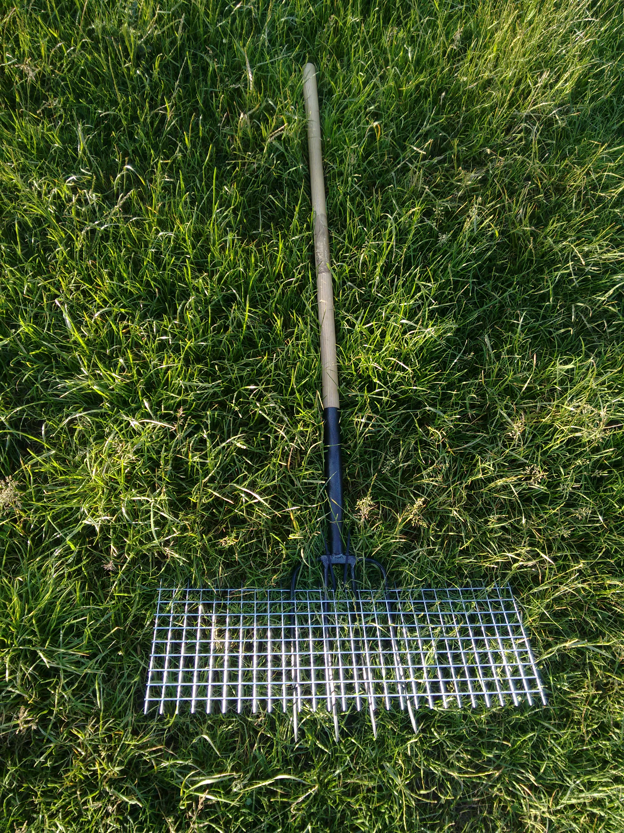

Mk 1 scoop
Next I was thing about making some kind of cage that I could pull over the bottom when I found a few offcuts of 1" weld mesh in my scrap pile. Not enough for a cage, but maybe a simple flat sheet would give the stems enough support to not break. No Muck machine, but I do have a muck fork and with a few zip ties to hold them together, it was time for another paddle.
With this I could push it in front of me, almost level with the bottom of the pond. I only needed to push a few feet to feel the water resistance build up as the plants flattened against the mesh. Lifting it up in the water, I could see not only intact stems, but roots too - it worked ! That evening I spent an hour or possibly more with it, making lots of short passes and each time carrying the uprooted plants to the bankside. I hadn't cleared that much of the pond, but what I had got done was enough to encourage me to try it again on a slightly bigger scale.

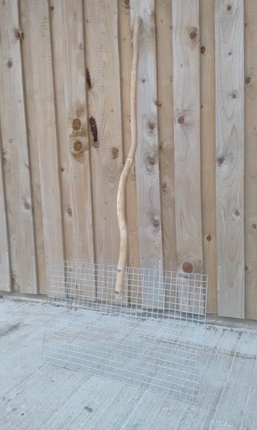

Mk 2 scoop
Next time I cut off the biggest piece of weld mesh I thought I could reasonably manage by hand. I was looking around for a handle when I remembered an ash felled a few months earlier that was still waiting to be cut for firewood. A straight ish length from it did the job, the slight kink making a good hand hold. Bolted together, it made what looked like a huge fly swatter.
It worked superb :dance1: . The best technique seemed to be to wade a few yards into the pond with the scoop above the water, then turn around and come back with it skimming along the bottom. This time I had taken care to grind smooth the edge of the weld mesh, so each time I came back to the bankside, I could thrust the scoop forward, then pull it back and the Crassula would shoot off.
