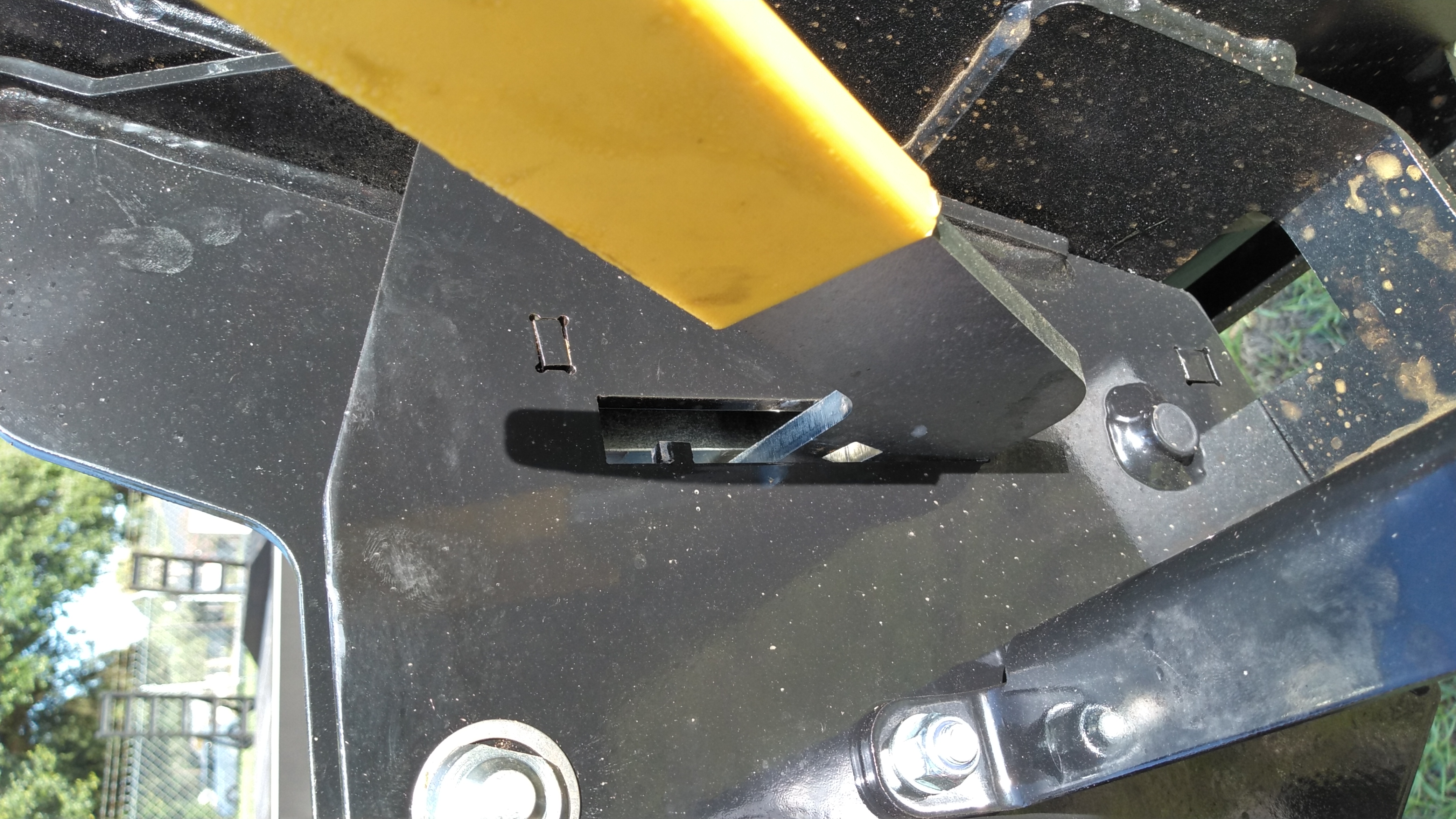

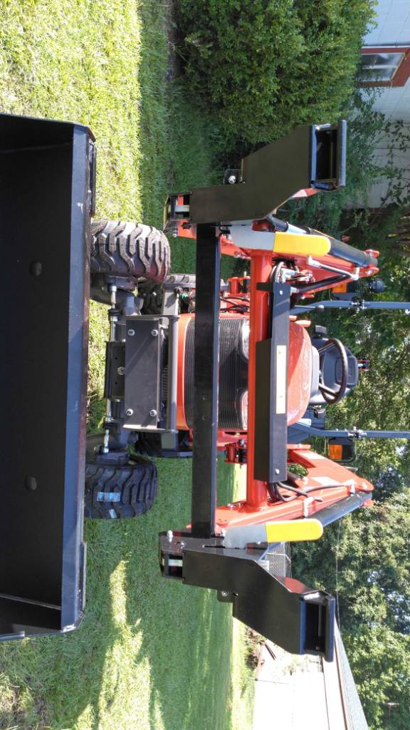

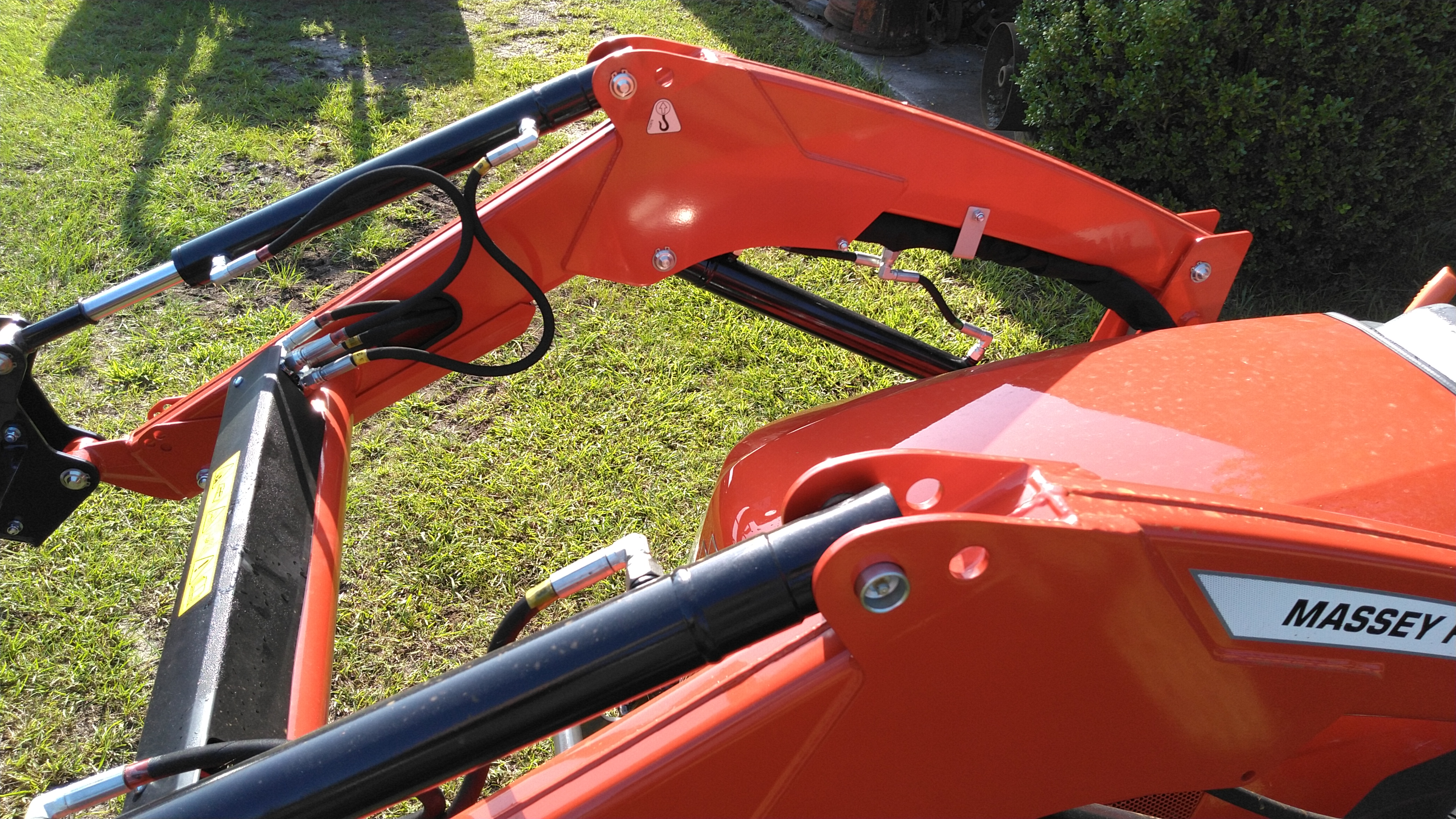

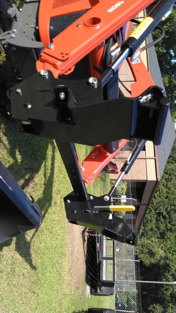

Here's a few pictures of the new FL 1805 Loader with SS Quick Attach offered on the GC tractors.
New lift capacity is 922 Lbs at the pivot pin.View attachment 613254View attachment 613261View attachment 613256View attachment 613255View attachment 613257View attachment 613258View attachment 613259 KIMG0433.JPGView attachment 613260KIMG0432.JPG1563369471294.jpg1563369500683.jpg

Very interesting. Similarities to the DL95 but with better coverage of hydraulic hoses on the cross brace. Did they change loader fabricators to a new company I wonder

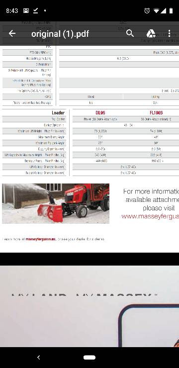

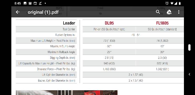

To me, other than 1" lift height gain and standard SSQA the FL1805 looks like a slight downgrade over the DL95Screenshot_20190719-084307.jpg
   / All New FL 1805 Loader For GC1700 Series #6
   / All New FL 1805 Loader For GC1700 Series #7
the FL 1805, from what I can find, is more or less the same with a 3rd function kit.
   / All New FL 1805 Loader For GC1700 Series #8
I think the SSQA is also standard on that loader which might explain the loss of lifting capacity. SSQA and 3rd function is huge though... Both features that would make me think twice about looking into trading my GC1710 for a GC1725M
Same fabricator. Alo.
I like the newer style pins, and the SSQA has some "love bumps" that keep a stick from popping them up and accidentally releasing the bucket/forks etc.
Also, the lower part of the arms have a cast/forged piece that is inserted into the frame and welded into place.
The channel where the upper part of the frame meets the upright supports is taller and more stout.
The hoses are routed better and the gap at the bottom has been filled in so that the frame is "boxed"
These newer loaders are built.
