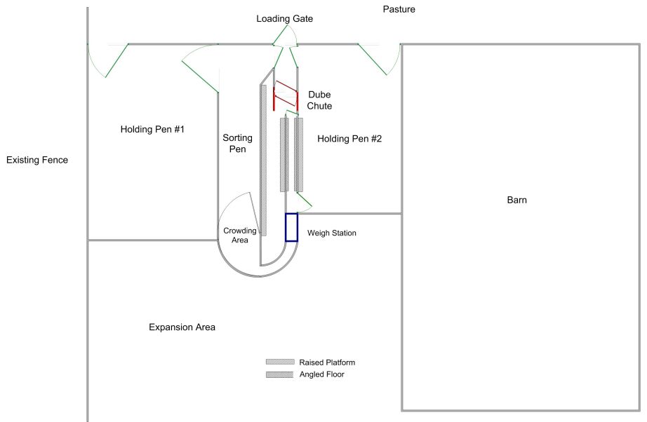

Spiveyman... looked at your pen layout..Lots of good going on there. Suggest, strongly, that you go ahead and make a large pen in the expansion area with a fence from the edge of the barn over to the other fence. Then, make gates from the pens into that big one. Reason is that you don't have enough room to train the animals to come to feed thru the chute.. they need a large area to move into.. this is the expansion pen I'm suggesting. Also, you will need to be able to move stuff out of the pen right next to the chute so you can work on stuff without worrying about your back side....yes, you can get away with working stuff in a chute and have cattle at your back.. but there is always that unique situation when some calf bellers in the chute and its momma just happens to be right behind you in the pen.. swings her horns.. and catches you in the UNAWARES:eek: I know that there is lots of information about raised walk areas around chutes, etc... unless you are dealing with lots of animals a lot of the time, I'm not sure that they are worth the expense... I don't have any.. considered them necessary once, but never got around to building them.. and wouldn't now.
Roger that, It would make sense to go ahead with the larger pens and make sure we can work the cattle without worrying about moma cow making us a kabob. You're probably also right about the raised sections for the number of cattle we're working with. May or may not fool with it. Probably will do the bare minimum to get 'er done right now because we really need to move the cattle. Thanks!

Net... I think you are moving toward a very handy operation.... now, a suggestion. With your designed pen setup firmly in mind, SIMULATE numerous operations and cattle behaviour... do this with somebody who knows cattle... you close your eyes and are the person working the stock. See the pens from ground level in your mind and walk into them as you would working stock. The other person takes the position of one of more head and describes how they are behaving.
Take several scenarios of working cows, calves (100 lbs then 400 lbs), your prize bull, an injured animal. ... take each one all the way from getting the animal/herd into the first pen, sorted as necessary, then thru the chute, worked and then turned out again to pasture. Have your buddy be a docile animal, then a wild one, then a mad one, then a wiley one. Talk it thru in lots of steps.... can you reach the fence and jump up out of the way when need be (if not, maybe adjustments are needed to pen size, where you were standing, something)
How do you get the gates open, shut, where are the tools placed for vaccination, where is the rope for tying up one hoof, where do you keep the nose pliars...and tie it off. What do you do when an animal rears up or attempts to jump out of the pen (are the pens high enough to hold it, or does it escape). Can you work the stock all by yourself, or does it take two or three people to be safe in managing all the gates, etc... Remember, it's easier to lead a cow with a feed bucket into a pen (up to a point) than drive them. Where do you keep the feed, the buckets?
Now, don't break out in too much of a sweat in this simulation... but I bet that it'll expose some things and demonstrate some things that you can adjust to before you build stuff... for example... which way a gate swings and whitch side it latches on makes a difference. As does the latch mechanism... chains or slide bar.. or ?? Each has its benefits or problems in strength or speed/certainty of closing.

That PVC idea is golden. I haven't bought them yet as we haven't started working them, but that is a must for me.
When I laid out the pens I used a program that actually lets me swing the gates open and closed. Doing that kind of like you suggested just with me I already made some changes to my original design, moved gates to different hinge points... etc. I'm sure there are still some bugs in the design, but I'll have to keep working on it to find them. I really appreciate the scenario of the cow/calf deal. That could have bitten us. One thing about Longhorns, they don't seem to mind to jump. Ours are very tall, and athletic. You know, since they aren't carrying around all the extra meat that the Angus animals have. :) So height of the pens is a big deal to us as well as the ability to withstand some "climbing" and not just fall apart. However, I am sincerely hoping that by using the techniques you mentioned in the other thread of conditioning to think "food is at the end of this maze" we will avoid some of that behavior. I want them calm and comfy as can be in there. One good thing though, is that this whole thing is still enclosed all around. Worst case a bull goes nuts and busts out, he'll wind up in a fenced in pasture which hopefully will allow the animal to calm down. We won't have to run down the road after the thing.
Very good point about the location of the grain. Should we enclose an area to hold a barrel with grain in it? Also the exit strategy - that is one thing we've thought about, making sure we can get out if we need to in a hurry. I don't mind the sweat factor of thinking through this. I'd rather do it now than when we've got a big bull in the alley.

Texasjohn, I really appreciate the input here. I've taken your suggestions and made some changes. (See file below) I agree, a few more posts and the 3rd holding pen is done, and that could make a big difference in the whole operation. I hadn't thought about our backs being open from holding pen #2. I think this also gives us enough circular paths to be able to double back around like you mentioned and close the entrance gate.
I also noted a "safe zone" where the cattle will not have access. This is where we could set up a table with meds and stuff like that and not have to worry about it getting turned over except by the ranch clutz (that's me). I added a gate at the top of the safe zone into the sorting pen. While the animal is squeezed up most of the gates at the top could be open allowing for easy access all around the Dube chute. That safe zone would also be a place for the grain as it is "interior" so any smells would lead the cattle in, not stop them at the entrance gate, but it's also easily accessible for those with opposable thumbs.
Incidentally I'm considering the gate into holding pen #1 as the entrance gate, it's in a corner which should help prevent animals from missing the gate.
I took out the raised platforms, we can always build them if we want. What about angled sides in the alley way? This is to keep the animals from trying to turn around in there. I've seen this on many systems. Is it worth it?

Yep, your holding pen 3 makes a big difference
It looks like you can move stock from the sorting pen out thru the loading gate to pasture.. I'd make sure that the gates latch such that this can happen.
Also, looks like stock can move from holding pen 2 past dube chute and into sorting pen... good if true, if not, this should be done.
Safe zone is good... a place for supplies, etc... only problem is that it is difficult to get into... maybe I just don't understand how it works.. looks like the only entrance is from sorting pen or holding pen 2 via dube chute.
Gate into holding pen 3 from pasture looks larger than the others.. good.. I think you will want to be able to get a vehicle into that pen for numerous reasons over time.
Angled alleyway sides?? Well, mine aren't angled and things work. However, the sides of my chute leading to the squeeze are movable, so if I am working only one size of animals, then the entire chute width can be adjusted. The reality is, however, I almost never make this adjustment because one minute I am running 2000 lb herd bull thru, then 1400 lb cows, then 900 lb heifers, then 400 lb calves, then 100 lb calves. The angled sides are an assist, my opinion, when working stock of various sizes... narrower at bottom constrains calves better. what is critical is that the lower sides be solid... not a pretty sight to have an animal with leg sticking thru the side of the chute/crowding area. If you don't yet have a small hot shot, get one... never use it EXCEPT when all else has failed and you have an animal that is down in a chute and won't exert the effort to get up.. sometimes this is the only way.
I now understand how you are going to get the volume needed... you are not really a cow/calf operation, but a feeder operation. As such, you will ALWAYS have animals that do not have the disposition you really want. As such, MAGGIE is your most important animal on the place, more so than the bull, even. This is because, as you said, you can teach her tricks... AND, YOU WILL.... Even if she skips a calf, she is GOLD to you... put her in with every new batch of animals that you get and let her teach them the pathways thru and around your place... she does your bidding and will calm the others into doing it as well. Then, when a bunch of the new stuff is settled down and following you/her well, you can separate her again and keep patterning the new stock. Pray for another MAGGIE in your herd... often we only have one such cow in our cowboy lifetime. I've had one such cow. I swear I could tell her, "now go back into the pasture and get those 3 jumpy heifers and lead them back into the pen.. but it's OK to leave the other 2 cows and bull".... AND SHE WOULD DO IT!
This process should result in you determining which animals will fit your program and which will NOT fit.. for disposition or other reasons. Those that do NOT fit should be removed IMMEDIATELY... they will teach the others bad habits, make them sick, whatever.. and you don't have enough total space/pastures to put up with bence busters, stuff that runs the other way, bully animals that will bruise stuff in the lot, etc... you will have to determine your own disposition criteria, but this is worth serious and critical thought. It is oh-so-tempting to keep that problem animal because it is "so good." So, define good now as something you can work easily or train to work in your situation in a reasonable period of time. If it flunks your criteria/timeframe, then off it goes (assuming you can even get it into the pen to get rid of.
You are also going to need a good vet/shot/health program... bringing in stuff all the time will result in illnesses you would not otherwise see.. so, be ready... I assume you have a sick trap for such animals near the pens so you can daily administer shots, clean wounds, etc.? Do you have electricity running to the chute area? I know you are not dehorning, etc.... but it's good to have, anyway. Also, lights around the pens... no fun to try to work stock in the total dark.. and there are times when you MUST do it.
So, how many pens have water in them? You need it in at least 2 if not all 3 holding pens.

Spivey I agree with TexasJ with respect to your corral setup - pen 3 is a good add. I've been puzzled about the "safe" area as well. I'd suggest a series of gates inside it as individual holding pens. Sometimes you want a place to put sick animals or maybe a horse or something. A series of gates in there could make some small pens. Other wise I'd be lamenting the nonuse of that space as well. It would affect having walking ramps on both sides of your delivery system to the dube for using pour-ons and such but just having one side is OK.

I'm not sure you need to do anything special in terms of a floor. Pretty costly to do much but if you feel you must I'd probably do grooved (for drainage) concrete - easy to wash. But the reality is why do anything it's not likely to be used that much - is it? The reason I say that is because you calve year around and so different cows will be on different schedules (for example you probably can't vaccinate or treat for parasites every cow or calf for the same thing at the same time because of differences in gestation/milking - for example no modified live vaccines on small calves is common) plus your numbers aren't very high and so the impact to the system will be minimal at any one time.
Note also that when I said multiple pens in the "safe" area you should consider gates out into the crowding area as well as a sequence of gates.
One thing I will say - how much of a system do you really need? How big do you expect your numbers to ever get? I would build a system carefully considering these things. An old cowboy told me once you should only build one set of corrals in your entire life otherwise you've done something wrong.

What I dubbed the "safe zone" meant that there was no cattle access to that area. That's where we can store meds and such without having to worry about them messing it up. Also, it's an area we could potentially be in with the PVC pipes to cut, direct, motivate... etc cattle without having to be in the crowding area or alley. That was the point of the raised sections, to be able to direct from up there if we wanted. I visited a well known Longhorn man in Ohio who had a set up like that. You could walk the elevated area and cut the cattle without being down in there.
Good points about not getting high volume usage in the corral, but USUALLY we get decent rain around here and it's likely to be wet. One time through the wet marshy ground with the herd and the grass will be a mud pit. I think we just want to avoid that. Not sure we want the expense or permanence of concrete. We were hoping smaller gravel might work OK.
As for how much of a system we really need, well we plan to grow the business, so hopefully our ~50 head will be much more than that soon. :) But in the mean time, even if we only ever have that many we want a good system to use. Like texasjohn pointed out, one that can be operated by one person if need be. One well thought out that we don't kick ourselves over something stupid - we also only want to build it once. And we want it to be safe for us as much as possible. Oh, and one more thing, this is America!!!! When's just enough ever been sufficient? :D

The safe area as drawn appears to be pretty big. Thats why I suggested maybe some pens. Part of it near the dube could still be a small shed or overhang for supplies. A gravel base would work OK and help with drainage I suppose - just don't know how bad you need it. Concrete is expensive no doubt. Corrals should be sited on ground that drains fairly well anyway. If it's that muddy you can always work cattle the next day. :D

The site where we are building this system drains as well as any other stretch of clay filled soil in KY. :) We'll probably at least put down some gravel, just in case. Another option initially was to move he working section closer to the barn and build a lean-to over it. That way we could have lights and a roof to take the weather and time of day out of the equation. However, the overall system didn't seem as flexible.
