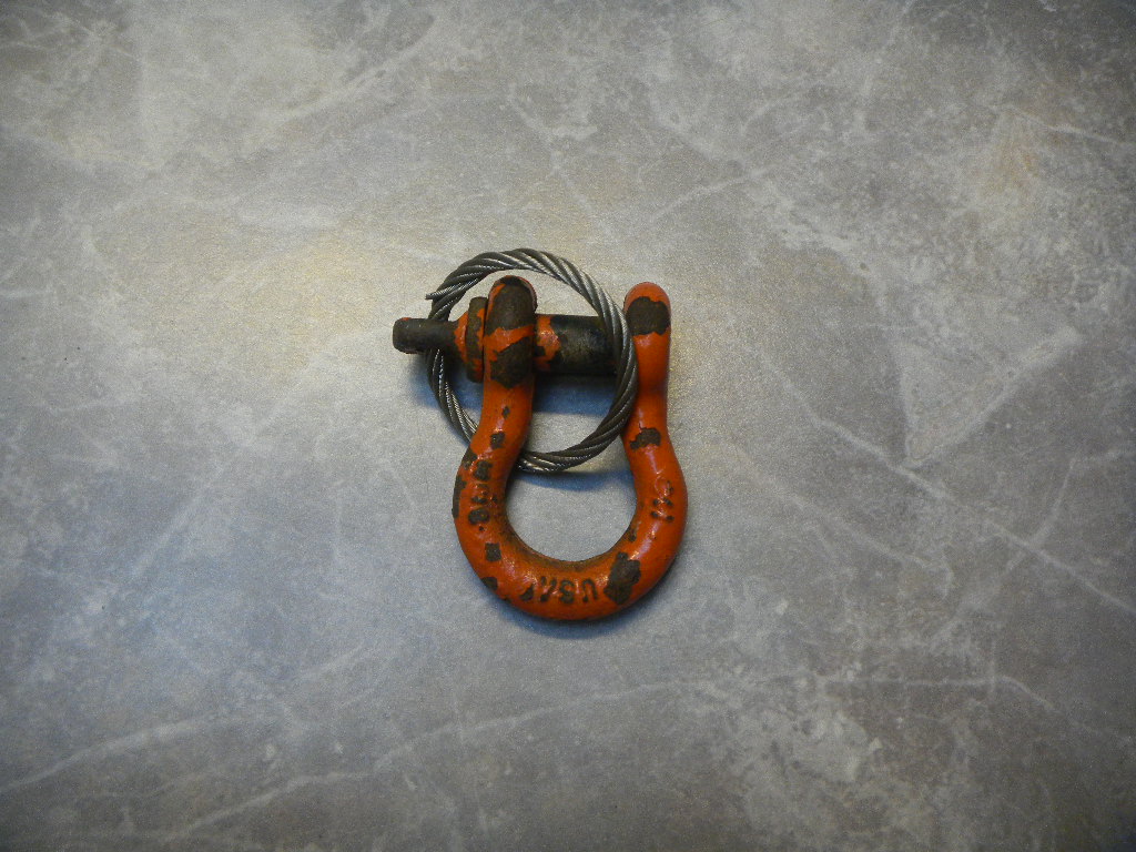

Just a suggestion, I have way more experience with rigging than I do with welding. If you plan on leaving that shackle there? Take some tie wire and mouse the pin to the bail of the shackle. Run the tie wire through the hole in the pin, wrap it around the bail of the shackle, and wrap the ends of the tie wire together a few times. Anytime you are going to leave a shackle in the same place for very long periods of time. You can cut about 4 to 6 feet of small wire rope, unwrap 1-strand, place one end of this strand through the hole in the pin, and around the bail of the shackle, and form a circle with the strand. Inter wrap the strand, when done it will look like an endless cable.
If the object of mousing the pin is just to keep it from unscrewing with vibrations, it is easier to just put a zip tie through the pin hole and around the shackle bail. Wouldn't do that for an anchor, mooring or serious overhead lifting but for general purposes it would be fine. I keep a handful of the smaller zip ties in my tractor tool box.
   / All your welding tips and advice paid off #10
Zip ties will certainly work. Tie wire is so common for me. My wife has a girl friend who is a rod buster, when ever she stops by I beat her out of a roll or two.:D
Here is what I was saying about using a strand of wire rope. I'm not use to working with shackles this small. The second picture is more of what I worked with.
