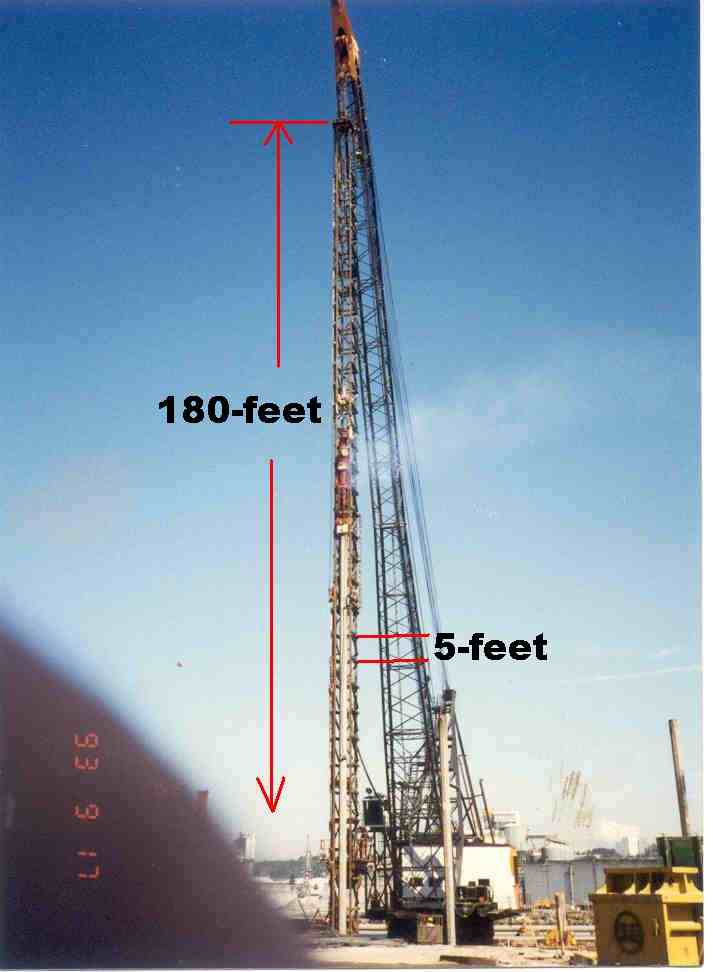

You only use the wire rope strand if you want the shackle to stay in place on a semi permanent basis. We would do this in the boom tip of cranes. Sometimes we would run out of tail holds in the boom tip, we would cut one eye off a chocker run that end over a sheave not being used, place a wedge socket on the cut off end. And use a shackle to marry the two wedge sockets, and the eye of the choker together. Now in a situation like this you do not want to trust tie wire or a zip tie! ;)

In my case the things I dealt with the problem with tie wire and zip ties, another wire rope could rub against the tie wire or zip ties and cut them. When you have this amount of things hanging from the boom tip for months or over a year with out ever coming down you can't run that risk! ;)
