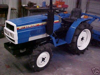

Looks like a Mitsubishi to me too. Check out the photo attached . Look at the sheet metal. Look at the "grill". Look at the horizontal slots at the rear of the hood. Imagine this in red. Something ain't right with this being a "new" tractor. The shifter configuration looks very similar to the Mitsu 372 I own.

Here is my theory. A few years ago I saw what I thought was a new Mitsubishi at the National Farm Machinary Show in Louisville KY. The vender explained to me that it was built by a company in India. I don't remember the name but it was not Mahindra. He explained that this company had bought the tooling from Mitsubishi and they were building tractors using that tooling. The tractor I saw was kind of a tan color and not red. The tractor I saw had the quality control of the Chinese tractors. /forums/images/graemlins/frown.gif There are a couple things I noticed about the tractor in the pictures. There is a folding ROPS. That is not standard equipment for a grey Mitsubishi of that vintage. Also I noticed what appeared to be an air filter mounted outside of the hood. Mitsubishis of that size and year model have always had them mounted under the hood.

My circa 1991 "Case 235", built by Mitsubishi, has a folding ROPS. The tranny and controls look very similar. The fenders are nearly the same, but the grill is very different.
Maybe it is new, with retro styling. Yea, that's it.

Pic Posted By Alvanko Pg.2 is the actual picture of a tractor I purchased out of Texas on ebay. It is a Mitsubishi Grey Market MT1601D. They had repainted the tractor and it came with a 4' Tiller, Iv'e been using it for bout 10 years now. It is the same tractor just a little differant design. The Origianl Img. Could be a Case 234. 235, 236. Case tractors had the ROPS which was the law for any tractors sold in the US, Mitsubishi had built these models for case. The pic posted by alvanko has a 3 speed PTO which is nice. It will really dig the dirt, That is pretty much what they designed them for tilling rice fields. This came with Rice Tires Which are twice as aggressive as AG tires. I beleave you can still order these tires for a reasonable price from Millersberg Tire in Millersberg Ohio. I have all new tires on this tractor now and only cost me 500 total.
