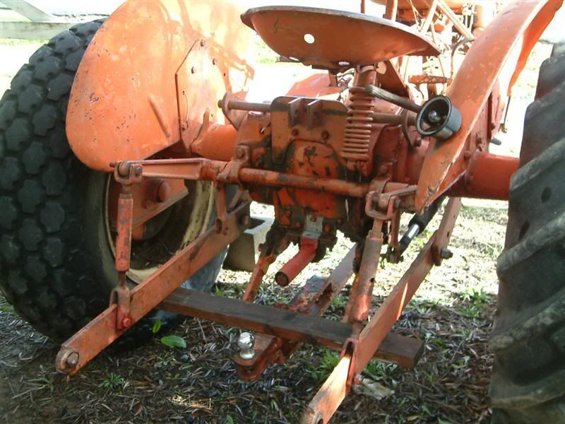

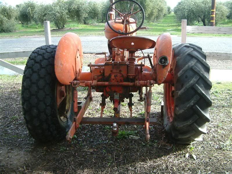

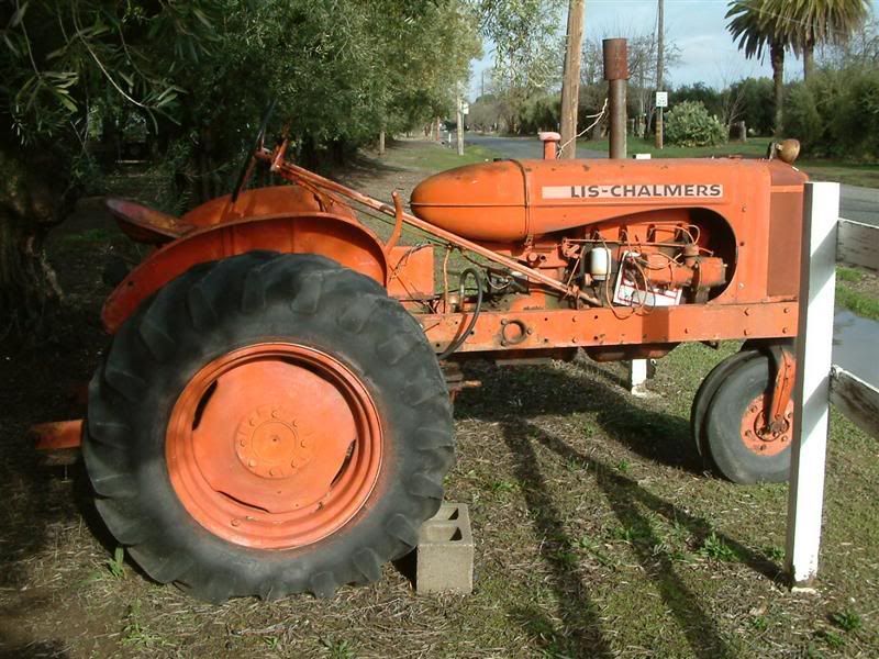

Well I shot a few photos of that AC. Misread the For Sale sign. It's a 1954 model, not 1934. Talked to the owner. He thinks it's a 1954 WC, last run about 4 years ago. But the WC went out of production in 1948. If it truely is a 1954 model, then it's likely a WD-45 (be still my beating heart).
Looked all over for an ID tag, but no luck. Any suggestions here are welcomed with thanks.
It's a tricycle tractor.
Here's a shot showing the 3pt and the external hydraulic cylinder. The owner said he thinks it was an option or aftermarket item added by a previous owner.
Tires are marginal. There's an rear ag tire to replace the turf tire.
Looks like it would need a fairly lengthy restoration effort.

Flusher, that is a WD pictured and it has the origional WD lift with a homemade 3PH added. The serial no. is on the rear differential at the left brake opening. It will say WD xxxx or WD-45xxxx if it were a WD 45. All the 45s I've ever seen had the curved gearstick and I believe the 45s had a cover on the side of the block at the lifters. I can't see one in the pics, and it looks to have the strait gearstick so that would make it a WD. Don't be confused the WD is a great tractor, most folks around here pulled a 3-14" plow with a WD and they were a bullet proof tractor, and the hand clutch gave it live hydraulics and live PTO. A WD will pull a 6' bushhog easy and a 8' disc.
Scott, I wish I wanted to restore and keep one for myself, then I would make one as nice or nearlly as nice as your super A. From redoing yours you know that you can't restore one and make it cost effective to resell.
A super A is a 2 plow tractor and a AC- B is a one plow tractor, but the super A is a 123 CI engine and the AC-B is 125, but the fact that the B is only a 3 sp trans means the super A will pull more. Enough tractor trivia Later, Nat
Later, Nat
Thanks for the info. I'll try to find the serial number tomorrow. Is this number printed on a metal tag, or is it cast into the rear differential casting?

stamped into the rear housing near where the brake adjustment is made.Later, Nat
