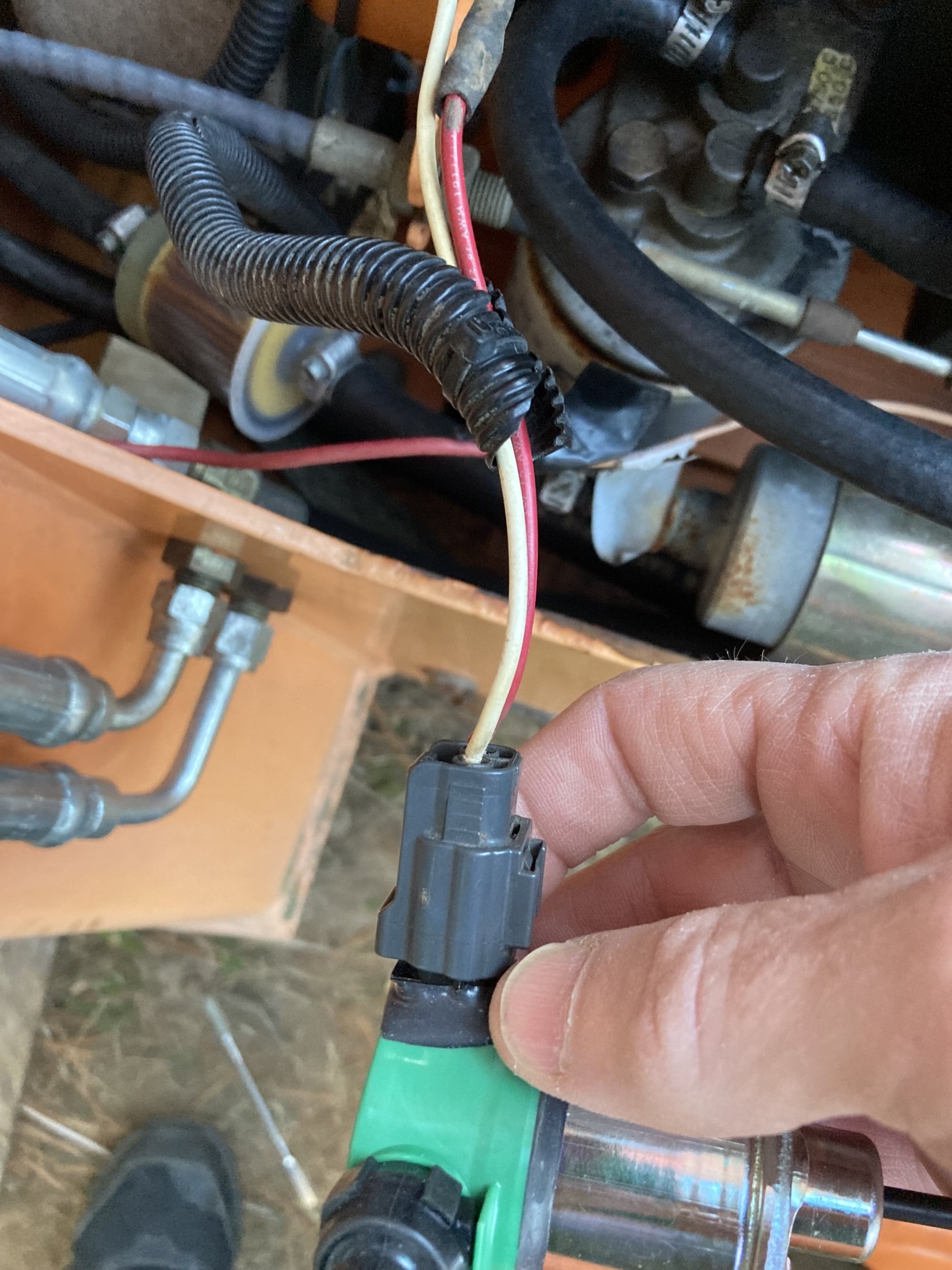

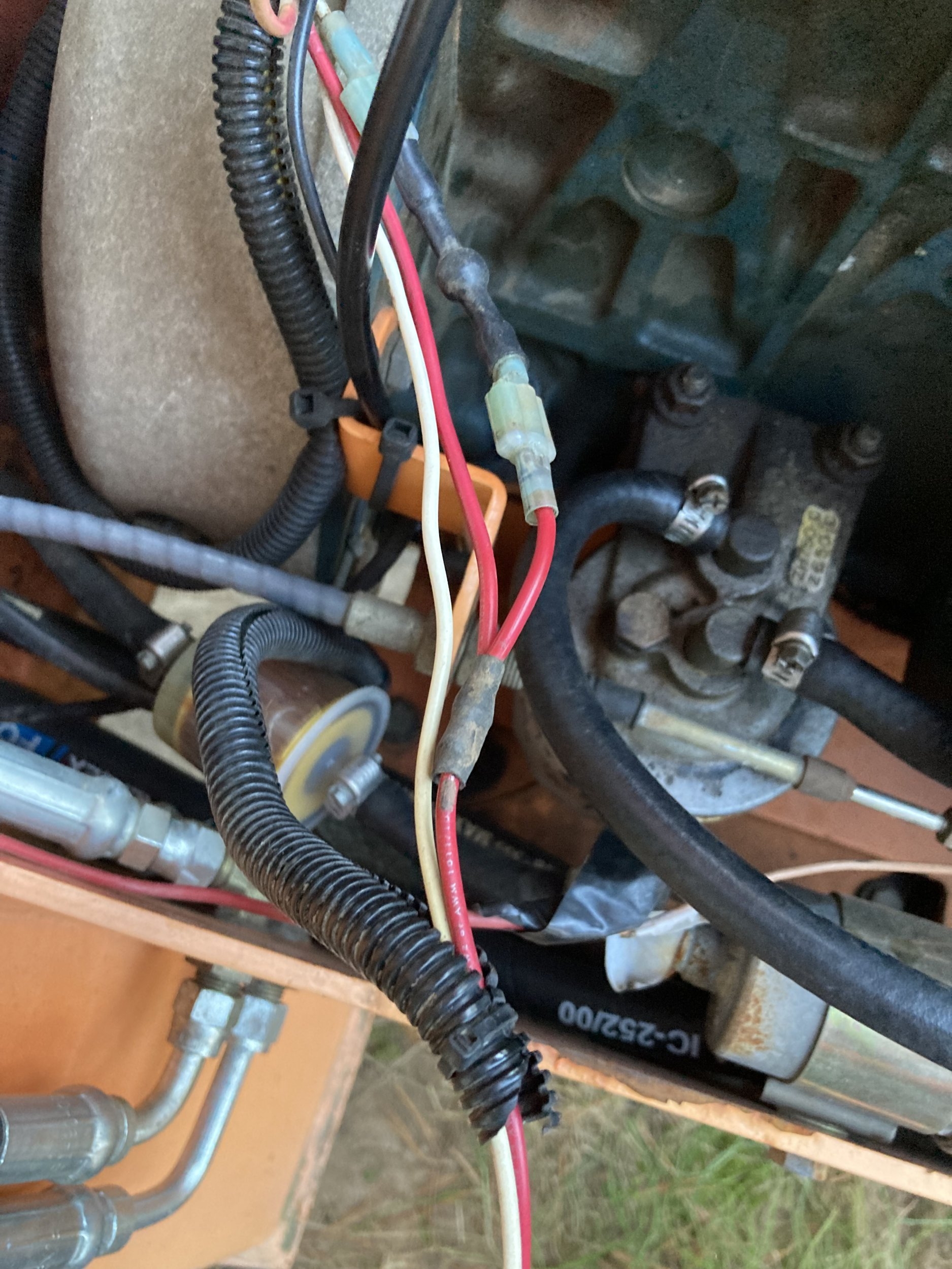

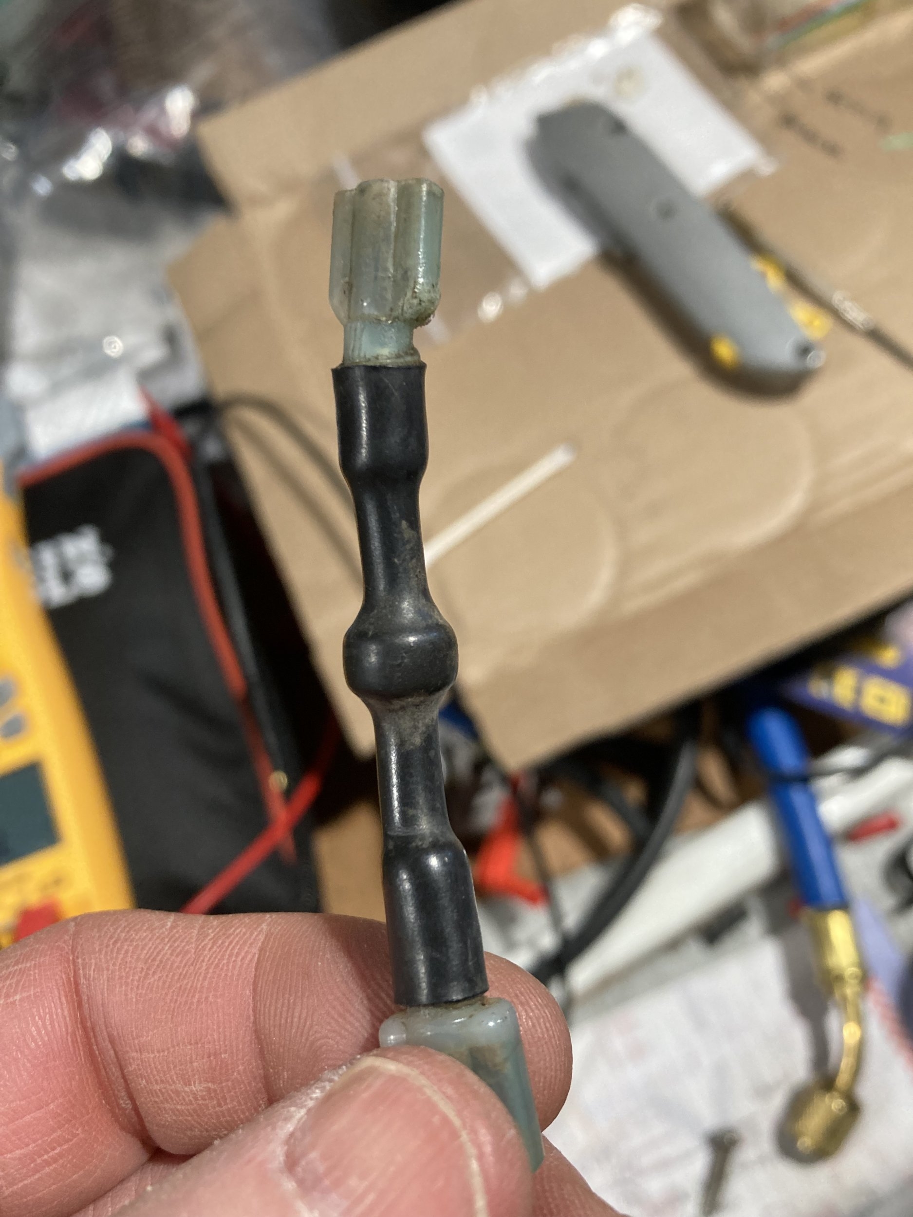

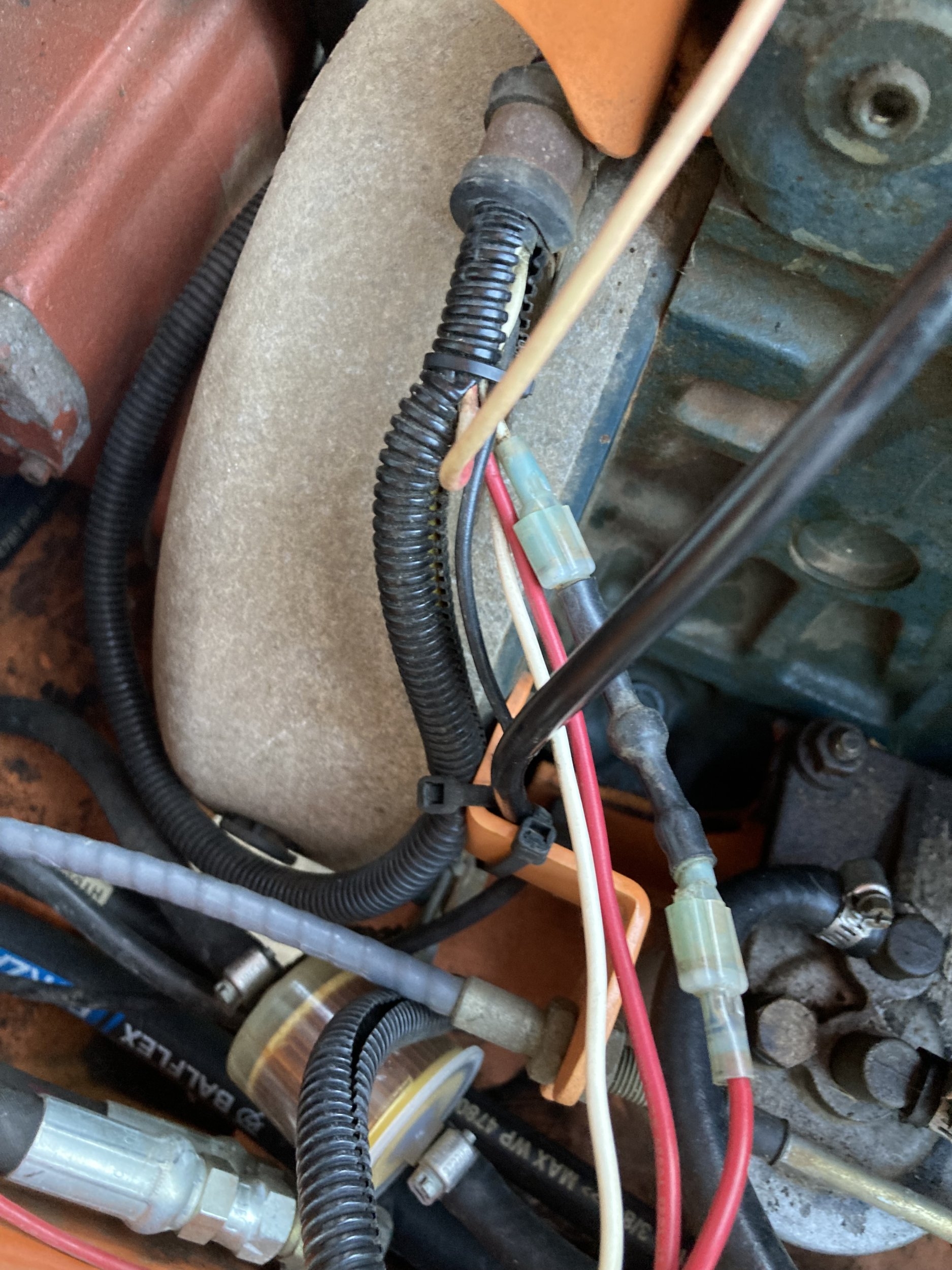

Hello, I’ve had some starting issue, and long story short I have a new stop solenoid but didn’t need one. Had a connection that when I cleaned it, the solenoid hold circuit worked. I’ve included some pictures because my actual wiring and the diagram do not match.
I cleaned the terminals attaching this short black colored wire but have no clue what it his our why its there. It’s not in the wiring diagram.
I also changed all the hoses after one ruptured. I’m also going to be rebuilding one cylinder. The dipper on the backhoe.
I appreciate any assistance.
From the pictures, the red wire going to the solenoid is the hold circuit, and the white wire is the pull in circuit. My machines wiring is different from the diagram and does not mention the short black wire. I dont know what is in the heat sharing tubing that is the bulge in the middle of it.
Thanks ,
Andrew
