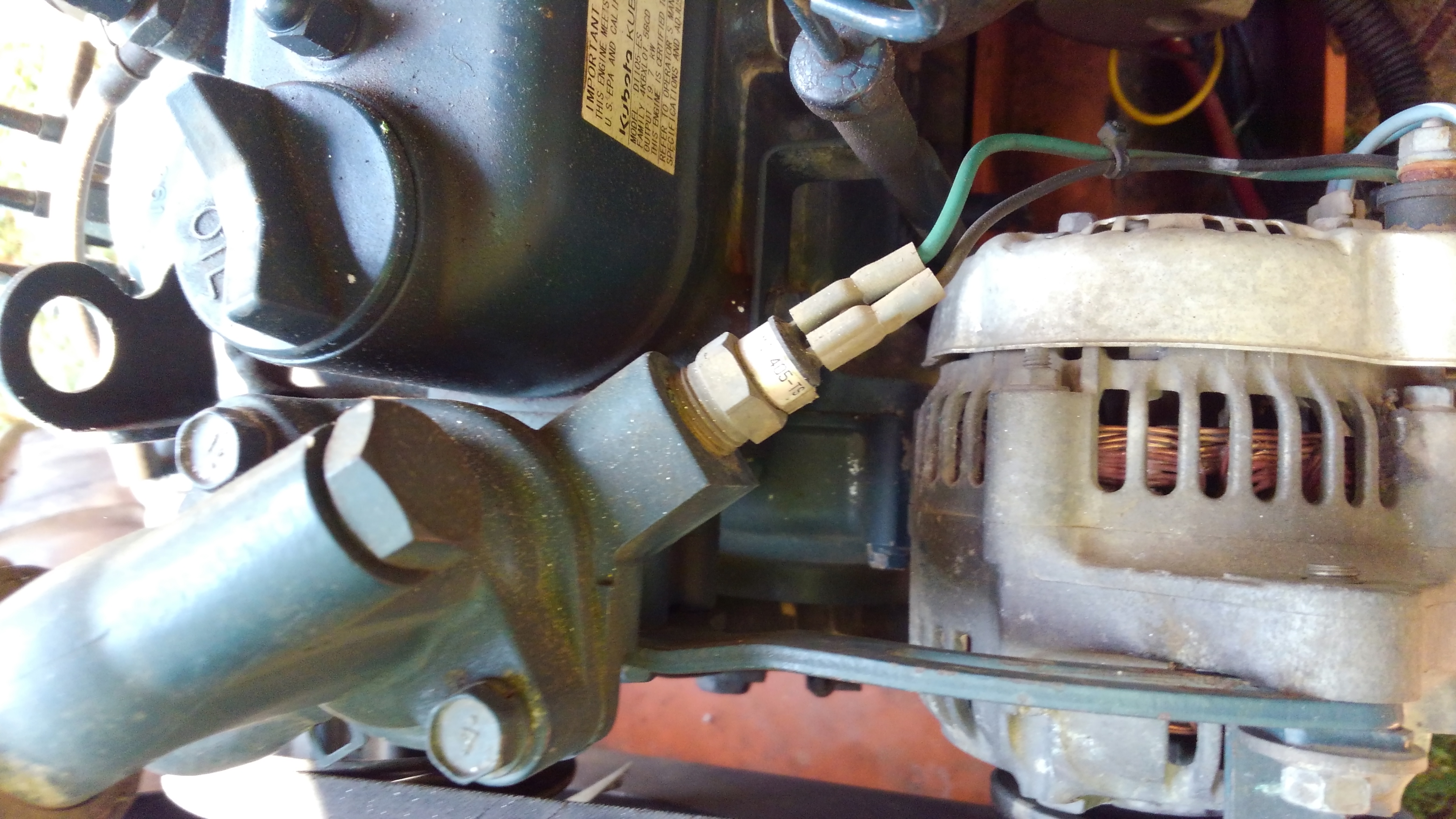

Greetings,
My first question on the forum...
I bought a used Allmand 425 with about 470 hours. It stalls out after about 15-20 minutes of use. It restarts okay but runs just a few minutes more before stalling again. It came with almost all the hydraulic hoses replaced as well as most of the connectors. I replaced the console gauge and ignition switch since neither of these worked properly. Now the temp gauge is lighting up after a few minutes of use. I've changed the oil and the oil filters; the manifold, the gas filter, and the hydraulic filters. The radiator is full and the overflow has a steady 3/4 inch of liquid in it whenever I check it.
I'm only digging into a hillside with the backhoe and hauling the dirt about 100 feet.
Thoughts on things to check next? I'm thinking I should do a radiator flush and fill.
Thanks in advance
William

Have you tryed to see through the rad? Many people work in dusty dirty environments and forget to clean the fins on the radiator.

Thanks for the quick response. The fins didn't have anything caked on or anything like that but I did hose them out with a garden hose. Some dirt and debris fell out which is good. BTW there are two sets of fins; one for the radiator and one for the hydraulics.
I don't know which the temp gauge is for (radiator or hydraulics). However, after letting everything dry out for a half a day at 80+ degrees, I started up the TLB and let it idle for a few minutes. No lights came on. As soon as I lifted the bucket (empty), the temp light came on. After I lowered the bucket into a resting position on the ground, the light flickered on and off as I let it continue to idle. I let it idle for about 5 minutes but it never went completely out.
FYI, I am new to the TLB ownership world and especially diesel engines and hydraulics.
Thoughts?
William

There is a couple of things that might be a cause of overheating. A sticking thermostat in the closed or almost closed position would be my first thought. I would start by replacing that. Then after replacing the thermostat if it still shows to be overheating, replace your temperature sensing element as it might be defective. Both are fairly cheap replacement items.
Lastly a very remote possibility is that the water pump fins may be worn out(rusted away because owner didn't use anti-freeze, just plain water). I have seen this happen but not a very likely case with only 470 hours on the engine.
As for the engine stalling out, could be a stopped up fuel filter, algae in the tank or lines, bad fuel pump, bad injectors, bad fuel cutoff solenoid, many other items.

is there a temp guage. there is a hydraulic temp idiot light for that machine, is that what is lighting up or is it the coolant temp idiot light.ive had sending units go bad on trucks ive owned. if tere isn't a coolant temp guage, go buy one. if the coolant is really overheating try pulling out the thermostat

Thanks. I replaced the fuel filter already and haven't had it stall out since but that may because I have been turning the machine off after my temp light comes on (I replaced the console gauge with the temp light at the same time as the fuel filter).
I'll start with the thermostat and sensing element and see where that leads me.
